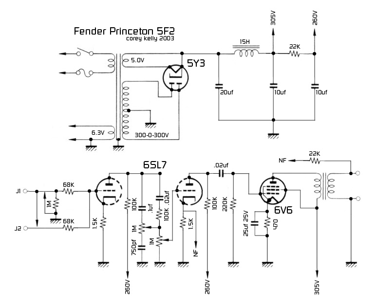

Here is a simple Schematic of a Fender Princeton. What you could do is buy a bigger output transformer (3K primary) and power transformer and replace the 6V6 with a EL34 and get around 10 - 12 watts out. That is what I plan on going if I ever get around to building it.

Gavin: Hey! Thing is, when you say "buy a bigger output transformer (3K primary)", do you mean a 3kW? And what's the original Wattage of this Fender Princeton? Also, where could I get extra info on it, like the Bill of Materials?

What I mean is that a EL34 needs a plate load of 3K to get the optimum performance out of the tube. A 6V6 uses a 5K primary impedance. Here is a link to the output transformer I was going to use.
http://www.allenamps.com/parts.php#transformers
Look at the TO11C transformer. With this transformer and a little higher voltage on the output stage you can have a screaming little 12 watt amplifier. If you decide to go with this simple circuit I will try to post some schematics with the revised values.

The Princeton is around 3-5W. Do some blackle search on it, and you'll find more! The bill of materials depends on the parts you will use. Transformers, tubes, caps, sockets, chassis, pots, e.t.c.

Somewhere on the net is a chart that compares wattages to decibles.
It says that a 5 watt amp is only 1/2 as loud as a 50 watt amp into the same given speaker and cabinet.
Having built several 5 watters and a few 10-30w PP amps, I would definatly have to say start out with a 5 watt. Its simple, they run on low voltages (as compared to a 50 watt amp, you only have 250-350v with a 5 watt and over 400v with a 50 watt!
) and their layouts allow you to learn how the components work and why certain things must go next to each other, or why your power transformer should be located away from your input tube etc etc.
I started out with help on this forum and from ax84, I highly reccomend ax84's website. Build the P1 , or if you really love vintage marshall tone it is very hard to beat their High Octane amp. If you build the high octane or the P1, there is a quicky intro to tubes and how they work and how to use them. I bit the bullet and built the HO as my first 'real' tube project and am glad I did. While it is a bit more complicated than a P1 or a champ, it sounds incredible and is IMO, far more versatile for rock. For blues I plug into my little champ clone and crank it to 10.
The nice thing about 5-ish watt tube amps is that they are about as loud as a 10-15 watt SS amp (depending on the speaker you use) and allow you to crank them up to get that good ol' tube distortion at levels that wont necissarily ruin your ears. ( or the neighbors either- just don't do it at 1 in the morning though!)
Here are some links for ya to gander at!
http://www.ax84.com/index.php/legacyprojects.html?pg=legacyprojects&project_id=hioctane
Schematic:
http://ax84.com/media/ax84_m314.pdf
Build guide/theory crash cource:
http://ax84.com/media/ax84_m322.pdf
Hope this helps!
Be careful, you might get hooked!😉

Check out the musical instruments forum. We've been talking about Fender Champ clones. My son and I built one and he loves it.
I *measured* 3.4 watts and it is plenty loud for the music room. Plus the little guy can carry it to a friends house.
I sourced most of the parts from an old tube radio and used a Squire SS amp for a cab.
