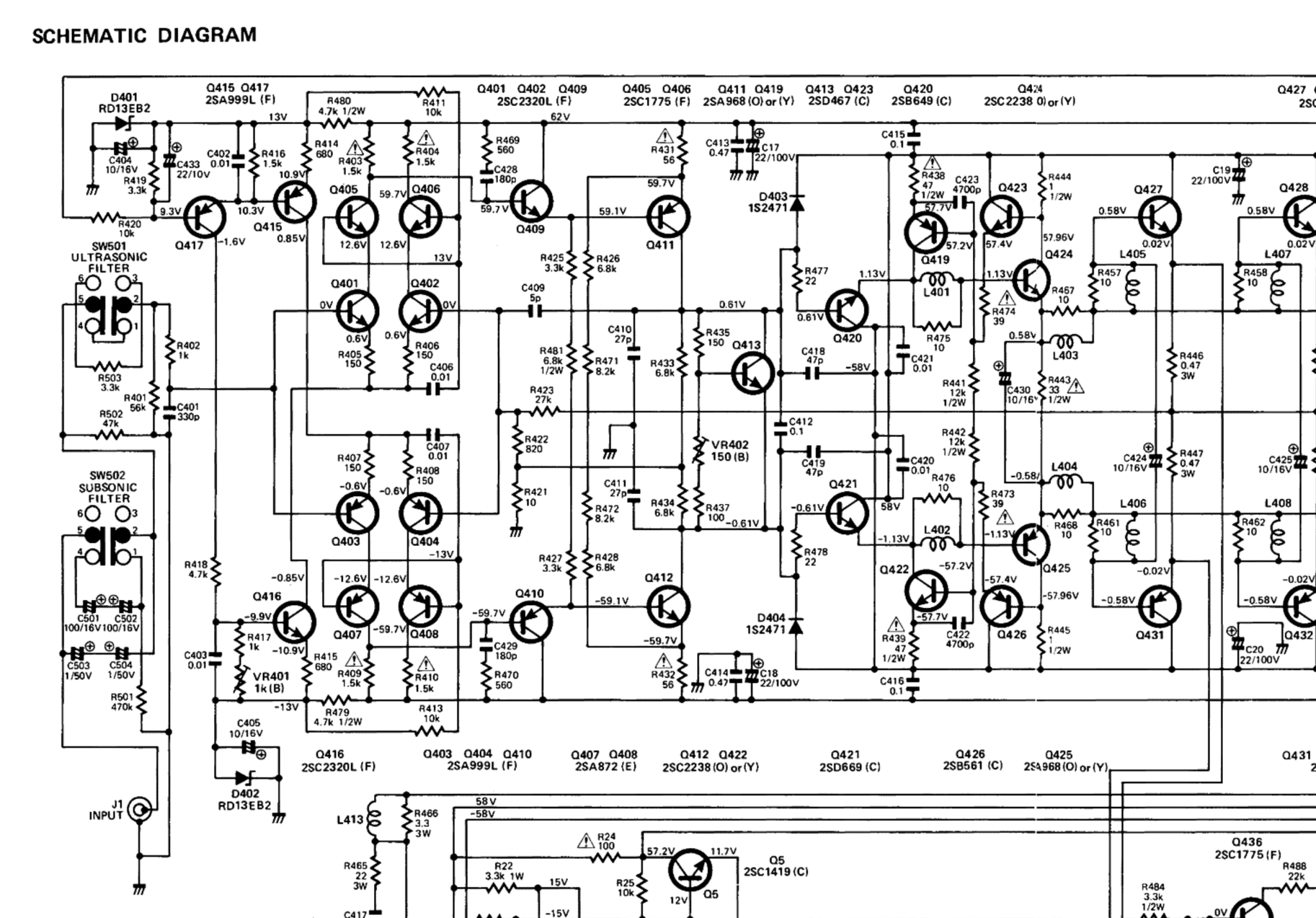

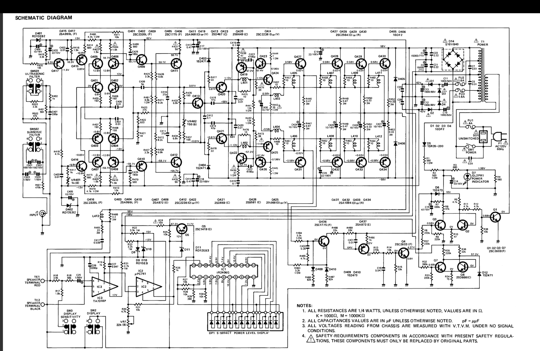

One of my power amplifiers, a Harman Kardon HK 775 developed a problem. It starts making a cracking / poping noise and the DC offset goes crazy. It's an intermittent problem. I'm almost sure the problem is one (or more) of the input stage transistors so I need a suitable replacement. The adjustment pot a new mutiturn bourns.
I already tried the KSC1845 and the KSA992 but I noticed two new problems. First, the noise floor went up and second, these transistors got super hot. Any other alternatives? I don't mind making some modifications in order to fit a replacement with different pin order or using SMD adaptors.
Any suggestion please?
