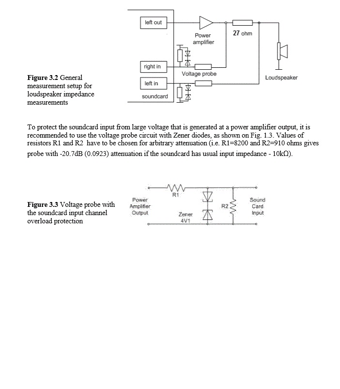

First of all, i have built an impedance box as per the Limp manual:
Here is the schematic i worked from:
The R1 as per Limp manual is 8.2 K Ohms
The R2 is 0.91 K Ohms
The zener diodes are parallel to the R2

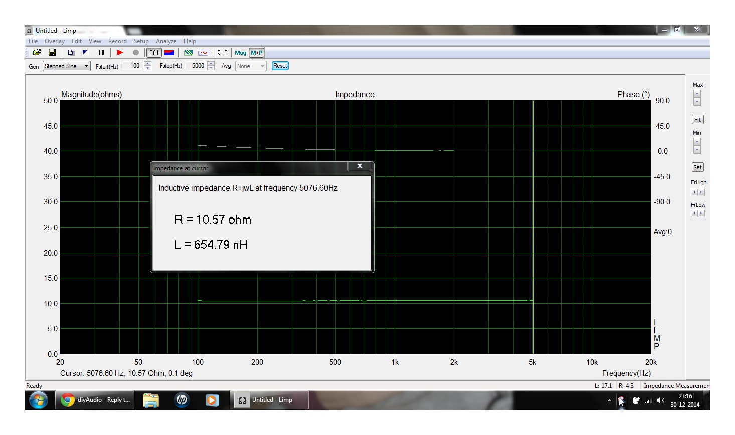

I am getting strange readings when i measure a resistor with Limp, I have followed all instructions with regards to settings, than made the calibration and then when i put a reference resistor of 8.2 Ohms 1% to make a measurement to verify correct readings, i get 30 Ohms period.

Picture 2 is the reading i get when i measure a 8.2 Ohm reference resistor (1% tolerance)
Picture 3 is the reading i get when i switch the inputs on the soundcart

Here is the picture from the Limp manual of the circuit of the jig i built.

Ah OK makes sense. It is like the Walin Jig II, with a voltage divider and back to back zenner diodes to clip any voltages that might harm the sound card inputs, so that it can be safely used with an amplifier driving the speaker.
I tend to do all of my impedance measurements directly driven off the sound card without an amp at all.
I'd double check all of the wiring, and double check the entries into LIMP and the calibration. When calibrating speakerworkshop or REW you use a known resistor (like your 8.2 ohm one) take the measurement, and then tell it what the real value is (it may be way off). after that it is generally accurate.
I would assume with limp you have to tell it your series resistor value of 27 ohms, and then calibrate using a known good resistor and tell it what it is.

Done that and now it reads 10.57 Ohm..
Still way off of the 8.2 reference resistor value🙁🙁

Ok, changed the L channel out on the soundcart to the R out.
First measured at 100 Ohm, then at 8.2 Ohm and finaly at 27 Ohm.
This did the trick!!!
Everything works smooth now!
Happy!
