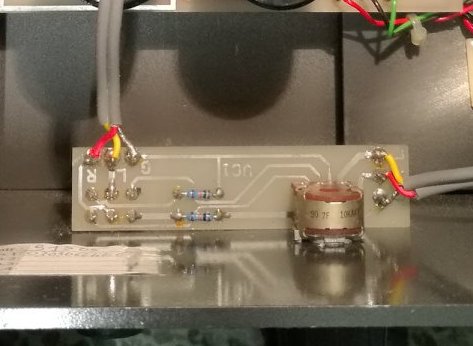

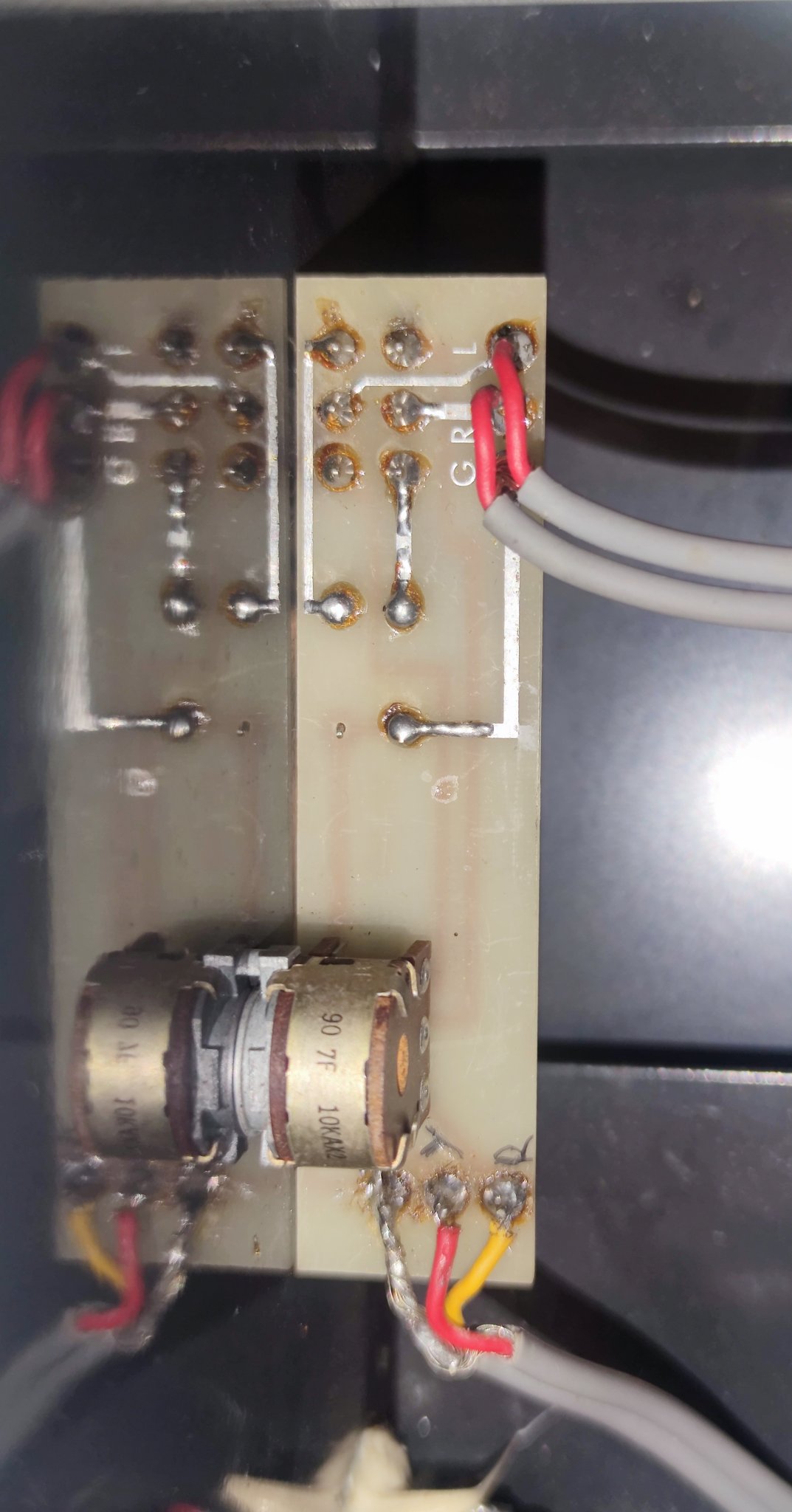

The last part of the puzzle on my amp is the balance pot resistors. It seems that someone has removed them prior to me getting the amp and the lack of them is the reason for the increased residual hum.
Do you happen to know their value?

1st: don't remember seen those 2 capacitors on the cooper side of the board and 2nd looking at your volume/balance board it doesn't seen to be anything missing.
I just came back from holyday of hell and need a couple of days to cool off but I will have a look at my amp during this week and take some pictures.

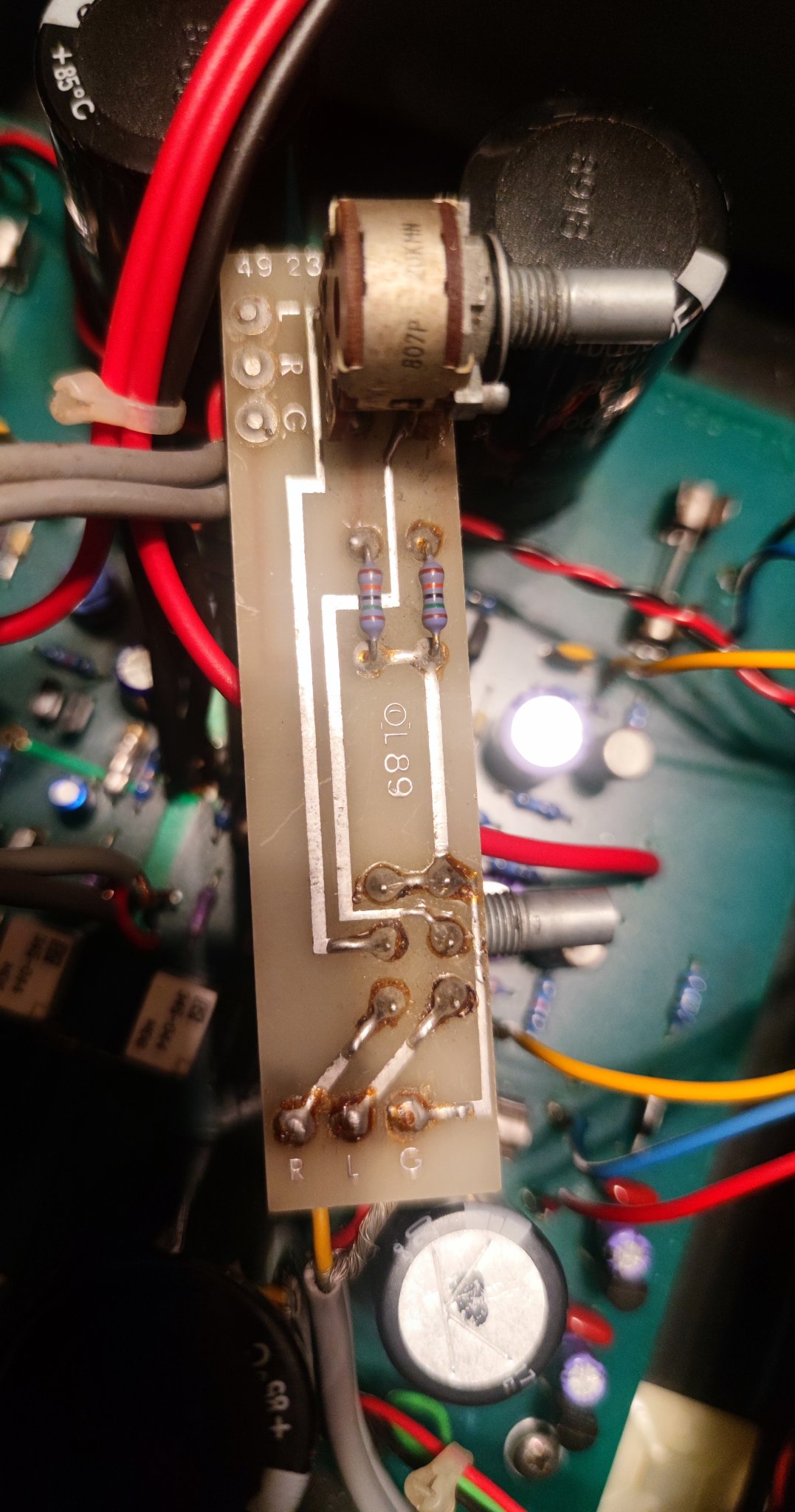

Thanks, that image is cropped from an image posted upthread. My volume & balance board is missing those two capacitors. The balance pot is broken on mine so i am going to have to replace it. It would be good to know the original values of resistors although it is not really important for the functionality of the circuit.

The volume board you posted is different from mine for a start ( earlier version? ) mine is marked with OL 89 at the centre and 49 23 by the balance pot.
The Volume pot is a cheap stereo Alps 10K and the 2 resistors are at the bottom side of the board and are 150K 1% 1/4W.

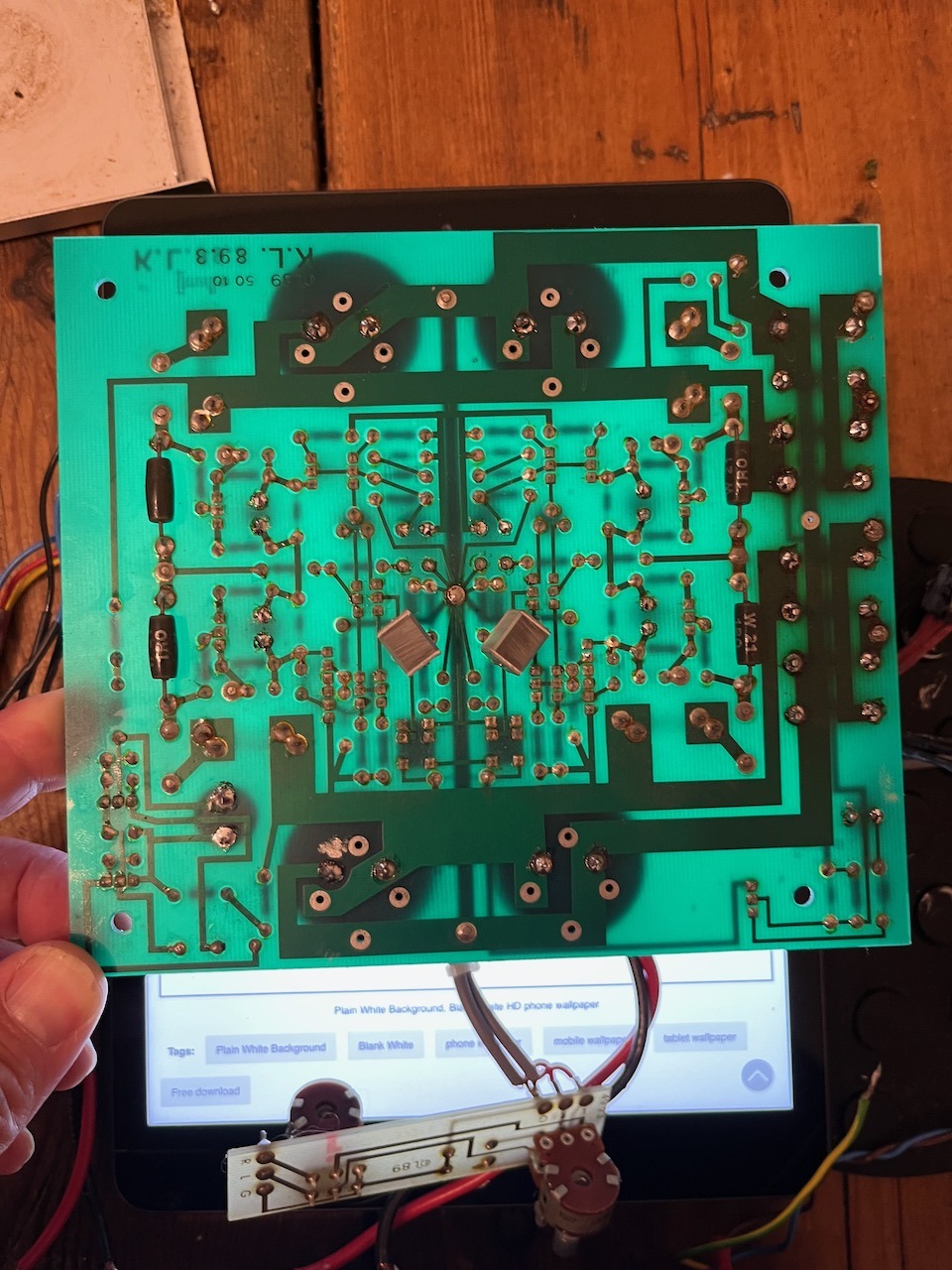

Going to start taking it apart to get access to the cooper side of the board to check for those capacitor and replace the Germanium transistors.
Thanks for those resistor values, that's very helpful.
Is that board on yours sensitive to EM noise? Does the balance pot buzz if touched? Mine is on the bench atm and the flying leads from the balance pot to the main amp input seem overly sensitive to airborne noise.
If I take the input directly off the lower impedance volume pot instead it seems less sensitive to noise.

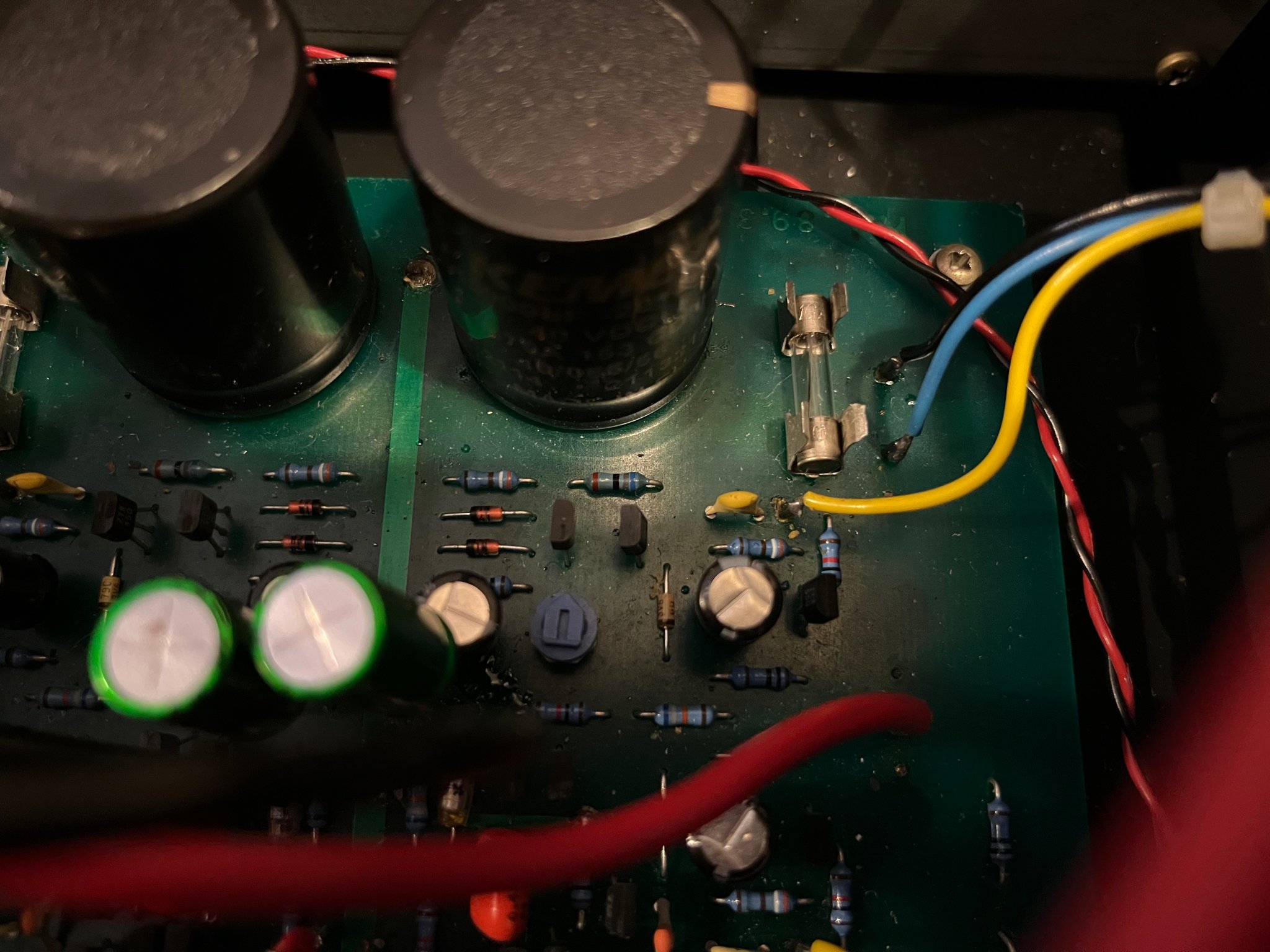

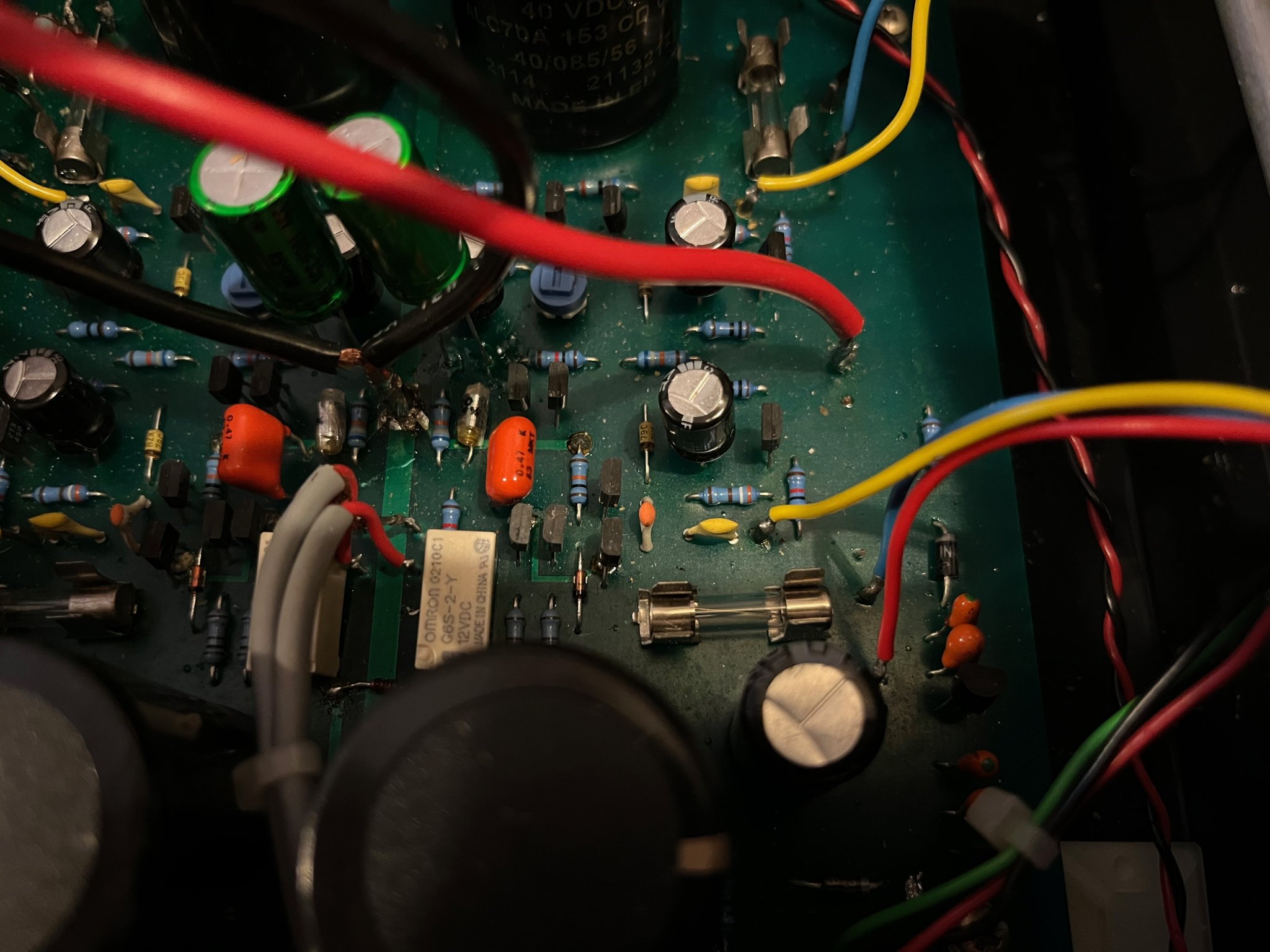

Just checked the fuses, I suspect they've been replaced as part of some other 'audiophile' upgrades found in my amp. They're rated F10 250v which seems absurdly over rated, what are yours rated at?
Afraid I can't help with your other issue but if the bias current is low the pot might not have much effect...? Will photo's help with the orientation?

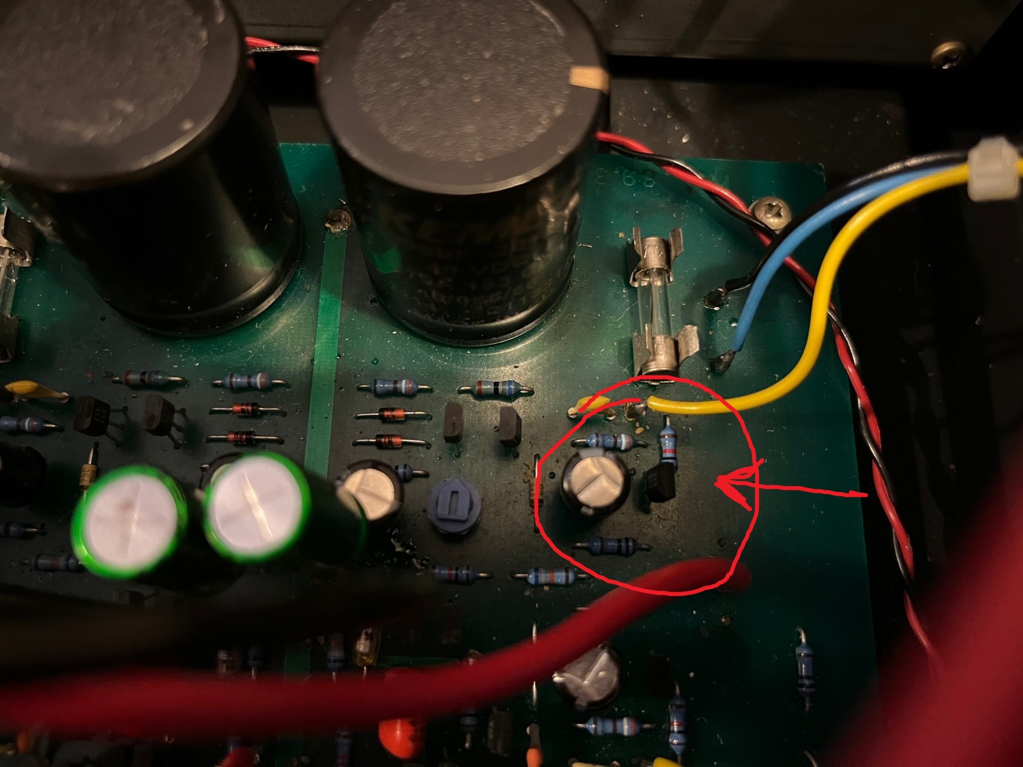

Hi and thanks
Yes mine are 10Amps too way over rated

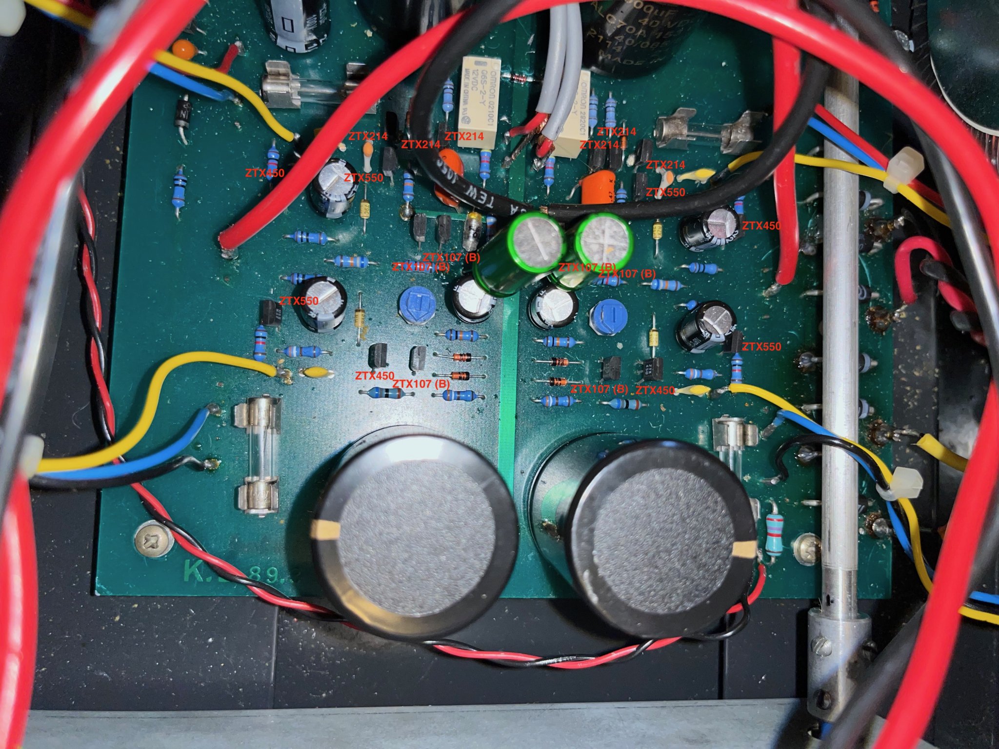

The ZTX on the 2nd picture is it the 450 or the 550 can really tell.
The pot changes the output offset when I move it right now is below 10mV.
Loosing my mind with this amp, I should have left the germanium transistor in place and saved all this time I'm wasting with it...
So as I suspected I swapped the transistors positions but at least the pin out was correct (emitter to emitter/base to base and collector to collector) it would power up with all correct voltages but without any idle/bias current.
So today I fixed the transistors but now It doesn't power up (inline bulb lit up) I do measure 145mV at the 0.68 Ohm resistor but that is with the power supply measuring 1.8Vdc.
I'm going to remove the inline bulb, close my eyes and power it up strait from the 240V line (assuming a idle/bias current around 700mV it wouldn't surprise me that there is nothing wrong with the amp (was working before the trany swap))
Any suggestions ?
