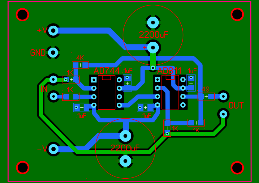

I'm trying to layout a board for the old Jung AD744/AD811 design using Sprint-Layout 6.
After reading about the 811(or most high bandwidth op-amps in general) requiring an ideal board layout, I'm not sure how to go about designing a board for this relatively simple design.
For instance, I'm not sure whether or not to use a ground plane on the top or bottom of the board or the best way to deal with the signal and power grounds.

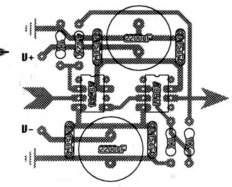

I started by trying to duplicate an old layout someone did back in the 90's as pictured below.
My plan is to use 1206 SMD caps at the supply pins instead of the larger through-hole caps in the pictured layout.
I'm also not against the idea of using 1206 resistors since they take up a lot less board real estate.
I've also attached the Sprint file(for the 90's design) I've been working on in case someone wants to change or totally redo what I have done. Please feel free to do so as I'm looking for different layout suggestions.

i still have my ad744+ad811 preamp from many years ago. i use it in between playing around with others. my layout is similar to what was done in The Audio Amateur several years back (i think the article is a free download), which is probably a little similar to your 1st post.
mine was done with a magic marker - it's a simple circuit.
so no CAD file to share.

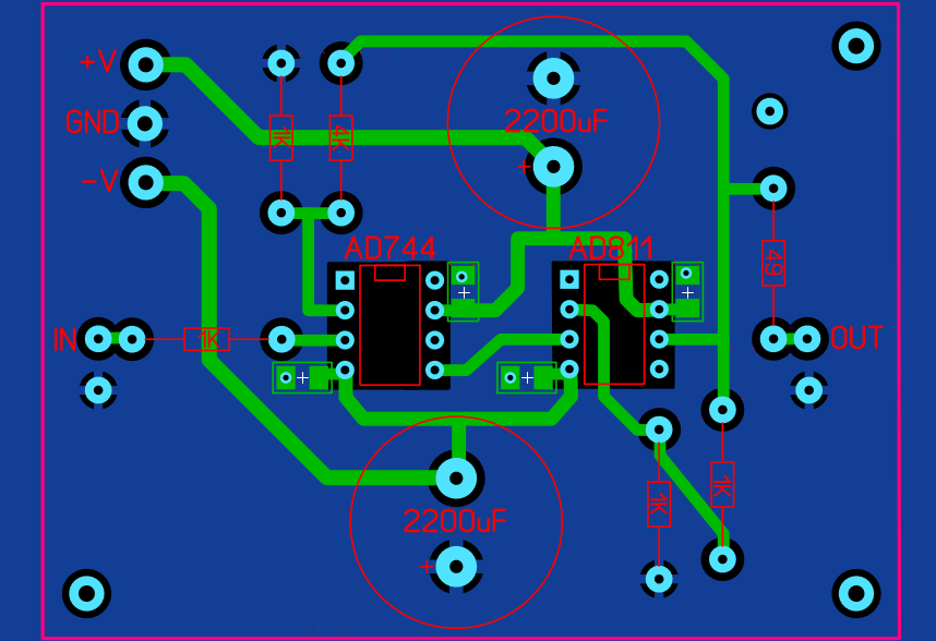

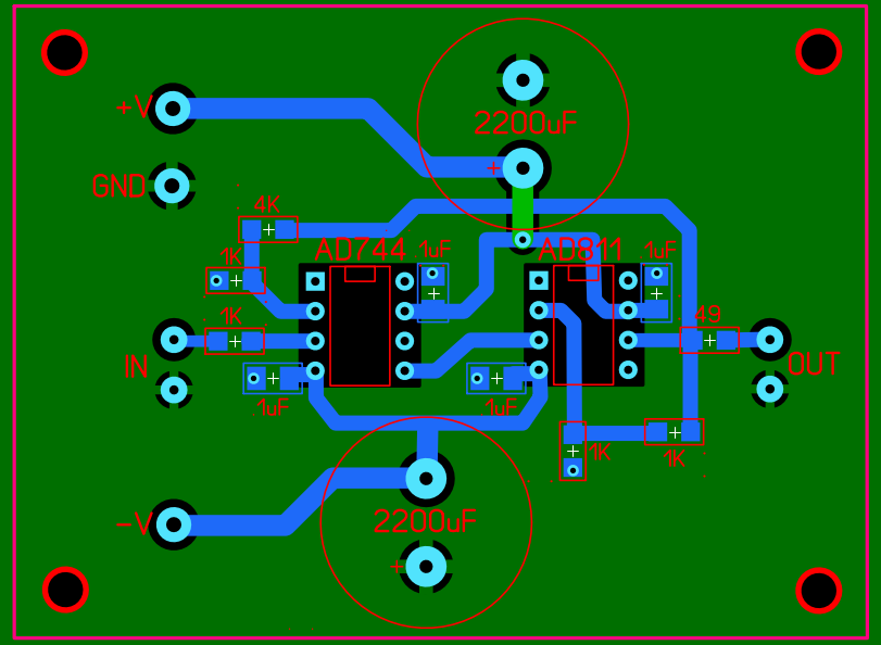

OK, here is my first attempt with all SMD parts(except for the 2200uF caps) and the ground plane on the bottom of the board.
Everything in blue is on top of the board and green is on the bottom side.
I realize I can reduce the width of the board on the left side, but at this point I'm more interested in getting the layout correct.
Does this look any better?

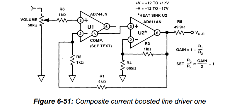

Your schematic in post 1 shows three connections to signal ground (white triangle symbol) - they are the input volume pot, R2 amd R4. These nodes should have their own net, then that net goes to a single point on the power ground net.
Your initial layout, like your most recent one doesn't distinguish between signal and power grounds but lumps them all together. To me that's like not distinguishing between waste water and sewage but lumping them both together.

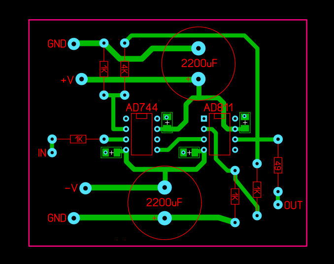

Is this what you're talking about? There is no volume pot on the board.
Signal grounds connecting to ground on the lower 2200uF cap only.
