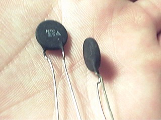

There are special NTCs intended for soft start and they work fine. For higher power applications mount several of the lower resistance high current types in series and bypass them with a relay after 200ms or so...
For example, In one SMPS producing over 2KW I'm using four EPCOS B57236S259M in series (4*2.5=10 ohms) to inrush-limit a 4x470uF capacitor bank (1880uF) fed directly from rectified mains. I think that this application is well within specs according to the datasheet, as the maximum allowed capacitance for one of those NTCs at 230V is just 200uF, but this figure seems to increase with the number of series NTCs squared, yielding 3200uF for 4 NTCs.
Datasheet:
http://www.epcos.com/inf/50/db/ntc_06/ICL__B57236__S236.pdf
A relay fed from an internal 12V housekeeping (fan) supply bypasses the NTCs as soon as the SMPS comes up. I think that this approach is more tolerant to failures than the traditional relay-and-plain-resistor because the NTC effect prevents huge dissipation in case the relay does not close. Also, it responds better to power cycling than a plain NTC because the relay keeps the NTCs bypassed and cool during normal operation.
