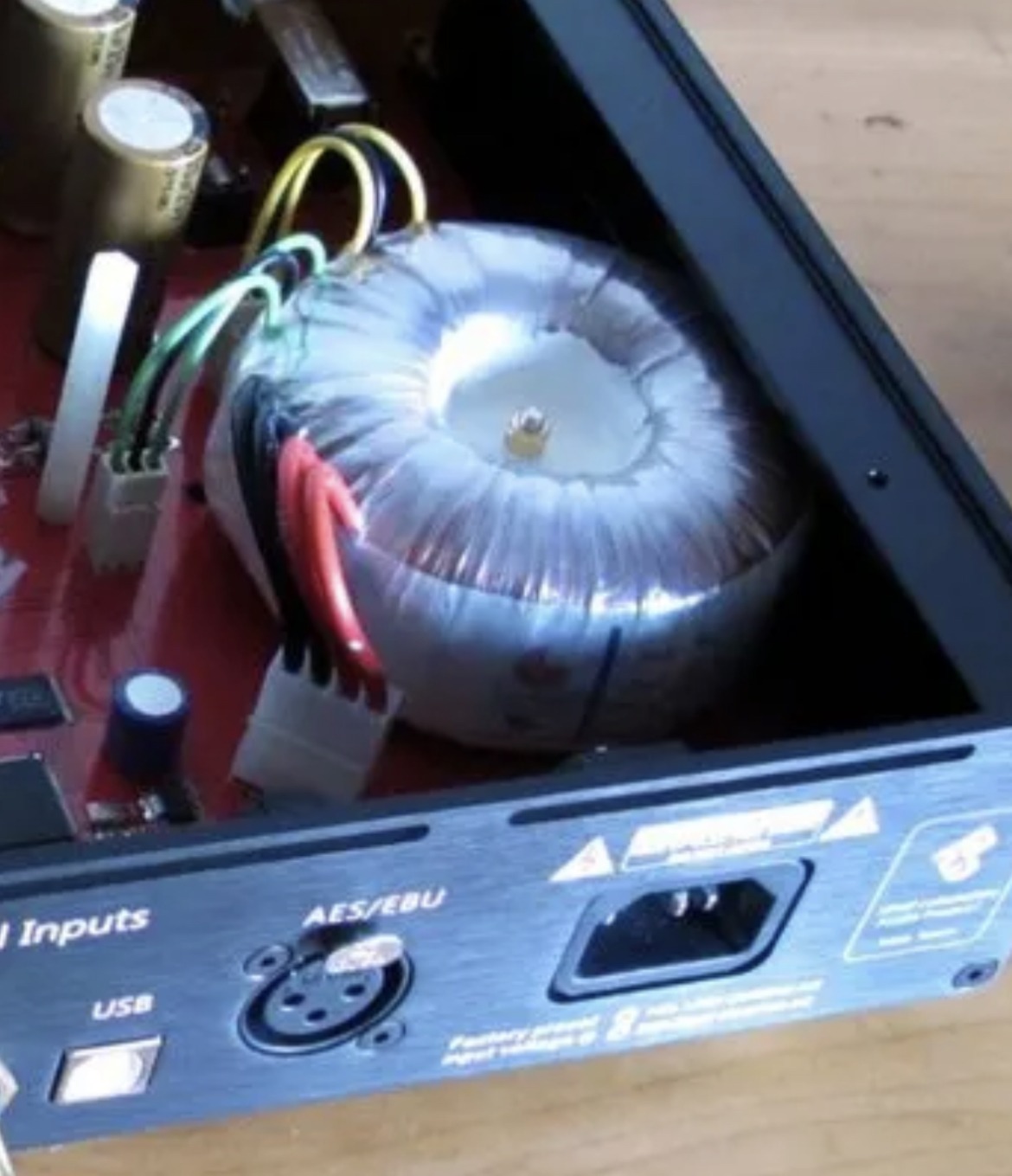

I have been trying to source a replacement toroidal transformer for a spare DAC board resurrection. This is for an MHDT Pagoda Balanced DAC.
There are three connectors, which appears to not be typical. I have not been able to find any similar configurations. I also do not have the voltage requirements. The manufacturer is not interested in facilitating my request.
The transformer appears to have a dual primary (2 reds and 2 blacks) to allow operation on 120V or 240V. Unit likely has a switch for selecting mains voltage.
Transformer appears to have two separate center-tapped secondaries: 2 greens and a black, and 2 yellows and a black. The black wire being the center-tap for each.
Are you able to measure the output voltages of the original transformer? Measure AC volts green-to-green, and AC volts yellow-to-yellow. If not, it will be impossible to select a transformer without this basic information. As far as wattage/amperage is concerned, you can be guided by the physical size of the toroid.
Thanks for the information.
I do not have the original transformer. It was installed onto a replacement board and sold with the DAC. I’m trying to see if I can restore this partially non-functioning board.

I forgot to add- the board I have is the only balanced version and therefore the most power demanding. Would be fine with over- sizing if I know what the general maximum specifications should be.
The other problem is finding a transformer with the same (3) connector layout.
