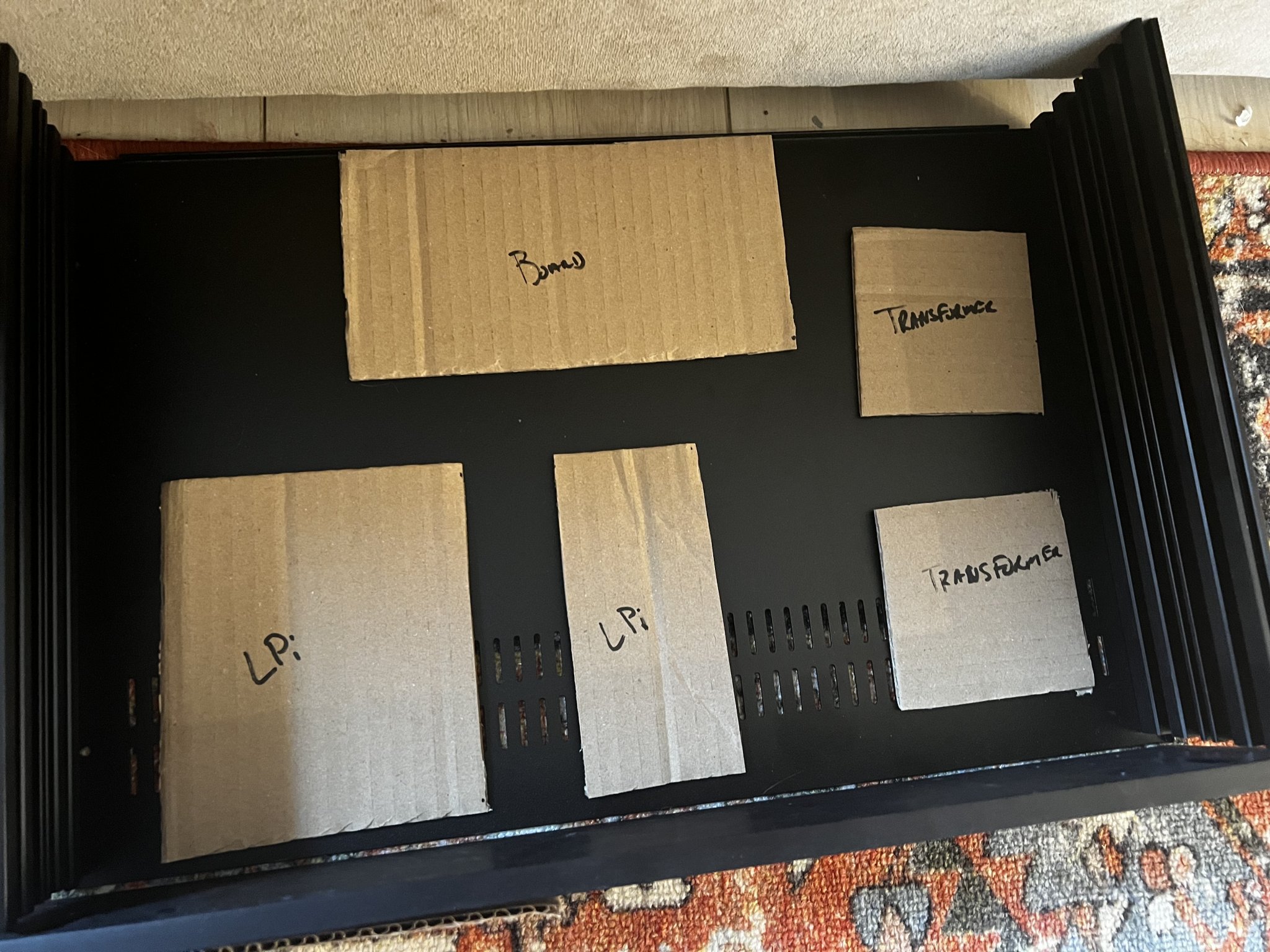

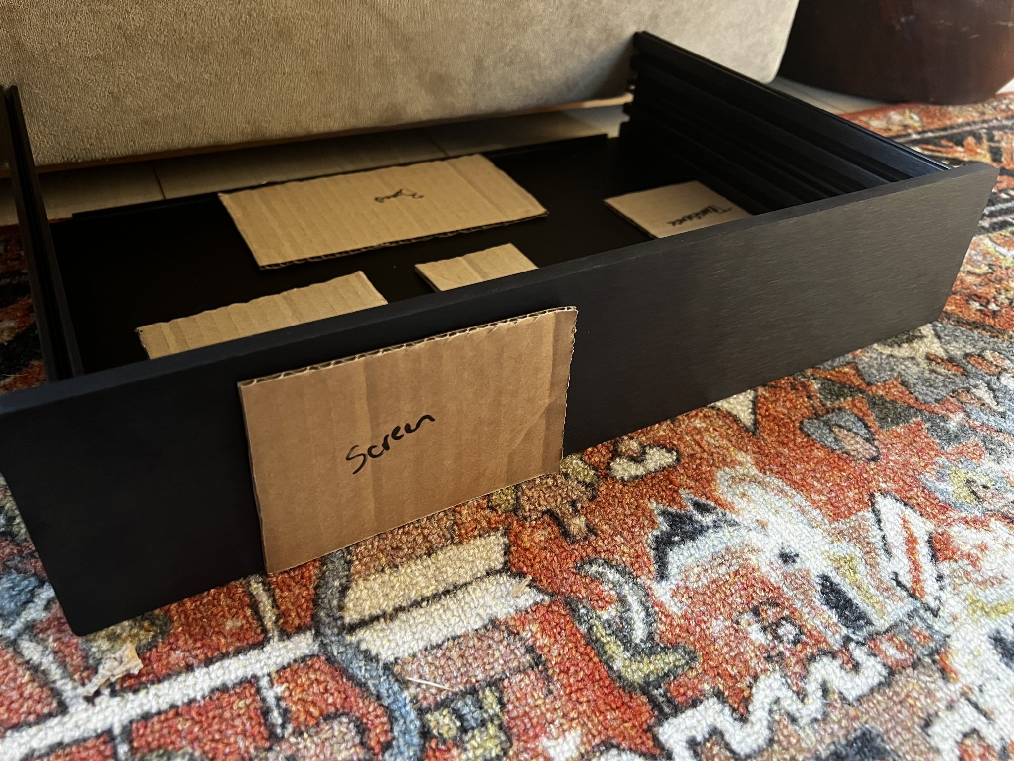

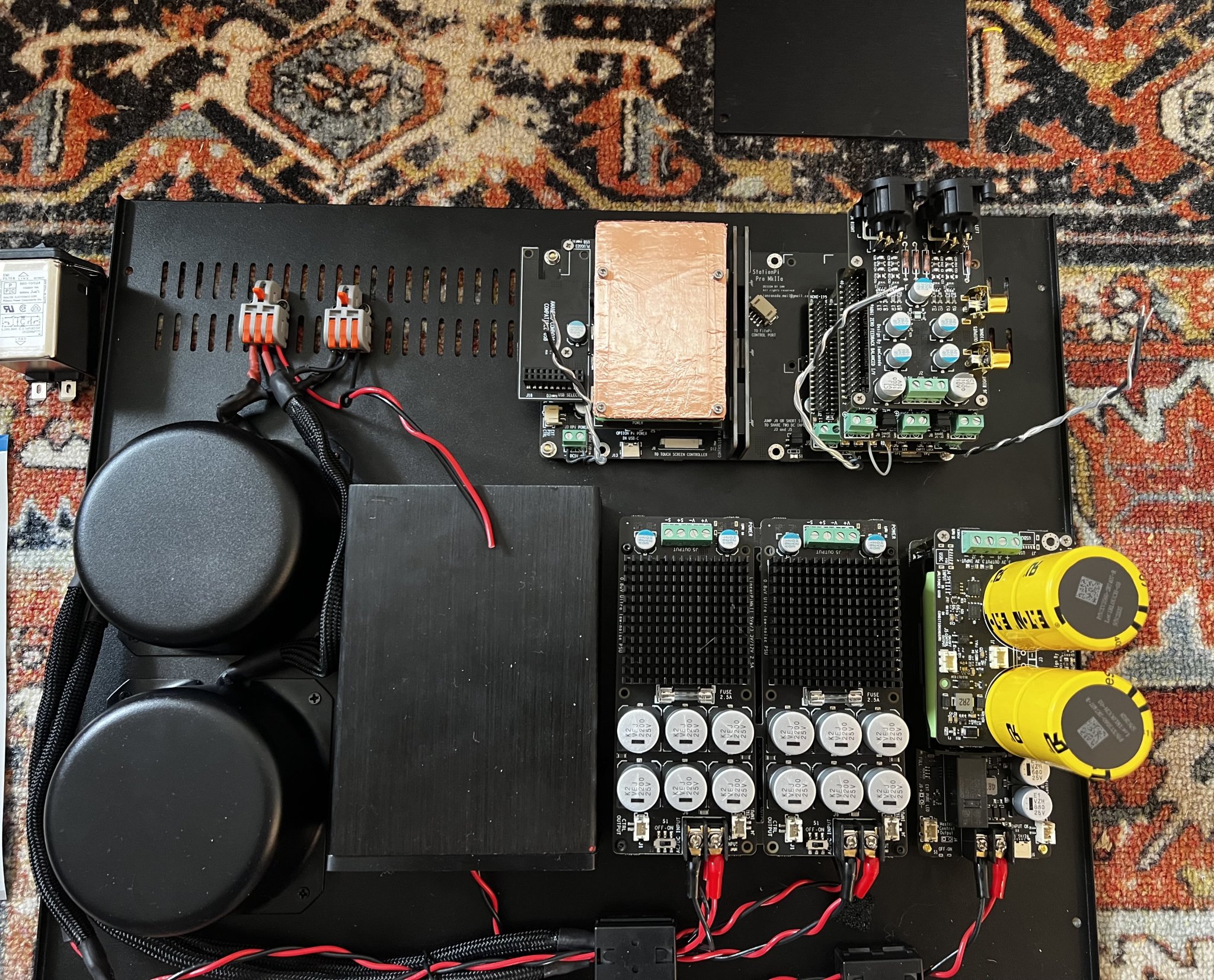

Basic layout idea

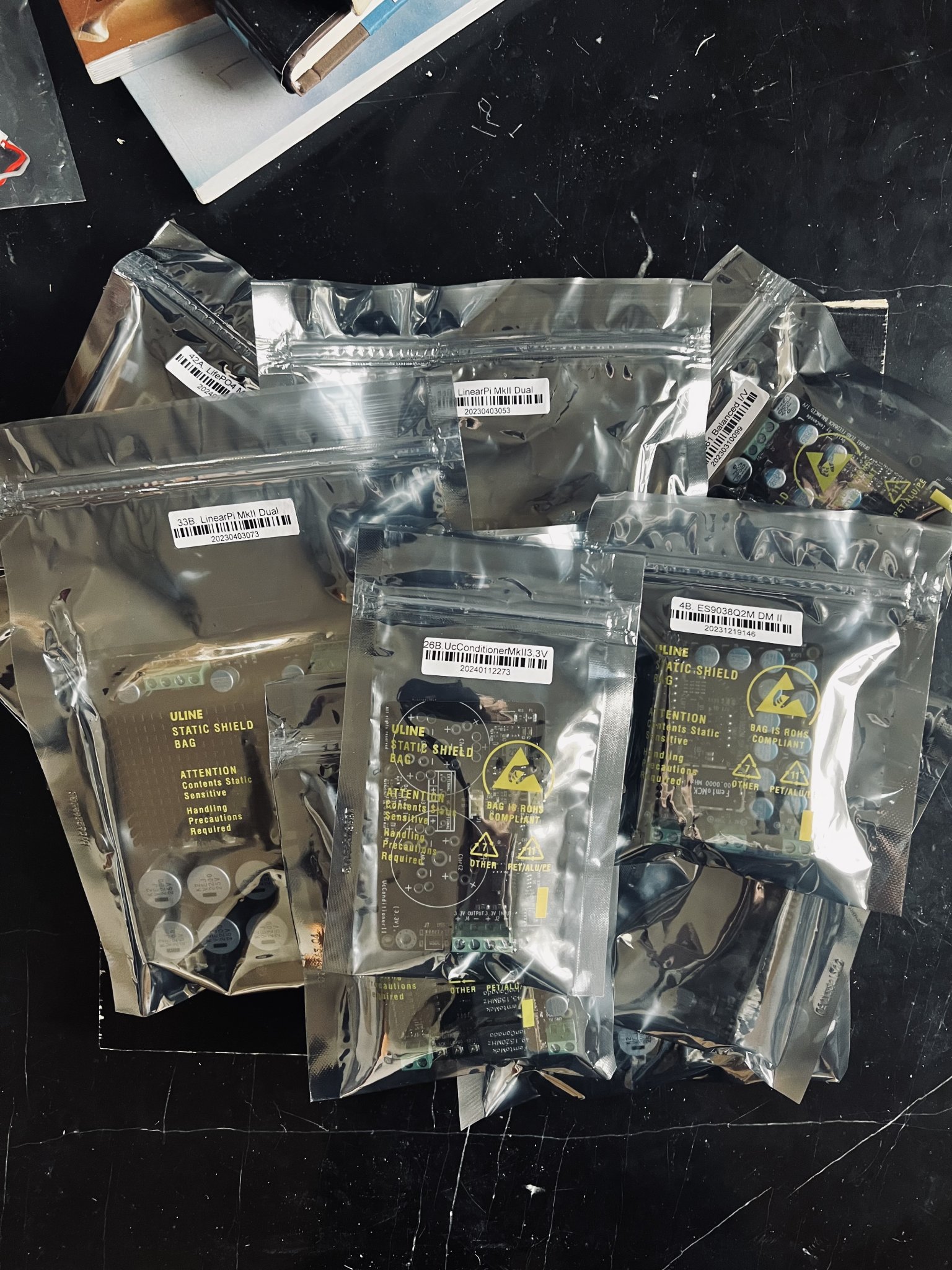

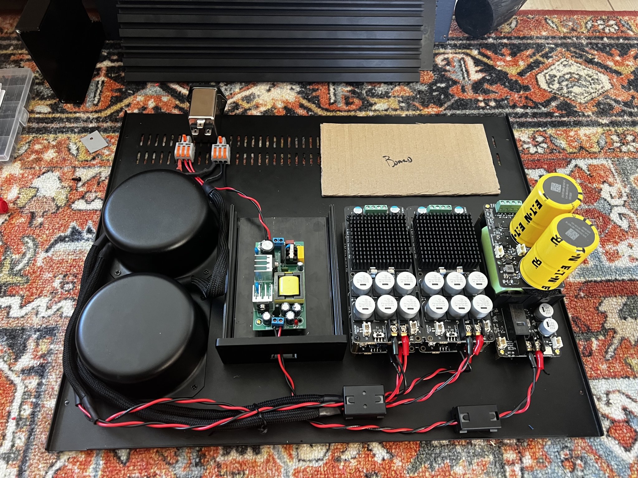

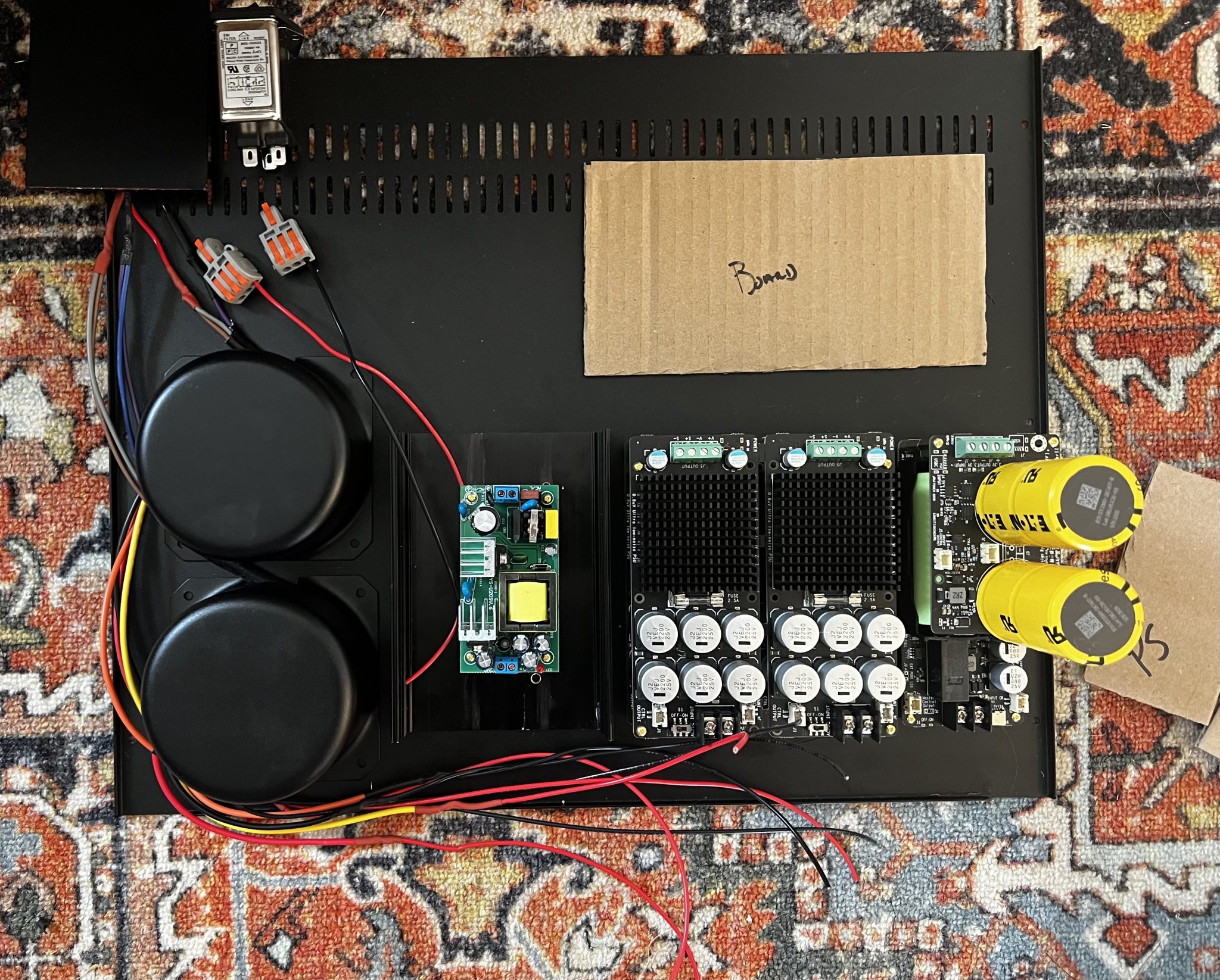

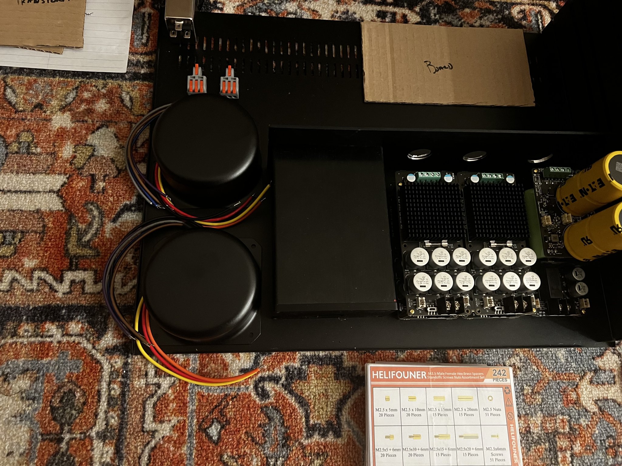

I amended and upgraded my initial shopping order a little to the following:
Stationpi Pro
FIFO q7
Dual mono dac
Opa861
Dual Linear pi x2
Ess controller
LifePO4 mini 3.3v
UcConditioner 3.3v

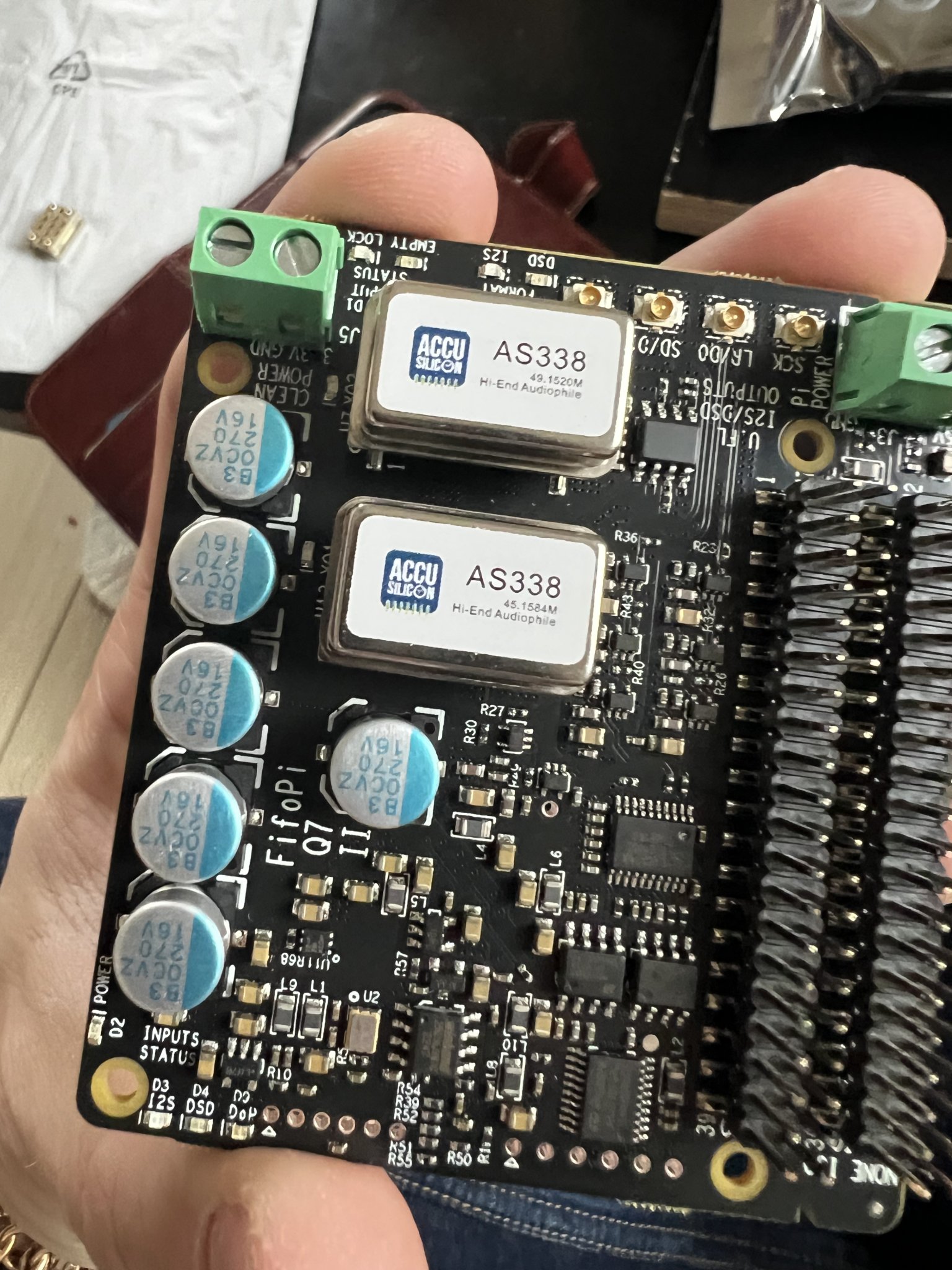

Also added an adjustable Talema powersupply that will provide 4v to the LifePO4 mini
The reason for the upgrades are for the 2 Accusilicon 338s 49.152 MHz & 45.1584MHz clocks I purchased.
This powersupply with the UcConditioner will provide the cleanest power possible to the FIFO Q7 and the high end clocks.
I’ll provide all the links if anyone asks.
Basic layout idea

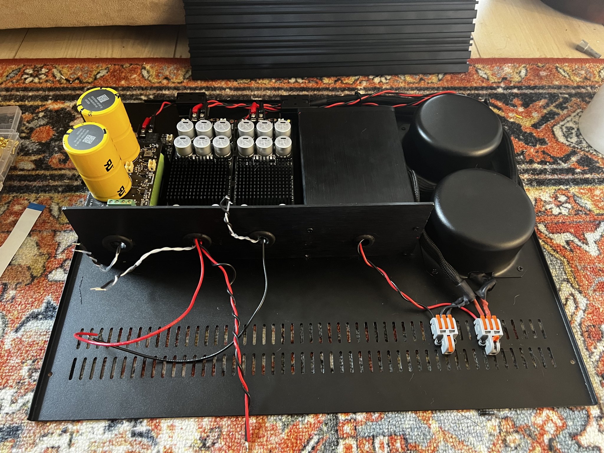

Nice to see an enclosed chassis idea. That screen location on the front is going to cost a bit to get cut out of that 10mm front panel. What are your plans for that?
Otherwise, I'm just getting going on the iancanada gear so I'm not the best builder to critique your parts selection. From my understanding, though, it looks good. I see DAC parts and streamer parts, along with some power goodies. Don't forget to buy your RasPi!
