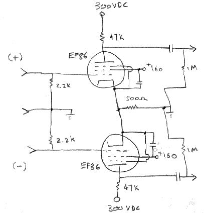

Hi everyone,
I have been messing around with a balanced preamp for a low impedance dynamic microphone (like a shure sm-57). Problem is I don't know much about this stuff and have no software to help build it. So, I have been tweaking wires and values to get good results, mainly using potentiometers in place of the cathode and plate resistors. I have attached my circuit and was wondering if I could get some comments on it, or maybe even have someone build it in software and test it!! That would be most appreciated.
I know that mic preamps really benefit from a transformer or solid state input for hi gain and low noise, but I just want to try something different here. C
ould anyone suggest a good output stage for this thing?
Is it un-common to have a balanced, low signal pentode input stage?
What exatly do you do with the screens grids in this situation?
Thanks for any help at all. The circuit is attached below...
-Matt Mitchell

Matt,
dynamic microphones are like moving coil cartridges in output level and source impedance.
Methinks, pentodes are too noisy for that.
A circuit you could try : look at Allen Wright's differntial preamp RTP3 or RTP5. His website is www.vacuumstate.com . TMK, this preamp also was used as professional µphone preamp. Without phono EQ of course.
The thing uses cascodes for the input stage, the lower system being a 2SK147 FET and the upper one an ECC88 triode section. This preamp has no noise problems and is ultra-neutral; detail resolution is top-notch.
