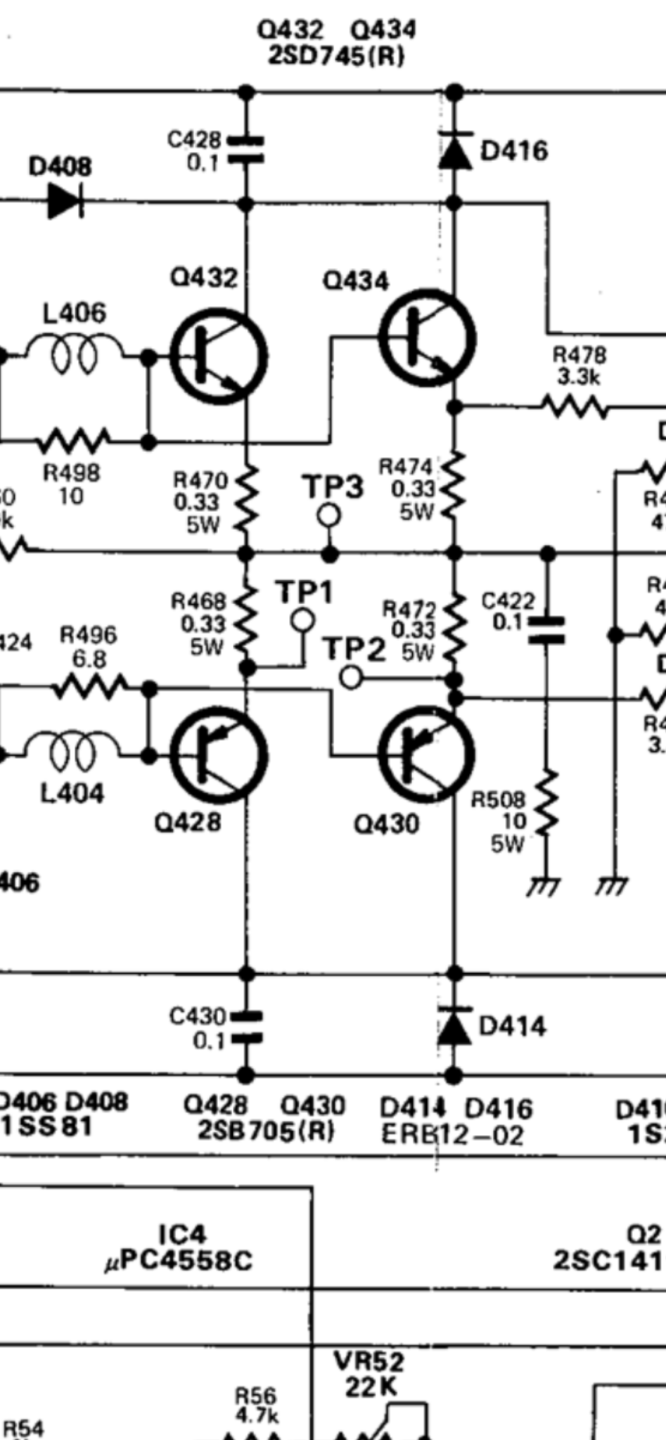

Does it matter much that the good channel is not balanced? ie the voltage across R468/470 is quite different.
Would you detail the voltages you're seeing across R468,R470,R472,R474? Be sure your measuring with no load at output terminals.
Further up in the post, whilst I was setting the bias. I’ve since increased to a total of 33mv, but one channel is balanced (the bad one) and the good one isn’t.
“One channel is definitely not as balanced. When I was setting bias initially, left was 11.5+11.5, while right was 10.5+12.5. Across R406 is 5mV on left and ~20mV on right. The 2SA1111/2SC2591 pairs have been replaced on both sides.”
The right channel now has the original transistors back in, while the left are new but I I think not genuine. My next step would be to swap them over.

An update - I swapped the 2591/1111 pairs over and adjusted bias to ~30mV total. (somewhere in between the two different views of what it should be).
The imbalance is still there, left is 15.3/15.2 and right is 16.4/13.4.
However after 30 minutes of playing it hasn’t dropped out at all, so I’m a bit stumped now.
Tough to troubleshoot if it's behaving. You may have to wait unit it acts up again.
I'll offer some thoughts.
I don't understand your notation--- does 16.4/13.4 mean 16.4mV across R473 and 13.4mV across R471 ?
The design monitors only one of the two output pairs, eg. R473 and R471 are monitored, but R469 and R467 are ignored.
The voltage between the emitters of Q431 and Q427 should match Q433 and Q429. Be suspicious if you find dramatic differences.
With power off, try to measure and tabulate resistance of all four emitter resistors at the leads. Ideally they'll be equal, but differences may contribute to the different voltages you're observing. Try reflowing all these solder joints to ensure low (reliable) resistance to emitters and output. Heat in these areas can be a stressor of these solder joints.

My meter doesn’t have enough resolution to go lower, the resistors all measure as 0.4 OhmsThe voltage between the emitters of Q431 and Q427 should match Q433 and Q429. Be suspicious if you find dramatic differences.
LCh
Q428-432 is 30.7v
Q430-434 is 32.0v
RCh
Q427-431 is 25.0v
Q429-433 is 22.0v
I know the right channel is not balanced but I can’t figure out why.
In any case, it seems to have stopped cutting out since I swapped the drivers between channels so I’ll cut my losses and put it back into service, while keeping an eye out for some transistors.
