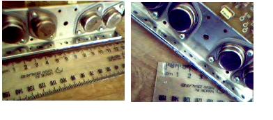

heres a pic of my eti amp,i need to fix it to this heatsink
it has 5 holes already in the bracket..only 2line up.
how many screws should i use? as many as possible
if i drill lots more holes,wont that reduce the amount of surface area contacting the heatsink..so how many?
should i use the existing 2,and drill 2 more,that makes it even.
or should i drill 4 more,making 6 screws in total
btw it doesnt need such a large heatsink,but later i might bridge it with another..
also im going to add some limiting transistors on output to stop it from drawing too much current.
<50watt into 8ohm amp class a/b>
also,should i smear heatsinking compound onto the bracket-heatsink face? it doesnt say to in the manual but it couldnt hurt if i have some left over.

LOL....Mike your picture is so small that its hard to judge.....give us some dimensions....like Length of the heat sink
A good nominal figure would be every 3 inches or so and compound would be good also
a few holes wont decrease the effieciency any

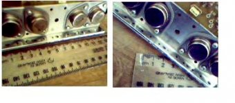

there is already 5holes at about 27mm apart,but only the 2 end ones match up with heatsink..
about13cm long bracket and 30cm long heatsink
35mm long fins 10mm apart
should i put 2 screws each side near the transistors themselves,leaving none in the middle? or put 2 there too lol/.
