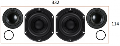

drivers picked dissensions made
i have read that crossing a tweeter very low is a bad idea
sow i am going back to the original plan
a sub woofer crossed very low to a sealed full range speaker
since the board does the crossover don't need big expensive coils
i will have approximately 25w of low distortion power at 4 ohm
i am sticking with the Peerless by Tymphany SLS-85S25CP04-04 3-1/2" Paper Cone Woofer
Peerless by Tymphany SLS-85S25CP04-04 woofer kopen - SoundImports
for the full range i will be using Peerless by Tymphany NE65W-04 2" Full Range Woofer
Peerless by Tymphany NE65W-04 woofer kopen - SoundImports
i never made a crossover over before but reading the graphs i am thinking something like 400hz?
i believe the lower i cross the more booming the sub woofer will be
did i make a good choice with the full range driver?
i will design the depth and calculate the total cabinet size tommorrow
port will be a bit larger then first and 10mm larger than the drawing 40mm drainpipe 36.4mm inside
air velocity 17 at 17watt bit of flaring good enough?
