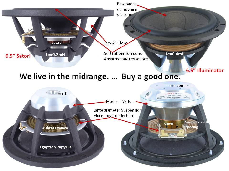

The positive reviews of Jeff Bagby Kairos(2 and 3-way), and Joachim Gerhard Kalasan make a "statement" for 6" midrange drivers with modern motors, suspensions, and cones which can cover 100-1,800Hz - the vocal range. You can mix SB Acoustics standard and Satori drivers to meet your price/performance goals. common pics of 6"-mid designs.
