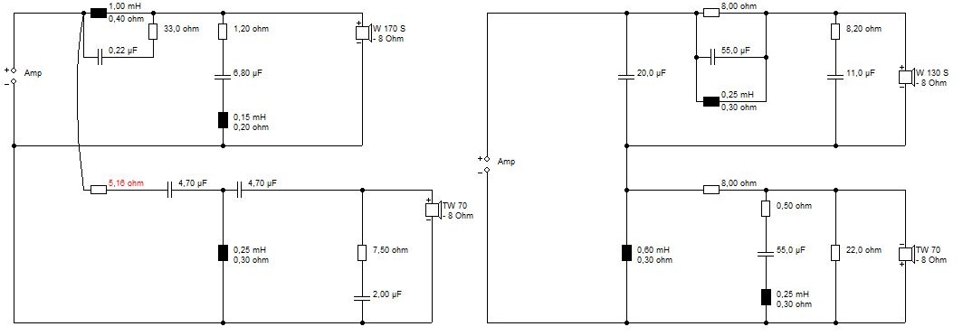

Thaks for digging up that Acoustic Reality schematic Steve. I have on file as well, but was too lazy to go find it and scan it, etc. 🙂

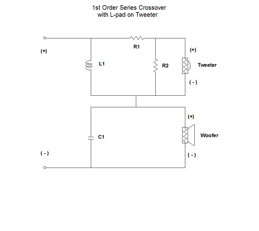

Hi Majerjack, if you tell us the specific drivers you are planning to use we may be able to give better guidance on the effects of both a parallel resistor and the possibility of using a first order crossover.
My question is: will a parallel resistor on the tweeter alter the characteristics of a first-order series crossover?
If anyone has specific knowledge on the subject, I would appreciate your reply. If you have experience with series crossovers, I would be interested in hearing about that also. Thanks to all.
Attached is a sketch of the basic 1st order 2-way series, with an L-pad on the tweeter.
In the context of your question, there is no series resistor in the L-pad (R1), only the parallel resistor (R2).
A parallel resistor (R2) will tend to attenuate the tweeter. One point of caution is to make sure that the combined impedance doesn’t go too low.
I’ve found that there is a lower limit to the size of R2 where sound quality is affected, and of course it depends on the particular tweeter. I usually try not to use R2 by itself to attenuate more than 1 or 2 dB. In general, my preference is to use the series resistor (R1) as a more effective way to attenuate the tweeter. Sometimes using 30 to 50 ohms for R2 takes out just a little of the high frequency hash, if present. Removing too much can eliminate valuable details from the sound quality.
I use series crossovers most of the time, perhaps if for no other reason than for my own amusement. 😛 However, I have yet to find a combination of drivers that allows only 1st order.
Typically, I use 2nd order on the tweeter, where a capacitor is located in-line with R1. (One end is attached to the inductor L1). That gives a steeper roll-off, allowing for a crossover frequency that’s closer to the tweeter resonance.
Along with that, 1st order on the woofer is usually adequate. An impedance compensation (Zobel) on the woofer helps flatten the woofer’s impedance. This can help to make a smoother transition to the tweeter’s impedance.
Your thought of flattening the impedance of the tweeter could be accomplished with its own “Zobel”, but there’s really little benefit in doing so.
With the right combination of drivers and circuit components, a series crossover can yield a relatively flat impedance, which is sometimes desirable.
The down side of higher orders (or additional components in the network) is the complexity, and the difficulty for mere mortals to set up and perform calculations. Without a lot of trial and error, the best approach is to use some kind of simulation software.

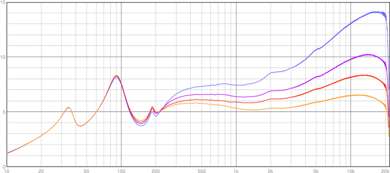

Here is an actual impedance plot of a 2-way with 100uF + 5mH (nominal 8R tweeterm 4R woofer) reflecting the changes by adding a shunt R of 15, 25, and 15||25R.
Tweeter is in an aperiodic TL that does a good job of significantly reducing the tweeter impedance peak.
The above is still a work in progress.
Our listening bears this out. Levels are no attentuated much at all.

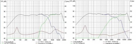

Here's some paper drivers with a parallel and a series. I much prefer what I'm seeing with parallel in terms of impedance and cone-breakup suppression. As DaveR says, first order bass, second order tweeter is minimum in either topology. FWIW, the LCR Fs resonance filter in the second (series) example is effectively second order.
If I was going to try a simpler series filter, I'd really want something like that famous Vifa P13WH of Lynn Olson's, or a Morel driver. Around 0.6mH anyway, to avoid needing bafflestep correction.

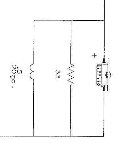

Hi all,
I try a 33 Ohm with 6db serial xover..
Nothing change in impedance curve or response curve.
But how calculate this value ?
Thank's.
Phil.
Thank's.
Phil.

Thinking back on the crossover topology and the use of a parallel resistor. I just can't see a technical reason putting a 33 Ohm resistor in parallel with 4 Ohm VC is going to do much of anything useful unless it has significant inductance. Ever measure some of those "Low L audio quality" resistors? I have to think about this some more as I only see negatives.
