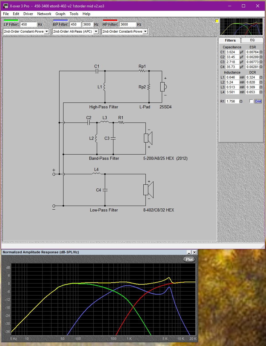

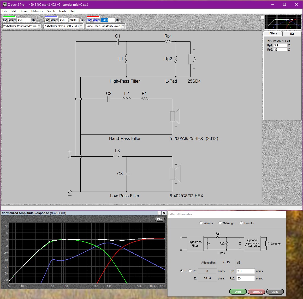

This is my first post, and third speaker design I am working on.
First here's the drivers:
Woofer: Eton 8-402
Midrange: Eton 5-200
Tweeter: Eton 25SD4
All 8 ohm
I am using X-over3 to design my first crossover and came up with the following values:
450hz low to mid, and 3400hz mid to high
Slopes: 2nd order-constant power for the woofer, 1st order solen split -6db for the Midrange, and 2nd order-constant power for the tweeter.
These values give me the flattest response.
I guess my question is do these look good, as this is my first crossover design.
I am really curious about the 1st order filter on the midrange, because if I select a 2nd order filter there is a 5db peak in the graph at 5khz.
Attached is a screenshot of my design in X-over3.
I really appreciate the help! 🙂

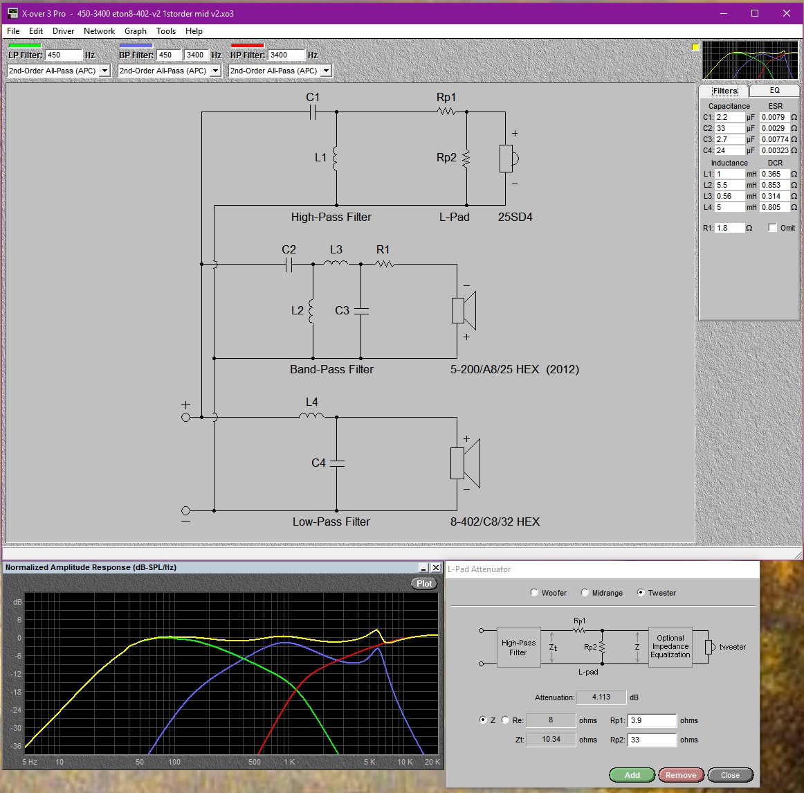

Here are the values for the components:
Tweeter: 3.3uF & .68mH with a l-pad: 3.9ohm & 33Ohm for a 4.1db attenuation to match the other drivers sensitivity.
Midrange: 33uF & .5mH (reversed polarity) X-over3 added a 2ohm resistor in series.
Woofer: 33uF & 3.5mH

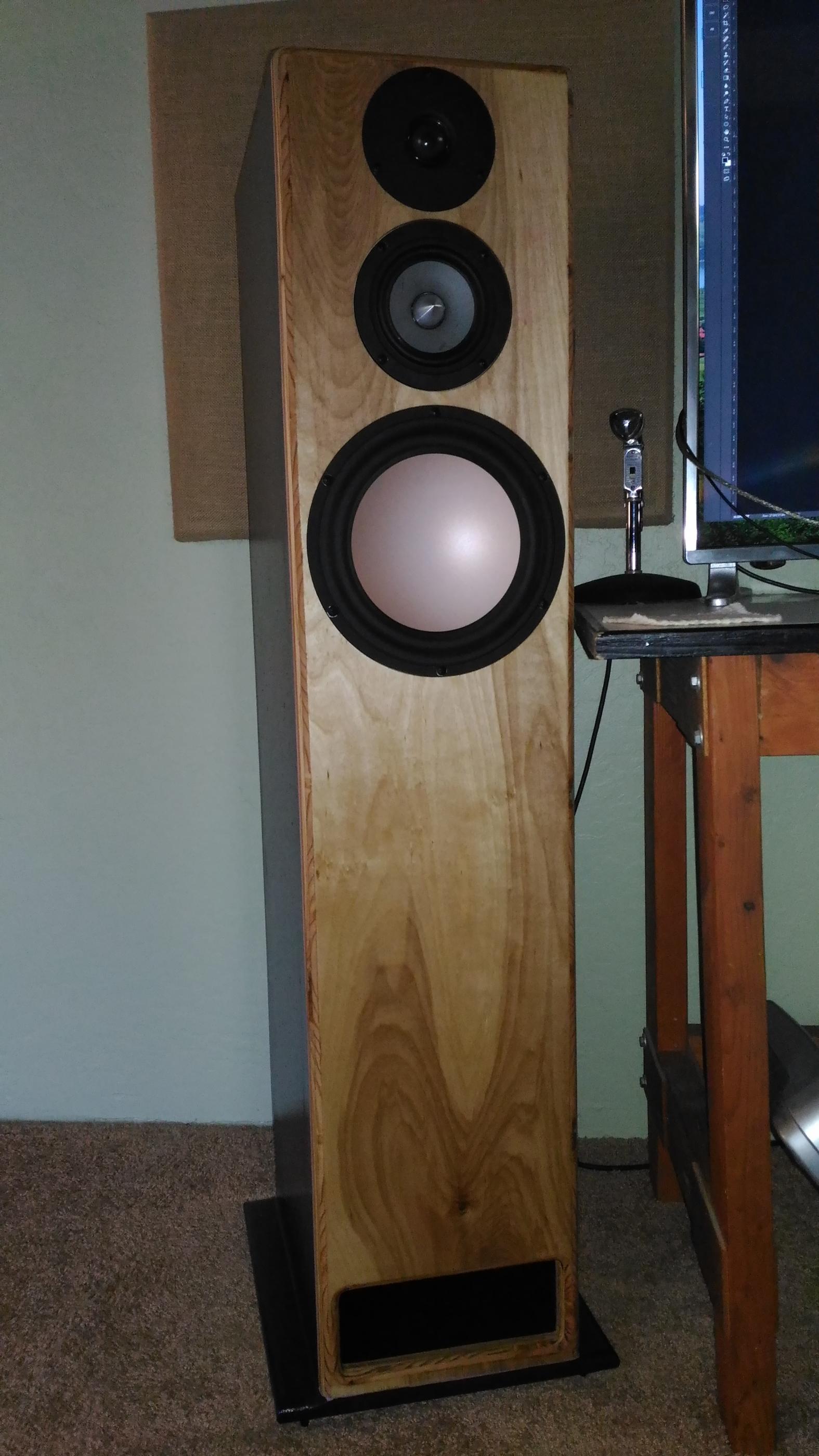

Attached is a picture of my first 3-way speaker design...
Also attached is a screen shot of my crossover design using 2nd order filters on each driver.
You will see the components involved on the upper right of the picture.

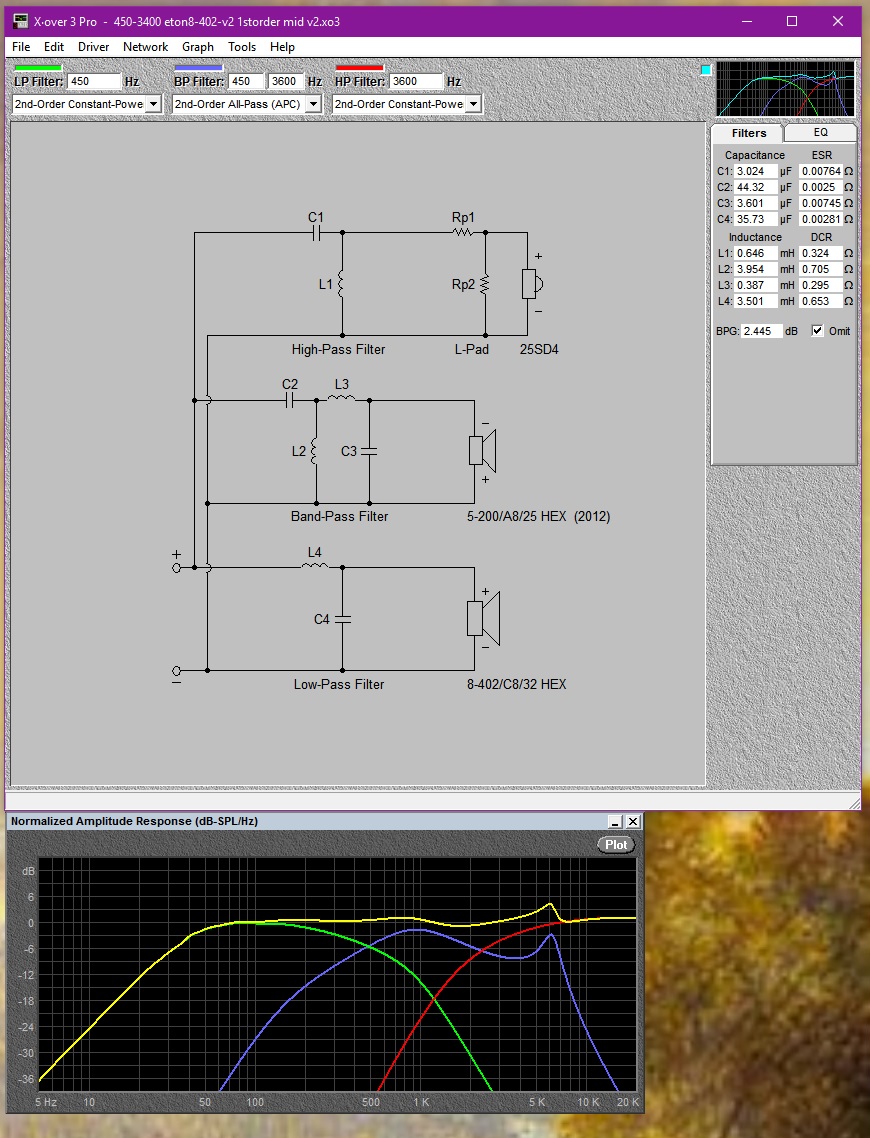

Ok,
So I did some tweaking, and came up with these two designs.
1st thing is there is now a .65mH coil on the tweeter instead of the 1mH.
I cannot move the resistor on the midrange in the software to the input, but if I omit it the peak around 5k is still there(2nd attachment/design)...could the reason be these are factory specs instead of measured?
These designs look pretty flat, and I know one can't tell till I build, measure and test, I am just wondering if this may be better that a pre-made option...and as a place to start.
Again thanks for your help getting me started in the complex world of crossover design.
I will get measurement tools(DATS) soon. I just want to know if it seem like I even have a grasp on this stuff...

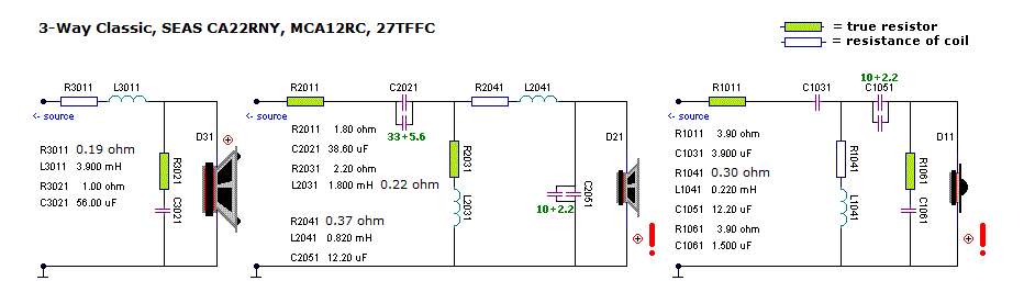

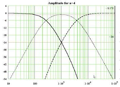

The target Steen Duelund curve for a classic three way is shown below. This actually works at every level including phase. Polarity of drivers is usually best modelled.
Troels Gravesen has two incredibly good and educational projects here:
SEAS-3-Way-Classic
SEAS Kit 503

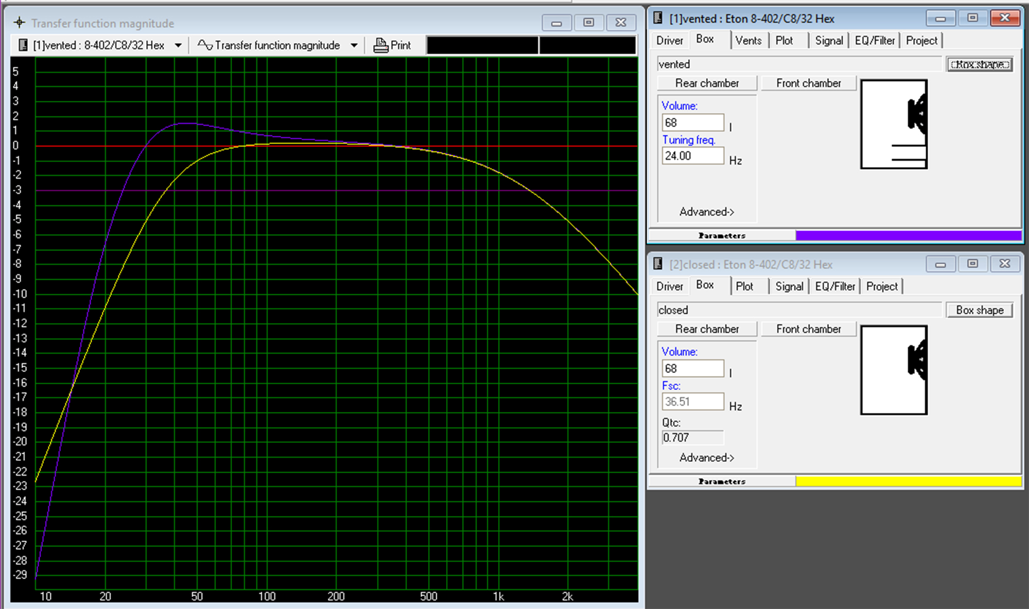

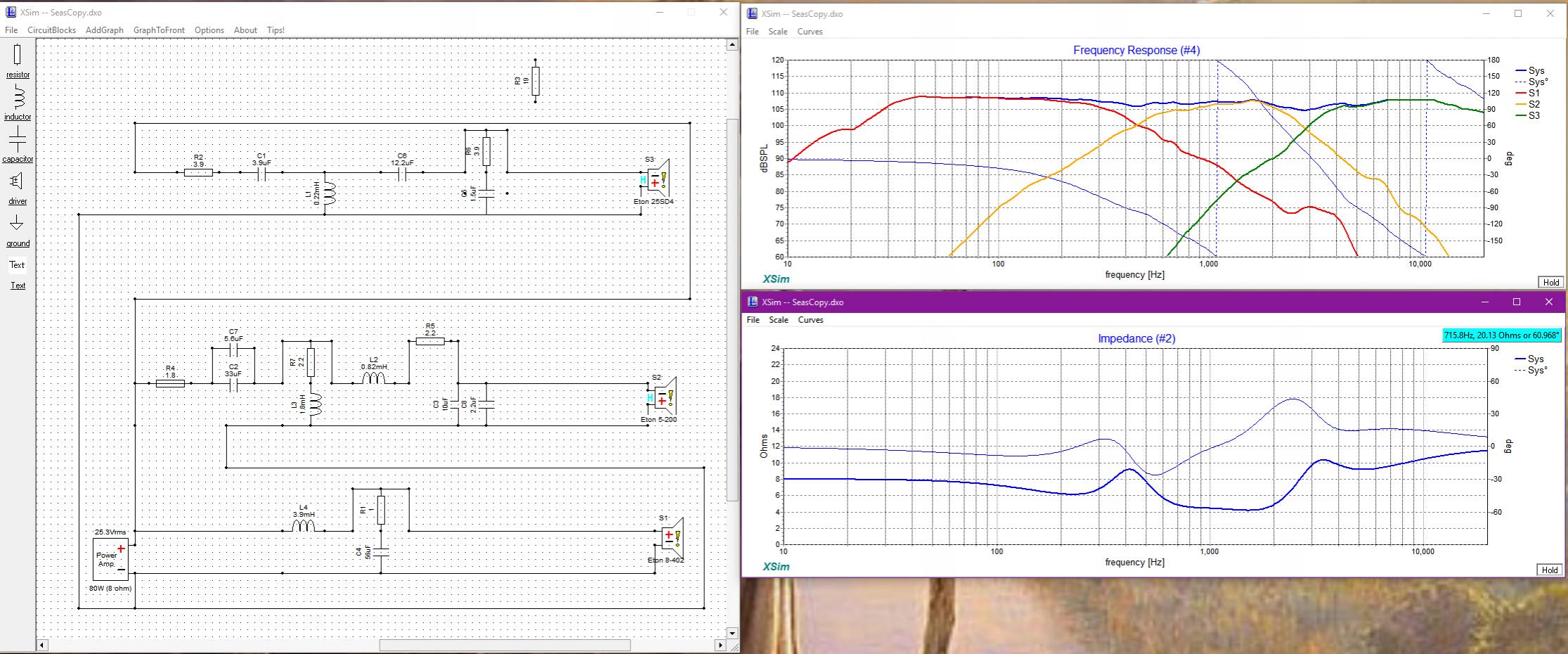

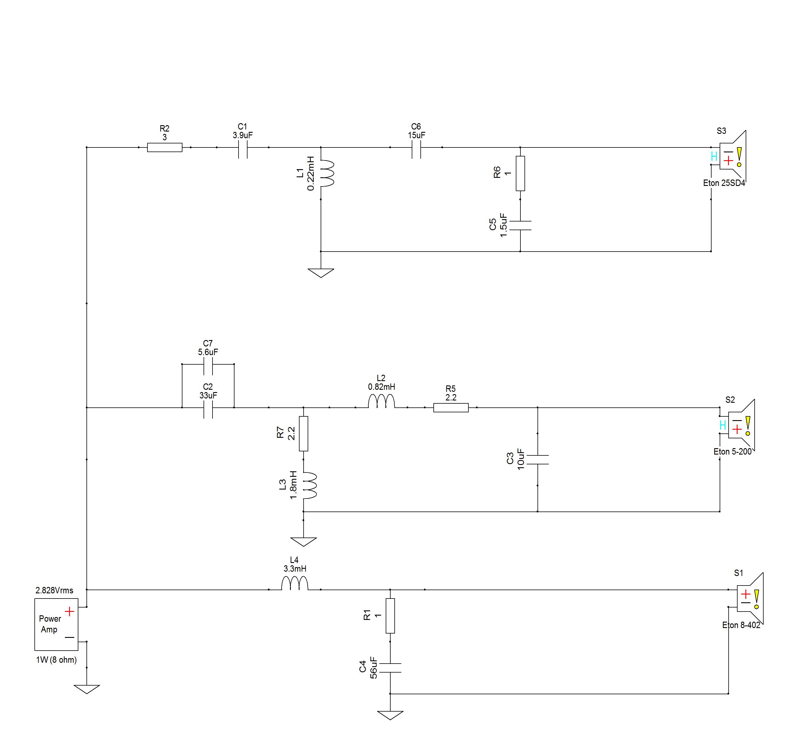

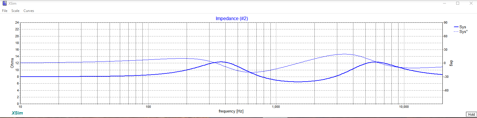

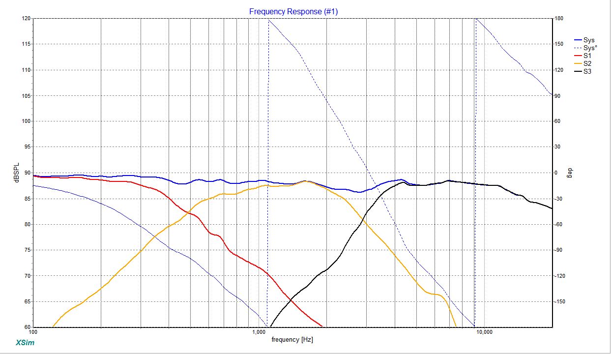

OK,
I decided not to take a break...
First, I would like to say thanks to all of you who kept suggesting using a different program for crossover design, and using FRD files.
Giralfino, when I have more time I will simulate in cab response, May be a few days till I read/understand your great links!🙂

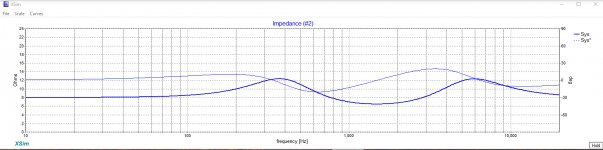

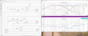

I used FPGraphTracer and traced all manufacturer driver responses, and imported them into X-Sim.
The manufacturer's Woofer FR data sheet ended at 300hz! So I used my box design to estimate response below 300...So the attached graph's woofer response may reflect this(10-20hz).
I then took the values from online generic crossover designers.
I used 500hz and 4000hz for the crossover points.
I also did not put the l-pad on the tweeter because it looked flatter without it(the resistors on top of attaced image 1).
Right now I am not so concerned with in room response because I am going to build a proper studio someday🙂.
I did attach the current design from X-Sim along with my box design I did in WinISD, with example of a sealed box(in Yellow) and a vented box(in purple).
So here's the questions:
1. Should I use the impedance from the manufacturer specs at the crossover points, or just 8ohms?
2. And how does all this look? I am still learning X-Sim, and I think I got this mostly right.
3. The EBP of the woofers are about 50. Eton said they would work in either vented or sealed, what do you think. I am using with a 12" subwoofer, box tuned to 28hz.
4. I do plan on measuring the drivers with DATS when I get it, I just want to know if it looks like I am getting the hang of X-Sim.
5. Are there any suggestions of components to replace/change/omit in x-Sim?
Should I give up and pay some one to design it for me?🙁😕
I have been doing my best to keep up with all you suggestions but I have been rushing through all this to be with visiting family, that's why I haven't read all the links that were posted(I did scan through them all though).
Thanks!
SEAS-3-Way-Classic
Thanks for your help too system7.🙂
The picture of the metal driver speakers were my first project...And your right..they ring a little. That's my main reason I wanted an upgrade.
the Etons are described as '3 layer hexacone sandwich'.

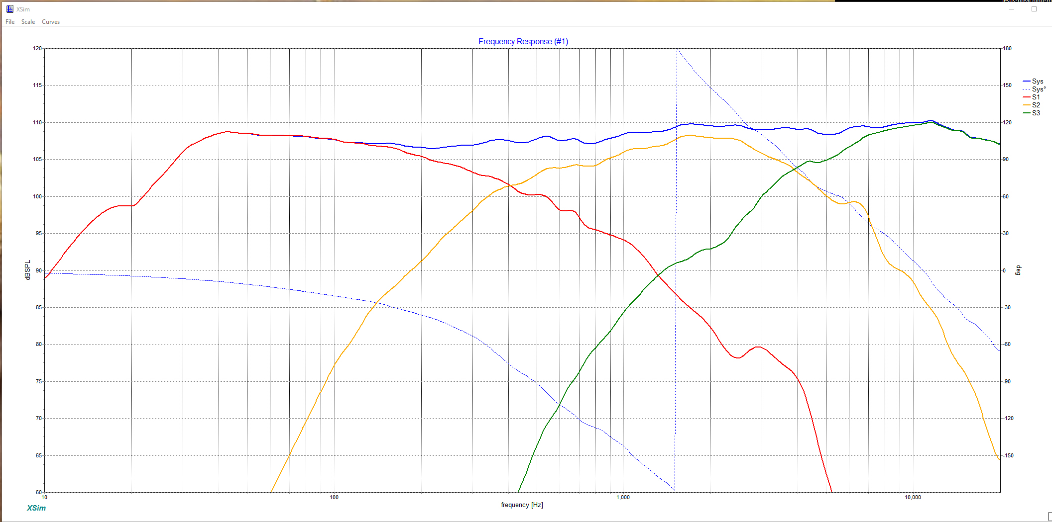

So I read the page about the 3-way Seas kit and modeled the Eton speakers with the crossover design/components on that page.
Attached is what it looks like in X-Sim.
Thanks again for checking all this stuff out for me. I learned a lot in the past few days. still more to read...🙂

I think you are cooking with gas with that Troels' crossover! 😎
We now know about target curves:
The 8" woofer is a standard sort of 88dB driver, suited to 30L closed box with a Qts of 0.47. Inductance Le is an easy 0.75mH.
The 5" mid is Le 0.55mH, so quite straightforward again. Qts 0.37. 86dB SPL. Perhaps in 5L. Looks flat enough.
The tweeter is an 89dB industry standard.
I reckon Troels' crossover will be fine. Maybe some tiny level adjustment with resistors. But the right idea!

Thanks! system7, you have given me hope!
I lowered the values of the resistors on the tweeter, from 3.9 for both R2 and R6 to: R2=3ohms and R6 1ohm
I changed C3 on the mid from 12.2uF to 10uF. (seemed to flatten out the mid a bit.)
And changed L4 on the mid from 3.9mH to 3.3mH, which seems to add a bit more bass end(to compensate for baffle step loss.)
I also cleaned up my schematic.
So do these look like good changes?(see attached pics...) It seems pretty good to my beginner mind. (flat, with gradually more db on the woofer)
-Jazz

The bass balance is always a bit suck it and see, IMO. The wall does reinforce the bass, so less BSC is needed. Nobody in their right mind uses the full 6dB boost.
Let's hope Troels has got it right. I'd suspect your Le 0.75 bass is lighter than his SEAS woofer. So you put them by the wall! But yours is also a closed box driver, so no port needed. 🙂
Have a look at the impedance on your crossover. Above 4 ohms with no alarming ripples we hope.
Your tweeter Zobel is way off at 1R/1.5uF. I'd try 7.5R/0.68uF. You can move resistors round a mid filter to raise impedance too. Try them at the front. All good fun.
