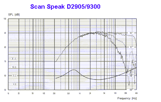

Well, let's take a look at the charts. The crossover in #3 contains a D2905/9300, while you have a D2905/9500. Both ahve the same VcL and both have the same DC resistance. The 9500 has an Fc of 550, the 9300 has an Fc of 650. Electrically, everything seems either identical or very close.

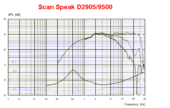

Here is your tweeter, the 9500:

The crossover frequency of choce #3 is around 2K Hz. Therefore, the region of most interest for our purposes is 1K to 4K Hz.
In the 9300 tweeter, the impedance is 9.5 ohms at 1K, swings down to 6 ohms at 2K and is at 5.5 ohms at 4K.
In your tweeter, the 9500, the impedance is at 8 ohms at 1K, swings down to 6 ohms at 2K and is at 5.5 ohms at 4K.
Both tweeters have identical inductance and DC resistance. I would be very, very surprised if there is any big difference in phase with so much being identical or very similar.
I therefore suggest you that you plug your tweeter into the crossover of #3 and you should be all set.
