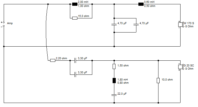

I can't see the images, but anyway it is not clear what you did apart building some new boxes with new drivers. Did you change also the crossover? All the properties you are referring to the drivers are from the combo drivers + crossover. There is no sense in swapping drivers and retain the original crossover, thinking that new and improved drivers will work better than the original one with a crossover that is tailored to the original drivers, unless of course if the new drivers have very closely FR and impedance of the old ones.

I didn't touch the woofer and the cabinet, those are original. I replaced the midrange+tweeter to Seas. Yes, I also changed the crossover to match with the new drivers.
