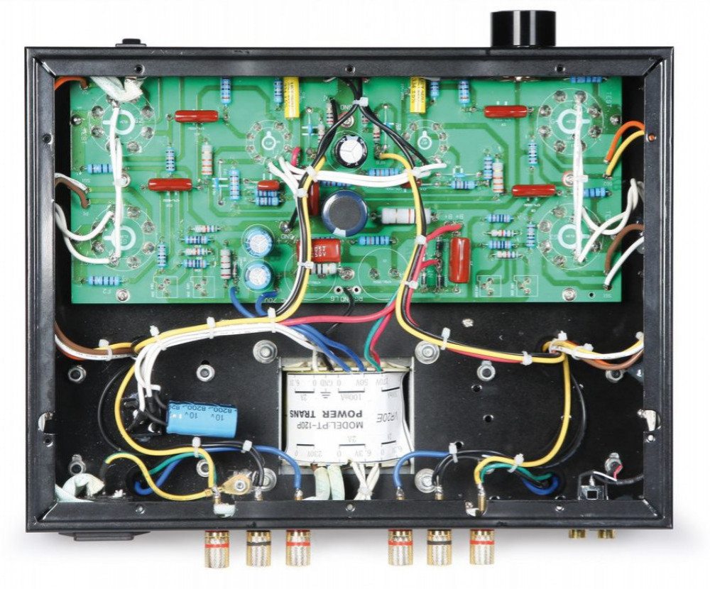

This picture might suggest that there is PLUS, MINUS and ADJUSTMENT around tube. "Fixed" bias.
Why don't you ask the distributor for a schematics ?Dynavox VR-20 is vacuum tube integrated amplifier with power: 4 x 6P6P, pre: 2 x 6F2. Outputting 2x10W. If the tube types sound strange: 6P6P=6V6GT 6F2=ECF82
I wonder how biasing is sorted with it. Is it cathode biasing?

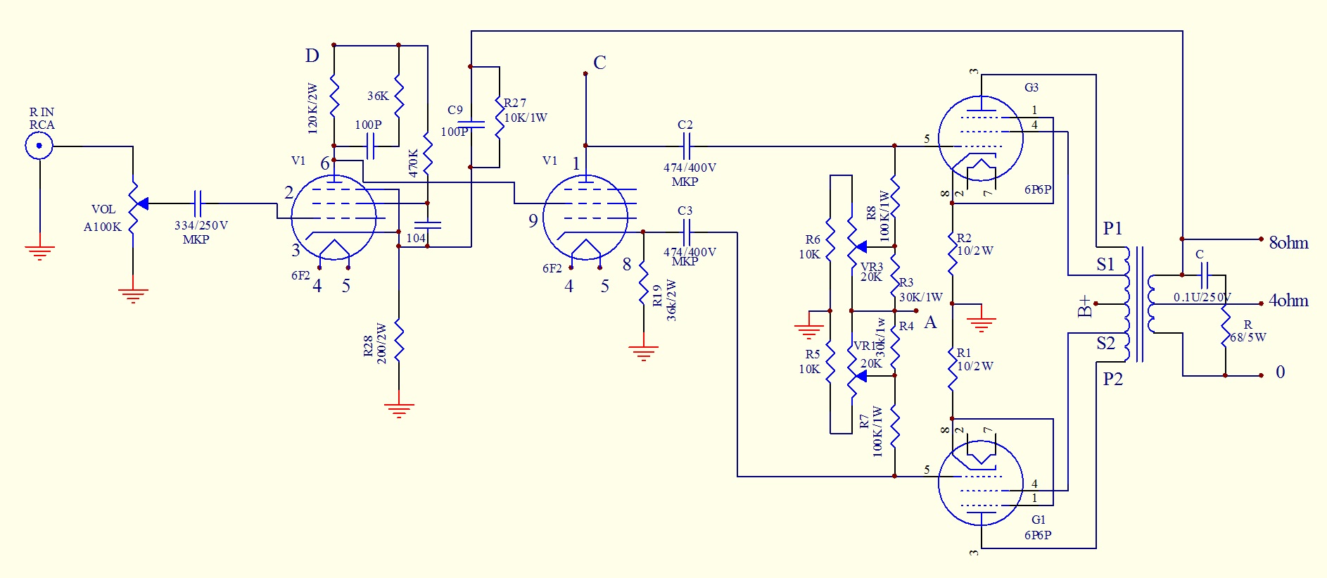

The Chinese power tubes are biased between 280-300 mV. I would have used this setting to new tubes, but no hurry in here.

Even stranger that the concertinas resistors are unequal , just like the VR70Strange that the Concertina's plate resistor appears to be at the PSU PCB !

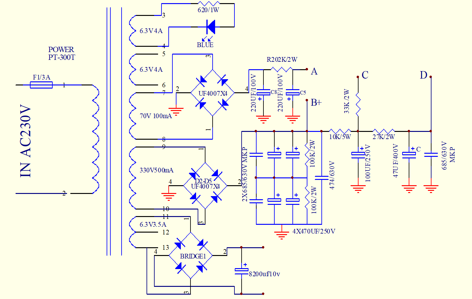

Yes, that would be a good starting point. ( 30mA / tube )Uwe from Sintron(/Dynavox) was kind enough to send me some electrical schematics of VR-20. The Chinese power tubes are biased between 280-300 mV. Can I use the same bias for new tubes?

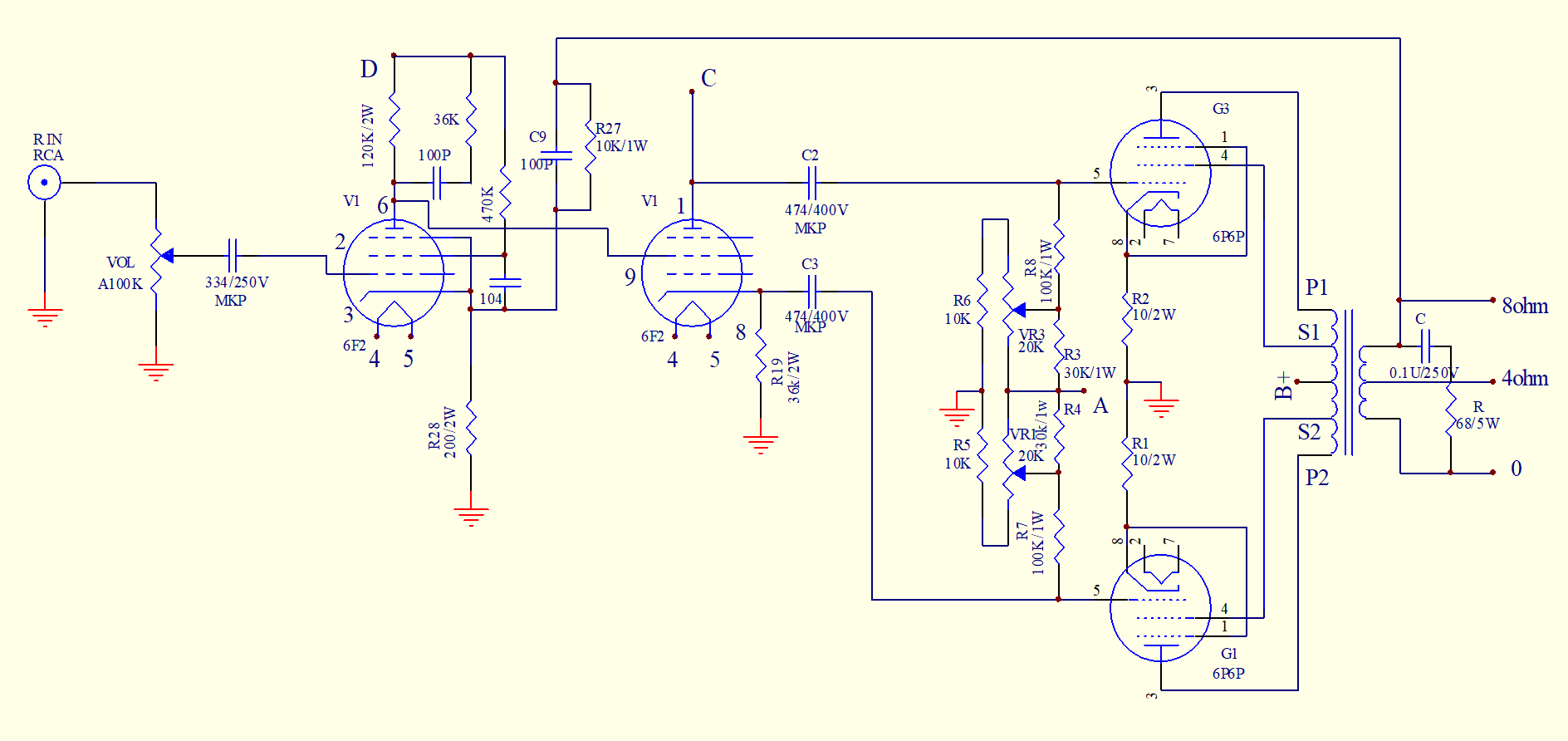

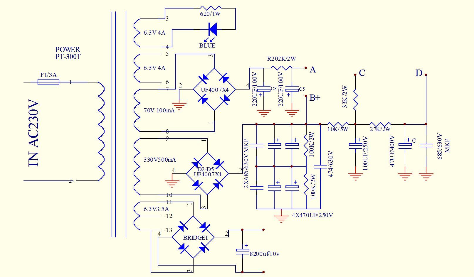

Apologies of posting the electrical schematics again. I reviewed them, used PNG instead of JPEG and little better resolution.
Uwe from Sintron(/Dynavox) was kind enough to send me some electrical schematics of VR-20. Look at the attachment pictures.
Deliberately increased 2nd harmonics, maybe?
Is it 33k+36k resistors?
You spot it ! YesIs it 33k+36k resistors?

A concertina IS balanced by itself, all you need is equal resistorn plate and cathode.The concertina resistors are not equal, probably because in signal and out signal are balanced (fine tuned). You also can mess with this to give a crunchy distorted sound.
There is a video of this:
YouTube
See it like this, the same current has to pass cathode resistor, tube and plate resistor. Current X ohm = voltage
If resistors are unequal then the voltage across them will be unequal.
