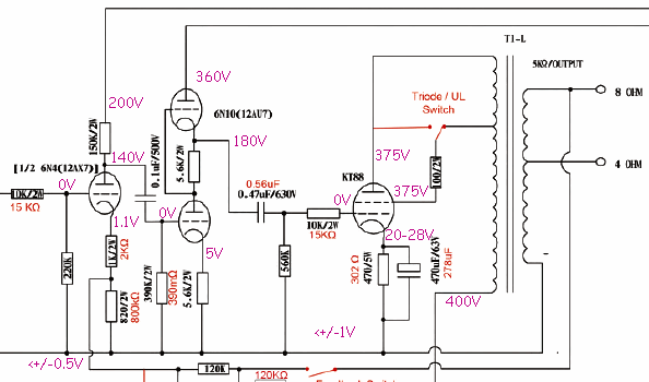

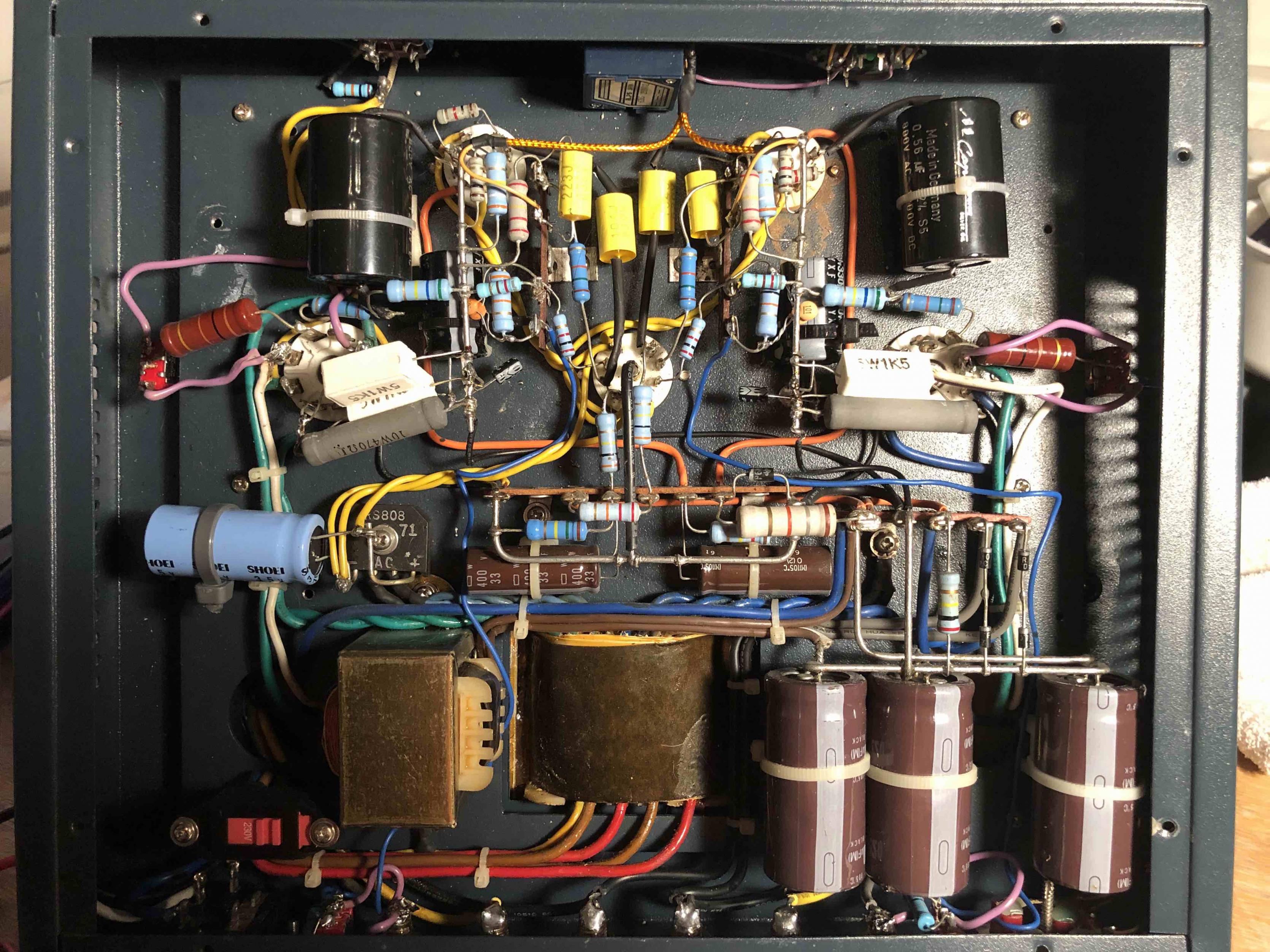

Hi, The 470Ω resistor has had a couple of 1.5K strapped across it and the capacitor in the 470uf position is a 330 with a smaller cap strapped across it to give the measured value. It is these last two components that I replaced as they were blown, like with like without consulting the diagram. Someone has deliberately made these changes I was hoping someone could suggest why🙂
I do tend to agree with wiseoldtech that the poor amp had some real bodging. The 1k5's strapped across the 470R will have been an attempt at increasing output bias current and hence power. Probably best cause of action would be to find the original schematic and start from there. I suspect you will need new KT88's anyway.

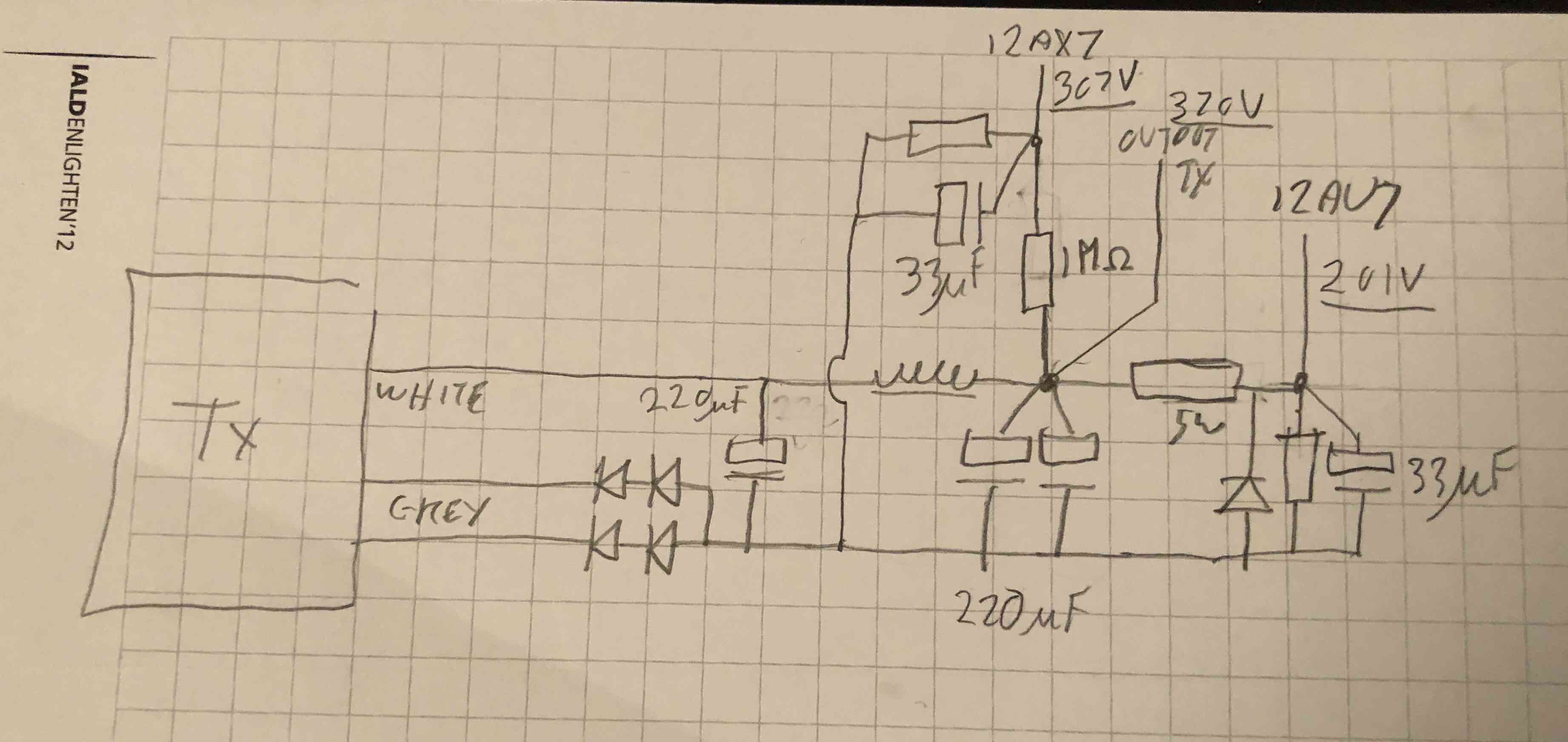

So thought you mite like to be brought up to date with this project. Following advice above I have mades some changes to the amp. I have reverted the resistor and capacitor on the KT88 cathodes to the original schematic values and changed the grid resistor to 220K from 560K. This brought the amp back to some semblance of life , however all the valves were FUBAR. There was lots of distortion, crackling and channels dropping out. I have changed them out for a set of Chinese/Russian valves I got with the amp that I guess were probably the ones originally supplied. The amp now works and sounds ok at low listening levels but if you turn the input up it al gets very distorted.
I tried the triode as well as the UL settings with no discernible difference. The different feedback settings also made little difference to the distortion though did change the sound level.
I also experimented lifting the diode in the powers supply and re-connecting it to the resistor feeding the 12AX7. This made little difference, dropping a couple of volts and the supply to the 12AU7s lifting by a couple of volts, so I put it back where it came from for now.

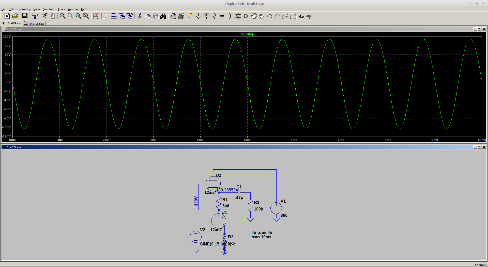

A 600V rated cap (say .47u or even .1u) works as a probe, if you're wanting to isolate the DC from your scope. One leg to the scope probe, use the other leg to probe. One hand behind your back always when working on live tube circuits, so you don't accidentally electrocute yourself.
Well thats good news. So turn off the feedback. Apply 100mV 1KHz sinewave to input see what you have at each grid of each valve (where there is little DC). Also the cathode of the KT88. You you also record the voltrage at the 8R output with speaker/resistor connected.
Other thing to check is the output transformer. To do this disconnect from unit. Apply 1KHz sinewave from sig generator through 1Kohm to primary of transformer. Measure voltage across primary with scope. Should be virtually same as voltage across sig gen output. Measure secondary voltage that should be sqrt(8/5000) times as big. Short secondary. Voltage on primary to drop to virtually nothing.
I did a bit of 'scoping today and found a seriously dry joint, now that is resolved the random channel drop out and distortion is fixed. I tracked through with the signal being fed from the input. Apart from the input to the first stage where the signal seemed noisy that I would think was the most sensitive setting on the 'scope. All the rest of the traces looked clean and undistorted right up to the transformer outputs.

Caution:
During the charge time of a series capacitor to the scope input, you will get the full voltage of the circuit you are probing, and that full voltage will be applied to that scope input.
No matter how brief that charge time is, many scope inputs will be killed.

The X10 setting and capacitor input settings are recommended.
And worthy scope used properly should not experience a problem.
A 10X probe (9 Meg Ohm in series) and a 1 Meg Ohm scope input.
If you use the scope internal AC coupling, most scopes rate that combination at 300VDC max.
Using the same 10X probe and a series capacitor does not change the transient voltage that will appear at the scope input.
There is a 100X probe, 9 Meg series, 110k parallel, and the scope input 1 Meg.
That keeps the scope input safe for much higher B+, plate circuits, etc.

Hi again! Post 1 has a pdf of where I started with a not working amp somewhat modified marked up over what I believed to be a manufacturers schematic. Post 13 has a diagram of the actual power supply connections and a photo of the insides. Post22 is where I am now. Along the way I have binned the golden lion KT88s as they were definitely dud. I also changed the AU 7s as they were also causing audible distortion . I am currently running no name Chinese valves that came with the amp and I suspect were the originals.
