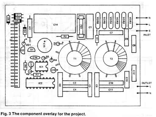

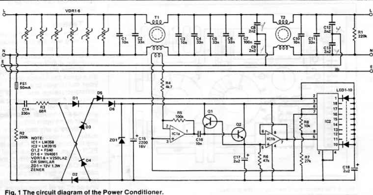

I am attempting to assemble a mains filter from this web site
Building a mains conditioner.
Trouble is that I cannot find parts for Q1 and Q2 ,
Can anyone help and advise if this part is correct or even close 😕

No, that part is not even close. Q1 and Q2 are in the signal monitoring section where the voltage delivered to Q1, 2 is limited by ZD1 to 12 volts. Q1 and Q2 are bipolar NPN transistors according to the diagram and are not NMOS transistors like your parts link. You need a low voltage small signal NPN transistor something like a 2N3904.
http://www.fairchildsemi.com/ds/2N/2N3904.pdf
