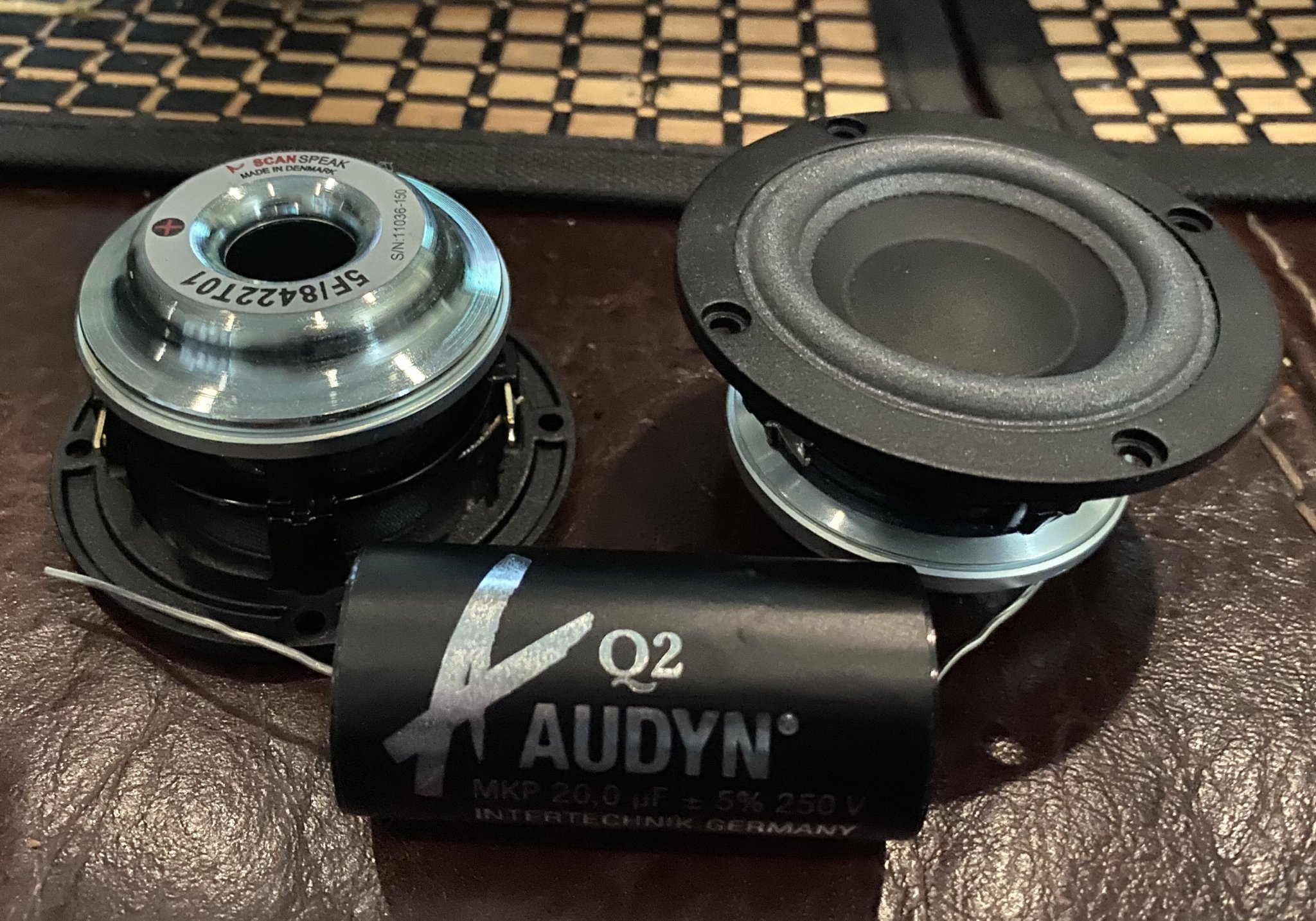

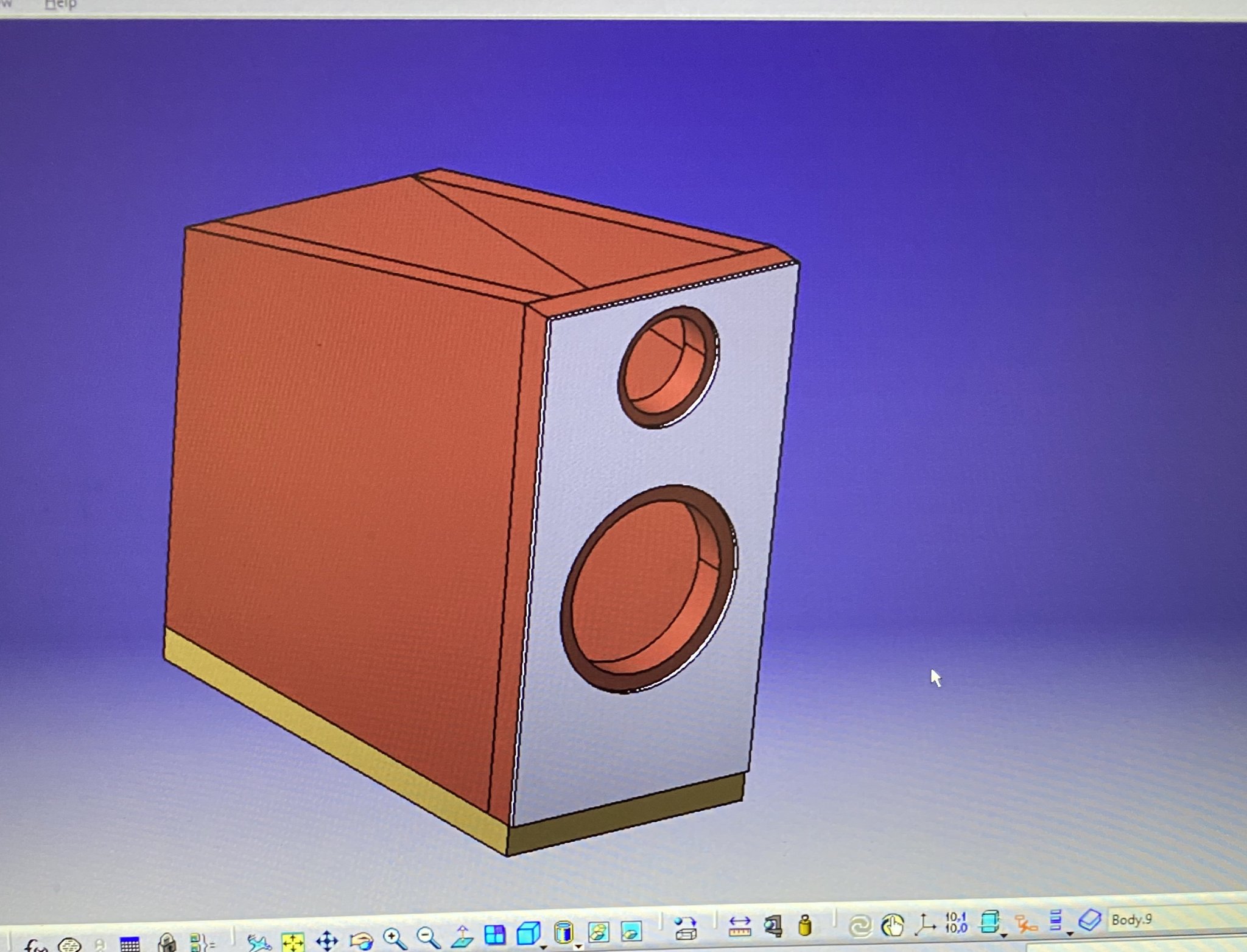

I am working on a set of desktops using a 2" Scanspeak and a Kartesian SUB120_vHP-8. Going to cross them at 700Hz and leave the top baffle open. I will close the baffle later if I don't like the sound.

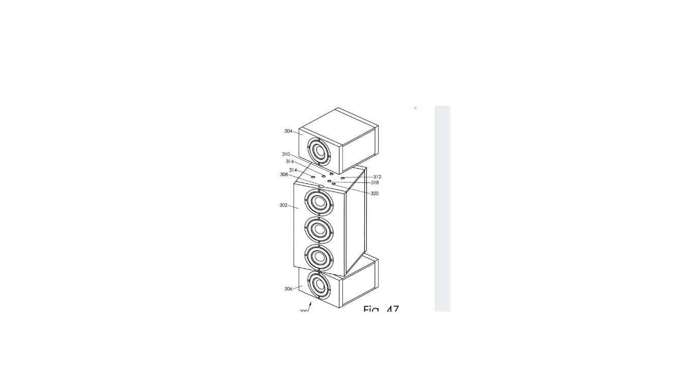

I'm going to build an enclosure like this that deals with the beaming issues by turning the 2 outer drivers according to this thread by Patrick Bateman.
https://www.diyaudio.com/community/threads/an-improved-array.301259/
