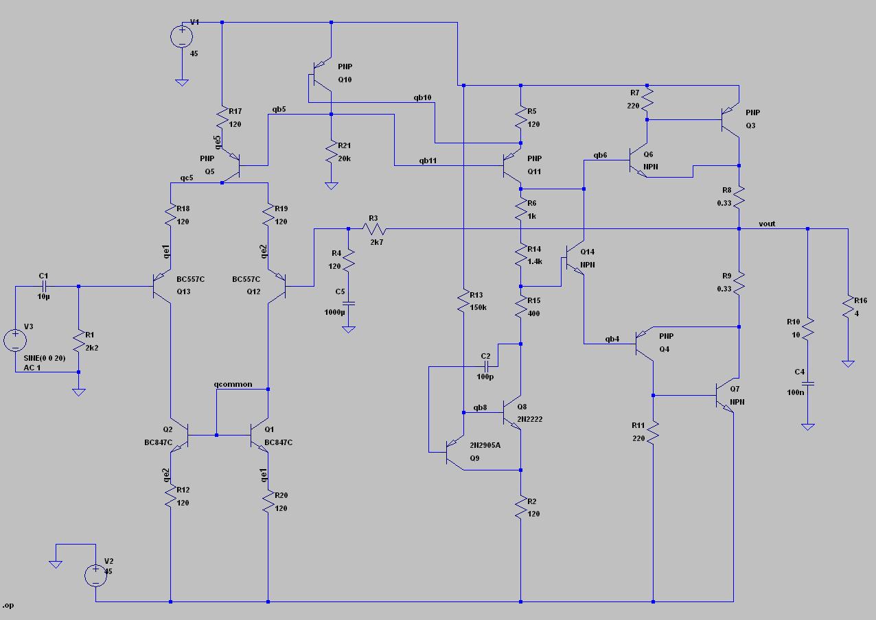

Hi All,
Just wondering if I could get a couple of pointers regarding the balance of current through the two diff amp arms in this fairly standard design I'm working on. I am only starting out at amp design and I have Douglas Self's book handy but I can't seem to work out why the current is significantly different.
From spice (LTSpice) it is saying R12 & R20 have equal current at around 220u each. Current through R19 is not much different. Problem is R18 has around 300u which goes through Q13 and then around 80u is shunted off to the Vas base Q8. Is this normal? Should I just up the total current through the two arms so as to make the difference less significant? I understand there might be a few issues with this amp (there usually is) and so any suggestions would be appreciated.
to get the balance you want and what Self says is important to get the best out of an LTP you need the currents in R18 and R19 to be identical.
With a mirror load you cannot trim R17 to balance your currents.
Nor can adding a degeneration resistor to the VAS work to improve balance.
Look at your mirror.
Base current for each of the two transistor is ~ Ir19/hFE and [Ir18-Ibq8]/hFE
Both these base currents are supplied through R19.
If the total of the 2base currents exactly equals the base current going to Q8 then you will find that your currents are balanced.
Look at hFE of the VAS to determine what is needs as a base current.
Work from there.

Thanks for your help Andrew.
I realise now that the Q8 (Vas) base current was required to be 80uA if I continued to use the default NPN transistor in LTspice which had a hfe of 100. Changing to a 2N2222 (the first one I saw in the transistor library) with a much higher hfe lowered that base current to around 33uA. This was for a Vas collector current of 8mA (I have no idea at the moment whether this too high or low).
This change lowered I(R18) and after I added your suggested 47k resistor from mirror current transistor bases to negative rail it pulled an extra 10uA from R19.
This has brought the two currents to just below 10uA difference with I(R19) still the lower of the two. =not bad
However it seems to me when I go ahead and change the mirror current transistors from the default npn (hfe=100) to higher beta ones this differnece will be made larger again!
Seems to me these are my options to lower I(R18) and/or up I(R19):
- Pull less current through the VAs collector
- Make your suggested resistor pull even more extra current from R19 (is there some limit here?)
- Make the hfe's of Q1 & Q2 (current mirror) lower as to pull more current from R19(this doesn't seem like the way to go for good current mirror performance but I have no basis for this argument!)
- Read page 125 in Self's book and realise that an emitter follower config for the Vas stops this problem!
I tried the the emitter follower method for the Vas and it indeed pulled much less current from the Diff Amp arm and thus I have been able to achieve current balance! Yay!
Now to work out what devices to use taking into consideration gm of the diff amp, dominant polls and all that gain linearisation fun.
This amp design thing is actually quite fun once you start getting somewhere!

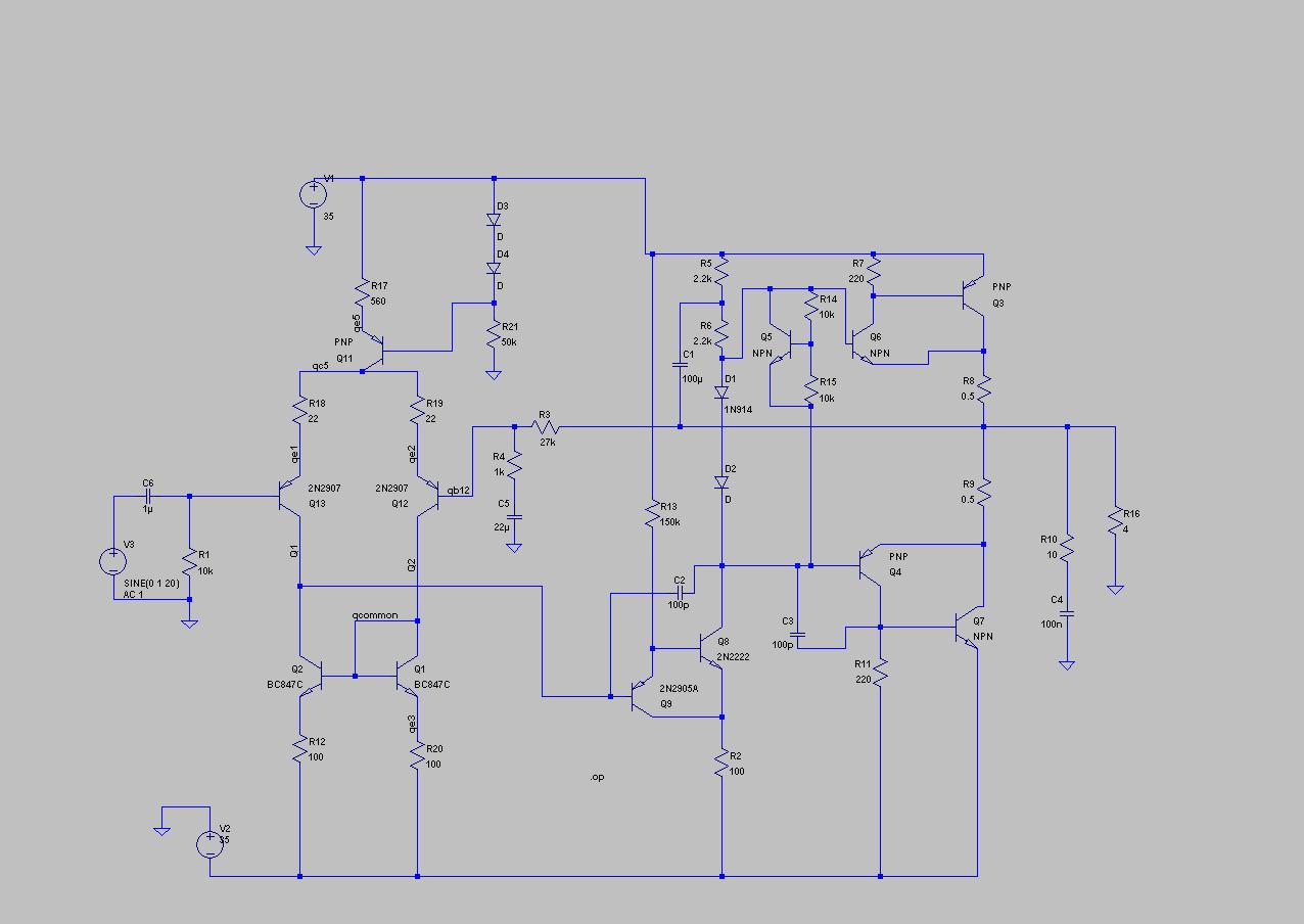

You are right, if there are designs without dissipation limiting resistors in the collector lines from the differential amp (like attached design from NAD 306 - and consequently dark burned PCB aera arround Q401/Q403 cause +/-80V and high dissipation).
But I am right, if there are still such resistors in use (20 - 25 volts Uce is a good choise).
You get now additional advantage cause the possibility to use input BjT's without "MPSA-42 like" high max Uce voltage - each 40V Uce type can be use.
By my modification work at high voltage audio amps I still enhance the current arround 3-10 mA/each half of diff input pair (independend of the transistor types) and introduce the resistors in the collector line - this will get still better sonic results so as better offset stability, if no offset servo is present.

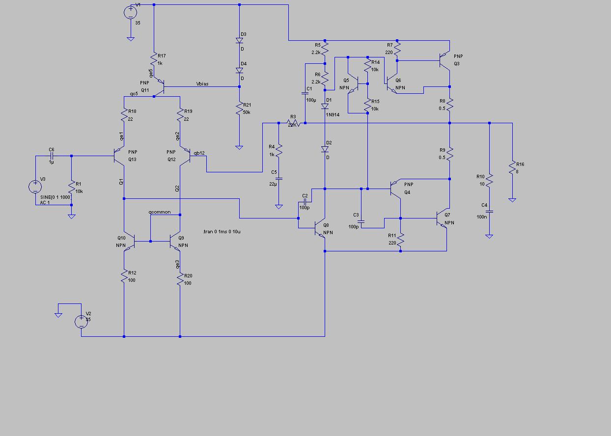

you have shown a folded cascode on half the LP.
The voltage at the emitter of the cascode is ~1.2V less than the supply rail. This is the voltage at the collector of that half of the LTP. This determines the Vce of the LTP. The other half of the LTP has full rail voltage defining Vce.
How does the dissipation in the two halves of the LTP stay the same if you increase the tail current?

I recall an paper on exactly this subject (Application Note from TI, NS, or Motorola or an JAES article), but I forget, where I found this.
Sorry for the delay, I have been building this amp.
Sounds quite good but getting a weird distortion at 10KHz and above when running through 4 Ohm load. It turns into what looks like a triangle wave when it gets to significant power (40W) and above. Kind of looks like a slew rate problem but that doesn't make sense to me.
Maybe my problem has something to do with working out the gm of the diff amp because I am l little unsure of how this is done properly.Is the gm formula for the diff amp just the same as working out gm for the input PNP? How does the emitter degeneration emitters affect the gm? I thought gm was just IC/VT but thats probably wrong.
Also it maybe it is that I have not put any thought into Vas collector loading. A little hazy on this too at the moment.
Anyway this version has 3.2mA running through each arm of the diff amp. I increased it to help drive Cdom at higher frequencies and better slew rate(so much for that idea!).
Any thoughts....sorry if I am straying a little off original topic but it is still diff amp discussion😉
Ok....on second test with above the problem has gone! Must have been my freq generator doing something weird.
something I did notice that I can't explain (yet) is that the amp works right up to 150kHz at very similar gain. I thought the Cdom= 100pf pole was supposed to roll off the gain after 20K.
Strange, although altogether probable considering my lack of knowledge of HF gain/dominant pole calcs.
Yes should be there sorry about that.
I must have saved before I put that back in after some experimenting.
Thanks for pointing that out!
