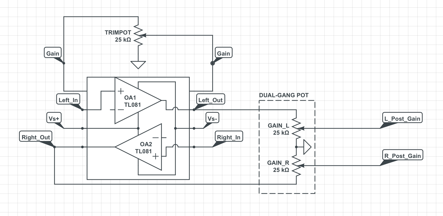

There is probably a really elementary solution to this, but who do I add a trim pot for both left and right without making the signal mono?
I haven't been able to find a 2-gang PCB trim pot and I don't want to have a separate trim pot for left and right.

Any ideas about the 'trim knob' situation and how to trim L and R with just 1 trim knob?

No idea.Any ideas about the 'trim knob' situation and how to trim L and R with just 1 trim knob?
The way I understand your trim pot requirement it is just another attenuator. For single ended signals you can use a dual pot. Balanced signals would require a quad pot that must be much more tightly matched than are commonly available.
Since the trim pots are for basic system level matching it might make sense to switch an l-pad attenuator. For example, to drop a pro level signal to consumer level, just drop the appropriate number of dB. To bring the iPod input up to consumer line level, add a few dB.
I think the best idea then would be to use an op-amp similar to the LM386 which has 2 x GAIN pins between which one can place a resistor in order to determine output gain. However, unlike the LM386, I would need an op-amp with 2 cop-amps within the same package, but which are both controlled with the same set of GAIN pins. In this way, if I placed a 1-gang trimpot between the pins, I would be able to change the gain of the stereo signal simultaneously. Then of the outputs, I could have a dual-gang pot which would then be my GAIN knob - on the front of the unit.
I have attached a screenshot to give a better idea of what I mean.
So - do you guys know of a suitable op-amp for said purpose? And if not, would you suggest I ask the rest of the diyAudio community with a new thread requesting suggestions for op-amps for this purpose?
