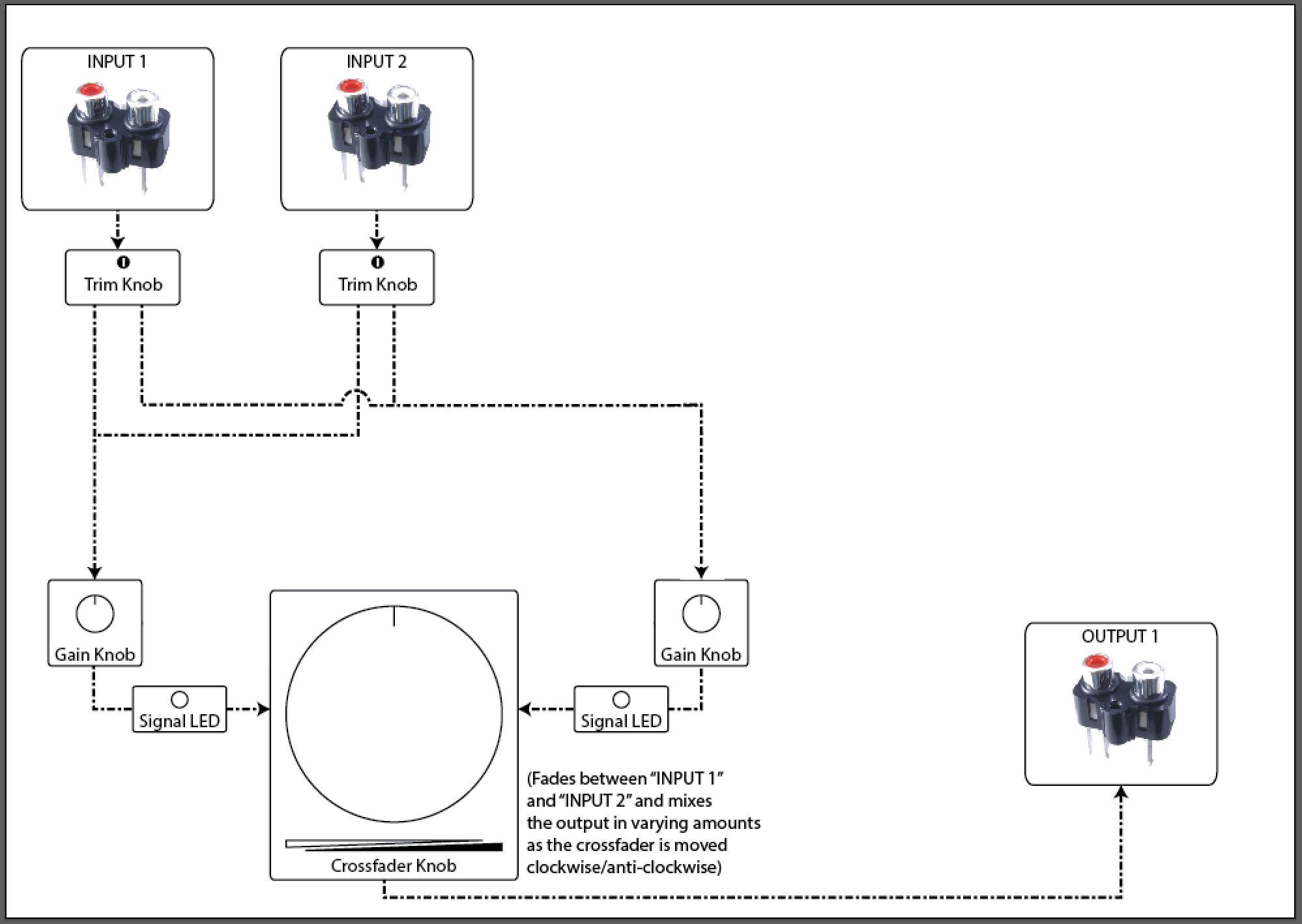

Hi guys,
This is my first post here and also my first DIY audio build. Looking forward to the challenge.
I am looking to build a relatively simple mixer that takes 2 x stereo line level RCA inputs, run them through trim knobs, gain knobs and an LED for each input and then run them through a rotary crossfader and out the other side as a line level RCA output.
The most complex bit in the whole thing is the rotary crossfader, but I figure I need a 4-gang log potentiometer somewhat like this: http://www.mouser.com/ds/2/54/TD90-777943.pdf
I'll also need the following:
3 x stereo RCA PCB connectors
2 x 2-gang trimpots
2 x 2-gang potentiometers
2 x LED
I want the unit to be able to take inputs from DJ mixers or iPhones or iPods for instance and send the output to a power amplifier.
I have the following issues:
- I don't know what value pots I need to get for any of them. Do I need 100k Ohms, 20k, etc? What is going to get me good quality audio output?

For driving the led you need some sort of circuit. There must be some opamps or transistors.
I want to use the audio input to drive the LEDs. But yeah - I will need something like a resistor right - so that the LED's light up at approximately 90% of full input voltage.
So if consumer line level is -10 dBV, and peak amplitude is 0.447 volts, then 90% of peak would be .4023 volts. Is that correct? Am I going about this the right way?

Input and output impedances
Just doing some more research now.
So, as I understand it, the input impedance needs to be much lower that the output impedance for current to flow through the circuit. Is my understanding correct?
And then, the input impedance needs to be lower than then output impedance of whatever is going to be plugged into this mixer, for instance an iPod. But that shouldn't be an issue should it? It will be quite easy to make the impedance of my mixer as I want it.
The issue seems to be: The output impedance of my mixer needs to be lower than the input impedance of the power amplifier that my mixer is going to run to.
How do I make the output impedance of my mixer as low as possible but still keep it passive?

As this is DIYaudio.com, let us assume for the moment that you want to do it yourself. Do you understand potential dividers, and volume controls? I mean understand, not just know that they exist. You know how to calculate input and output impedance of a volume control? If not, that is where to start your reading.
Your understanding of impedance requirements is mixed up. Generally you want the output impedance of a stage/device to be much lower than the next stage/device's input impedance. The higher the output impedance, the more the interconnect cable's parasitic capacitance and the next device's input capacitance will interact to form a low pass filter. This could lead to rolled off highs.
So, yes, the output impedance of the mixer needs to be low to drive your amplifier's input. The issue with using your passive trim pots, master gain and cross fader (why do you want three controls for adjusting level of two sources?) is that each one effectively increases the source impedance seen by the amplifier. A better engineering solution would be to insert an active buffer after each pot, and depending on the length of the cables between sources and mixer an input buffer. A buffer is a circuit that typically has a high input impedance and a low output impedance. It can be as simple as a single transistor emitter/source follower or an op amp set for unity gain. There are also integrated circuits designed specifically as buffers.
Of course this gets you into power supplies and active circuits, but you need that anyway. That's because to be bright enough to be useful the LEDs would need too much current to be driven passively and they would impact the waveform. You need a high impedance buffer to drive them.
Take a look at Rod Elliot's site for circuits that you can use to meet your design goals. High Quality Sound Mixer
Ah right. Thanks for clearing that up for me. 🙂 You're a great help!!! They should promote you to General. 😉
I wanted the trim pots to set a good overall level for the inputs (at the back of the unit); the master hair for adjusting the level for like "Hey, it's too loud in here. Could you turn it down please?"and the crossfader for - well - fading seamlessly between the two inputs. All restaurants/bars I'm worked in, they have to turn the music off before the DJ starts playing i.e. no smooth transition between iPod and DJ and customers notice these things.

I can see your concept for input trim. What are your sources? Most modern sources are similar levels. While we are at it, why a mixer rather than source selector? Play along with your favorites?
The single transistor buffer is what is shown in 9.4 on your link. That's active. What's your objection to active?
You could power most opamp circuits from a pair of 9V batteries if you wish. There are also regulated power supply kits or bare boards available from a number of sources. The Super Regulator in the DIYAudio Store is probably overkill, but any of the EBay +/-15 V supplies will do for learning.
The peak indicator fig 8 Audio Mixing Console - Part 1 is a pretty basic circuit. It uses any dual op amp as a comparator - the resistors R1-3 provide a reference voltage. Once the signal exceeds that (either positive or negative) one of the opamp outputs goes high and turns Q1, which lights the LED. Q1 can be any general purpose NPN
Well, as this thing becomes more complex, my concept is changing. Originally I just wanted to keep it as simple as possible so as to get an idea of how it would work. But as things progress, it is becoming more complex (passive to active) to accommodate long cable runs, impedance differential, signal quality, etc.
So originally I just wanted 2 x stereo unbalanced RCA inputs. Now I'm thinking 2 x balanced TRS inputs - which would be able to accept unbalanced as well.
One input will more than likely be a DJ mixer, so that's +4 dBu and the other might be pro level or an iPod i.e. -10 dBV. I've read these definitions many times and still don't fully understand what they mean. But I know they sound - in terms of level - comparatively.
I no longer have an objection because I've become aware that it will have to be the route to go. I originally wanted to not have to supply a power source because that would make installing the unit sooooooooo much easier on-site. But that's clearly not gong to be an option.
I wonder how long the batteries would last for?
Wow - so now I need to add a power supply kit and a new circuit board into the equation? This is going to take me forever to build!!! I don't think I'll ever get it done. I have to add so many more components - and while it may seem elementary to you gentlemen, every new thing that I add, I have to research how it works and oftentimes that means going right back to high school maths!!! It's just an endless road to travel on.
