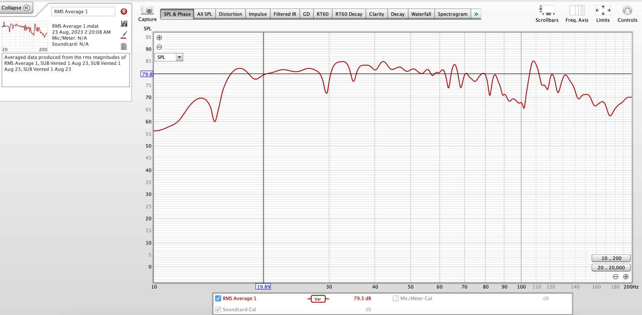

Your vertical axis is too much compressed to reveal any interesting details. If you see my graphs each major division in v-axis is 5db. Can you repost your response with same settings.
Also use only var smoothing in rew.
Few thoughts.
1. 7.5db boost at 20hz seems to be too much when you are already power limited by ported design.
2. The downside of using large boost is it's gonna mess up sound in other areas of room.
3. Some of the nulls from room response, cannot be fixed by using boost. Solution - delay/physically moving sub or adding additional subs/ room treatment.
4. Can you remove all dsp eq, delay etc and measure at listening position and as wellas near field near sub. I would like compare and see what your room is doing. From there I can interpolate your sealed response.
5. To start with, you will have really good sounding lows if you target within +-5db response smoothness. Don't overdo the boost eq. I would not boost over 5db unless you have ample headroom.
6. Adding more subs is never overkill. It will de-stress your whole system and reduce distortion as you will be running at lower output per driver. You could even remove bridging and run two subs from single amp.
7. Also post your time domain response. It will reveal how bad or good your room is.
8. Again I always suggest sealed sub for badly or hardly treated room. Achieving "perfect" lows in a average sized room is a huge investment of time esp. if you are doing for the first time. You could take professional help but that will cost money.
9. Having said that find the best position/delay for your sub and work on smoothing response further before investing in additional gear.

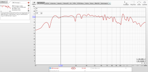

If I remove EQ and Delay, it would take all the sparkling magic away as I already tested it and didn't feel the low end (20hz to 30hz) without boost. Given its not dedicated HT sub, I felt the need for the boost.Your vertical axis is too much compressed to reveal any interesting details. If you see my graphs each major division in v-axis is 5db. Can you repost your response with same settings.

Graph now showing frequencies in incremental of five. The bandwidth of the dips are actually not that wide as its fluctuates between 2 to 3hz differences.

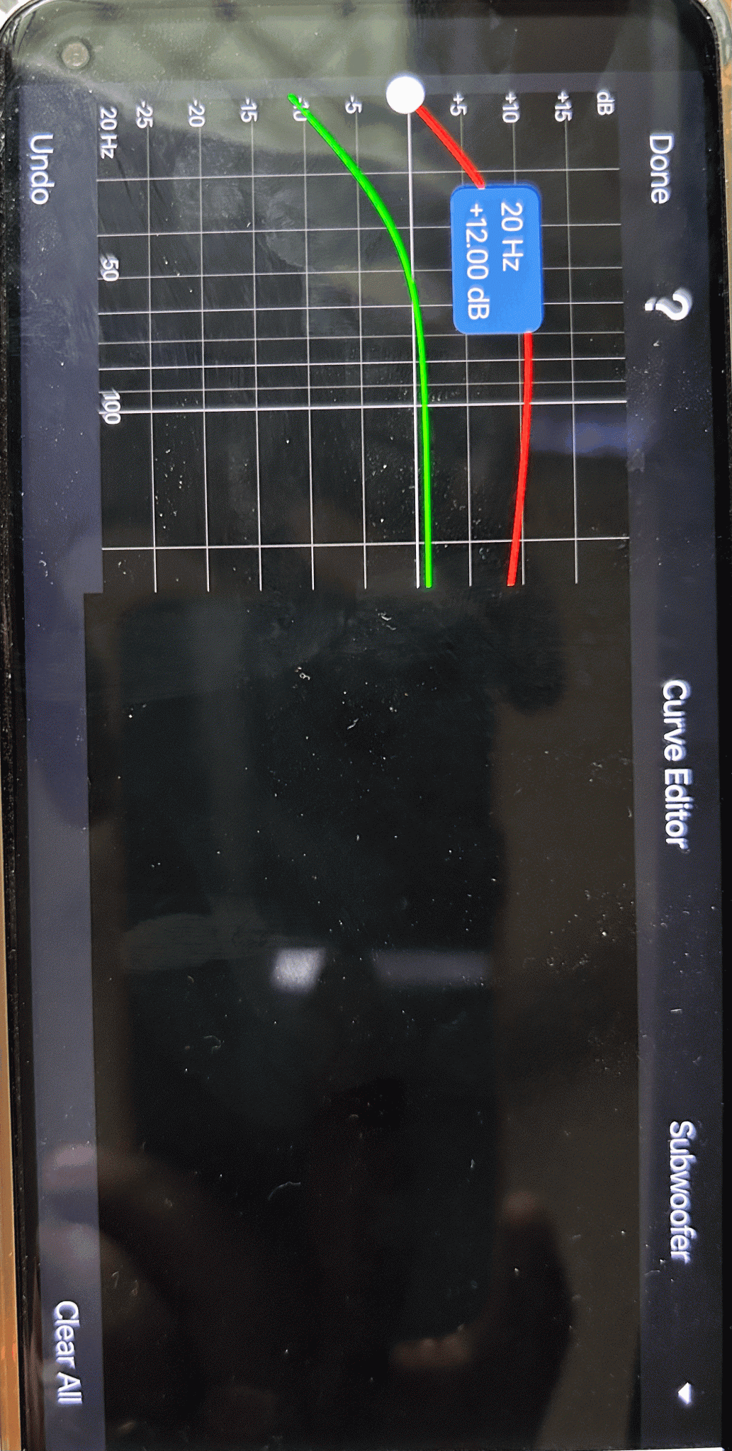

This is the default subwoofer curve (green) from Audyssey editor app. You can adjust the curve to your like and upload back into AVR. The max boost you can do is +12 db from 20hz and above. As you can see the curve roll off, no matter how hard you try you cannot change the smooth roll off. This is intentionally done as a universal way to work with every subwoofer.

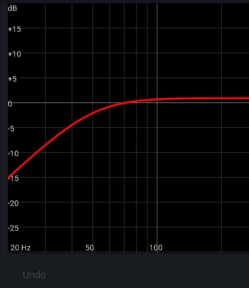

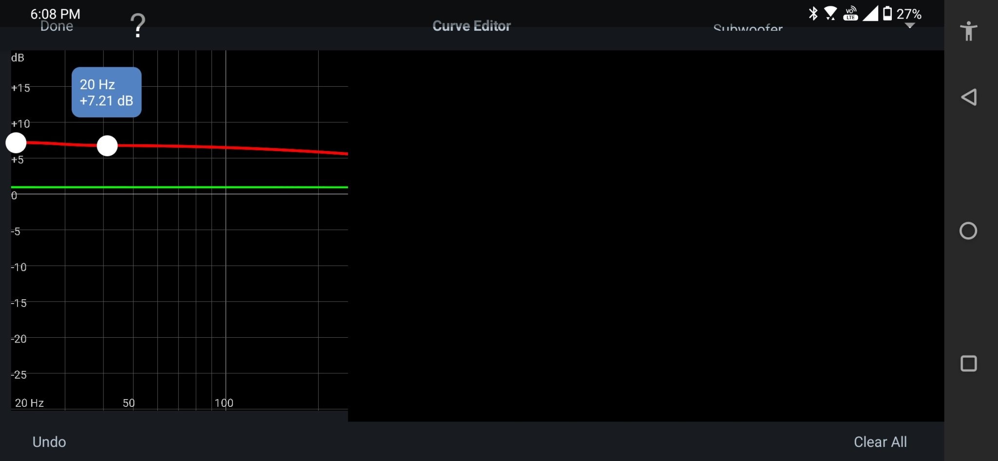

I use android. You see the default green curve is flat as opposed to rolled off on mine. What’s your version? 1.10.0?
I think the green curve is based on measurement of your actual speaker rolloff.
For eg. This is how my center channel looks like and matches my designed winisd simulations and umik measurements.
