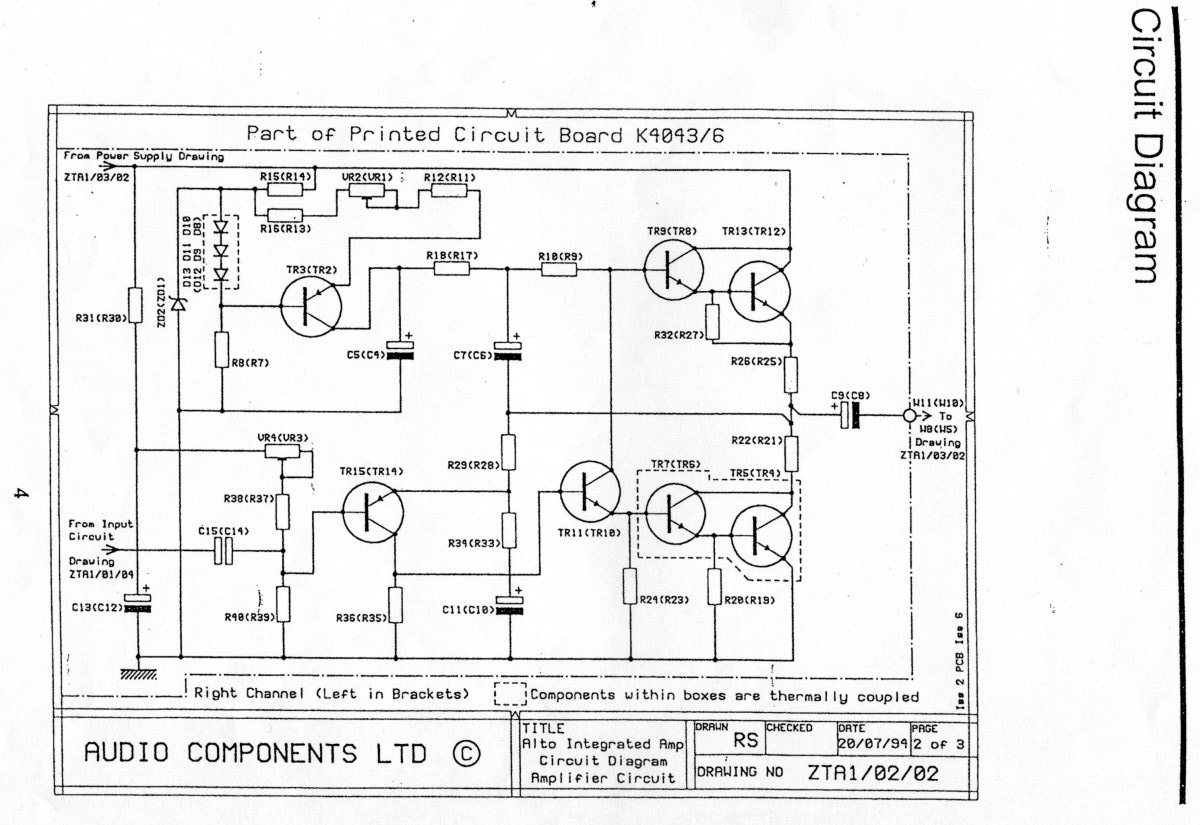

Hi, I bought an amp a while ago (had a few of them in the past -Audio Innovations Alto MK1) and over last couple of days as it gets warm it starts to sound a bit rough.
When I first got the amp 2 Months ago) I checked DC on the output which was less than 10 mV, so fine, I thought. But, today I decided to check it again and it was @45mV and rises to 1.4V after 30 minutes on both channels.
The amp is a kind of rehash of of an old single rail quasi complementary design and uses a pair of 2N3055 and an output capacitor.
I don't believe the amp has had any work on it since it was first sold , approx 1996-7.
I tested with a DMM across outputs with nothing else connected, is this correct? Is there a fault?

Obviously, you should first check C9 (C8), if they leak you've got offset.
Check: what's the voltage at the other (non-output) side of that cap.
It should be close to half supply.
Do both channels have the same issue?
Did you check with load connected? Unloaded, even minuscule leakage can cause offset that disappears when loaded with a speaker.

Short the inputs, place a small value resistor across the out puts (a 10 ohm 1/2 watt would be fine) and then check for output offset voltage. If it is still there (and excessive) you most likely have leaky output coupling caps that need to be replaced.

That output coupling cap lways leaks a tiny bit.
If you only load it with a multimeter, which is very high impedance, that tiny leakage can still work up some measureable voltage.
Load it with a speaker and it's no longer measureable.
Your amp seems fine.
Don't recap unless necessary - chances are you break something in the process for no real advantage.
