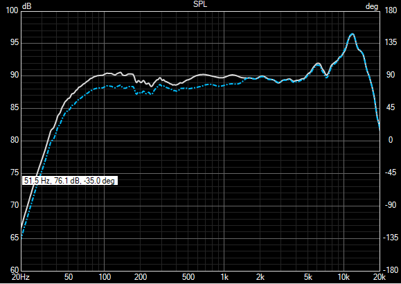

Initially I wanted some response to my preliminary crossover simulation that I attached in my first post. I also attached FRD and ZMA files.
Do you think this looks okay DcibeL, or do you see any room for improvement (I would be very surprised if not)?

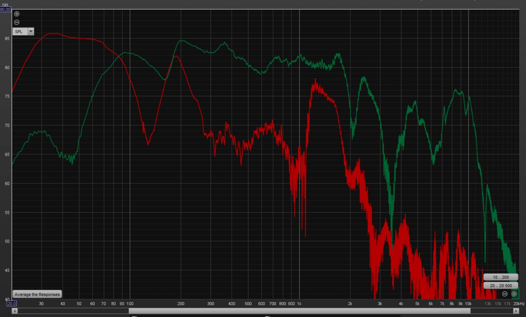

This is a good point. I have attached an image showing my nearfield measurements of woofers and port. Green = Woofers, Red = Port.Your woofer response files are showing a major problem between 100-200Hz, and are also not showing typical baffle step response for drivers measured on a speaker baffle, so I don't have much confidence in your splicing of near/far measurements.

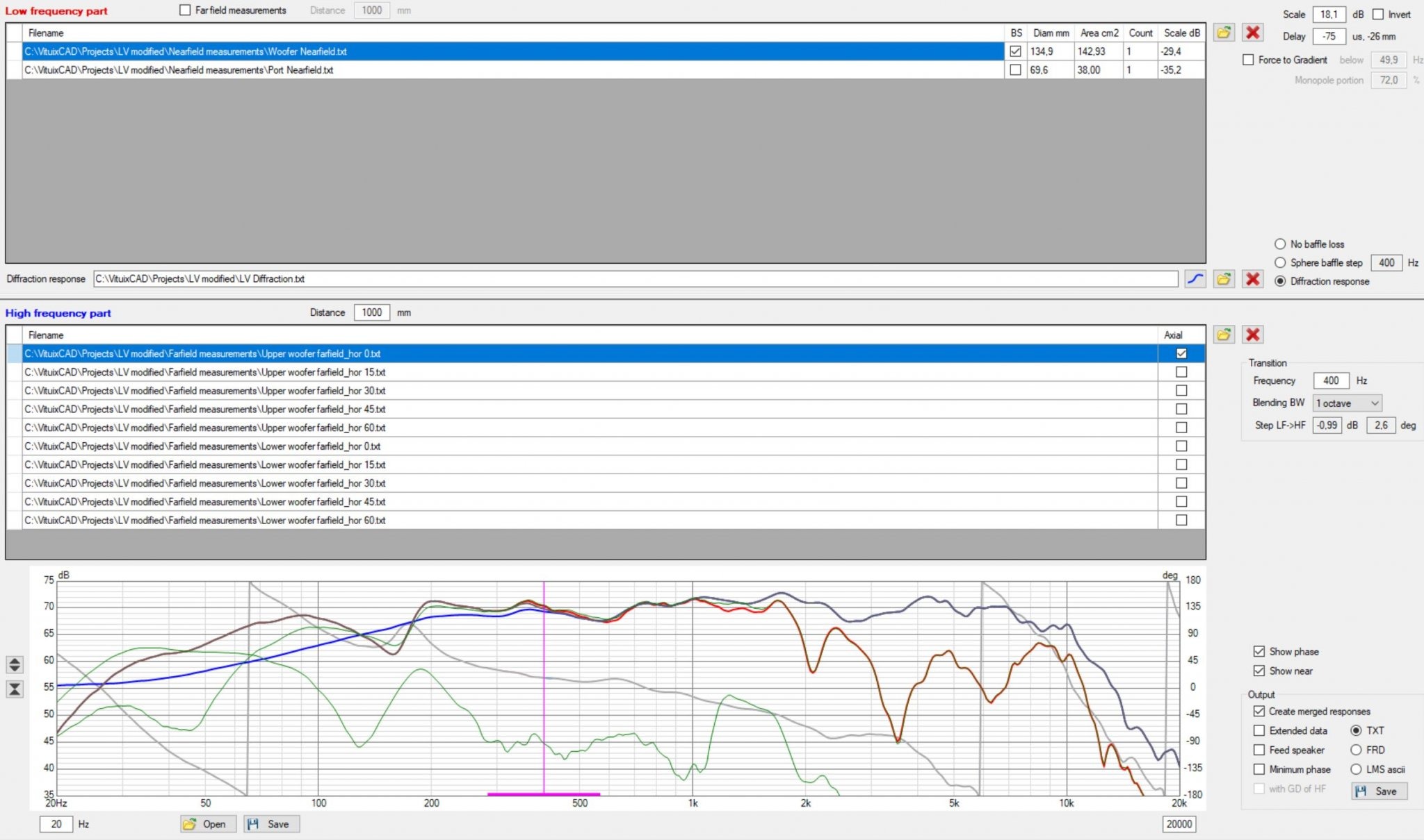

And also one of the Merger tool in Vituixcad, I may have messed up something here.

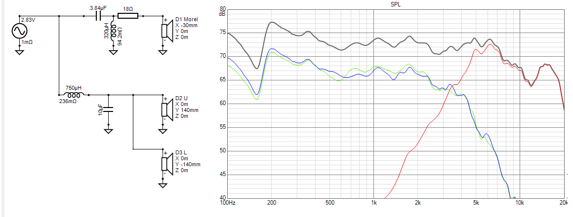

I will try to simulate a second order filter for the Morel.Second suggestion is to provide a higher order filter on the tweeter than just a single cap. But first you need to provide the software with good data, so focus on the measurement and response processing procedure first.

Neafield response should be the immediate area of focus. Area from 100-200Hz should be smooth, that may be cabinet reflection, is there no stuffing in your cabinet? Port response showing a big peak at 200Hz is also of some concern. If you load in just nearfield and port response to the merge tool, no diffraction, the result should closely resemble your enclosure model. For the sake of simplifying the merge process, you can always skip the port response, it's not going to have much influence on a crossover design >1kHz.
Beyond that, I would recommend processing each upper and lower woofer responses individually. Diffraction response is fine, but just for the sake of argument, since nearfield response is for a single driver, diffraction simulation should also only include single driver, and distance = typical listening distance of 2-3m. Not that it will make much difference either way, but 10m distance is a bit odd to see here. You will find that making this adjustment has little effect to the diffraction response of interest for this task, <1kHz.
There is definitely stuffing in the cabinets, but I will see if I can rearrange it or experiment with different types of stuffing.Neafield response should be the immediate area of focus. Area from 100-200Hz should be smooth, that may be cabinet reflection, is there no stuffing in your cabinet? Port response showing a big peak at 200Hz is also of some concern. If you load in just nearfield and port response to the merge tool, no diffraction, the result should closely resemble your enclosure model. For the sake of simplifying the merge process, you can always skip the port response, it's not going to have much influence on a crossover design >1kHz.
It looks like I have some more work to do with the nearfield measurements before moving on, I'm going to remeasure this.
And thanks for the tip about skipping port response, since it's also on the back it will have even less influence on the higher frequencies.

When you say processing each woofer individually, you mean the farfield responses? I did measure each on their own axis, and imported them individually to the merger tool.

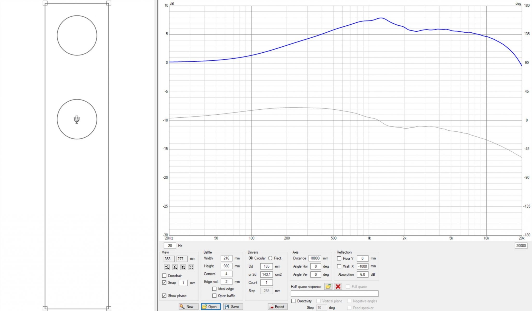

Wrt the diffraction response, the nearfield response is for a single driver but bass response includes both drivers. Both drivers were connected, but one driver was isolated with a pillow in front of it. I'm a bit confused about only using one driver for diffraction response.
Joined 2003
In retrospect I think what you've done for diffraction is fine. Both woofers included in diffraction model to create average diffraction in the far field, and 10m distance is used to avoid response null from differing driver distance to mic. Keep on as you are, near field response is the only real point of interest to address.There is definitely stuffing in the cabinets, but I will see if I can rearrange it or experiment with different types of stuffing.

I agree, the simulation below does not look very good. Do you feel this is an improvement over my simulation? The crossover region sure looks better on your simulation though, not the large overlap I got on mine.
But to my understanding, the scaling in Vituixcad is a measure taken to avoid double dealing this effect?
I had to read the last part a couple of times, but I think I got it 🙂 So basically you are saying, as long as I use my measurement protocol with Vituixcad I will be okay, and a less powerful software without this feature would require measuring both drivers at the same time?
Yes, that was it. Ok, this doesn't have the right feel and I suspect the response is not what it should be. Does 1ms look different to 5ms? Does your measurement look anything like the factory plot?
Many people think that.. but it should only be that way under certain circumstances or you'll double deal the effect.
You see, vituixcad can simulate the interaction of the two drivers by considering their spacing. On the other hand you can measure that very effect by measuring the two at the same time. It's one or the other.
