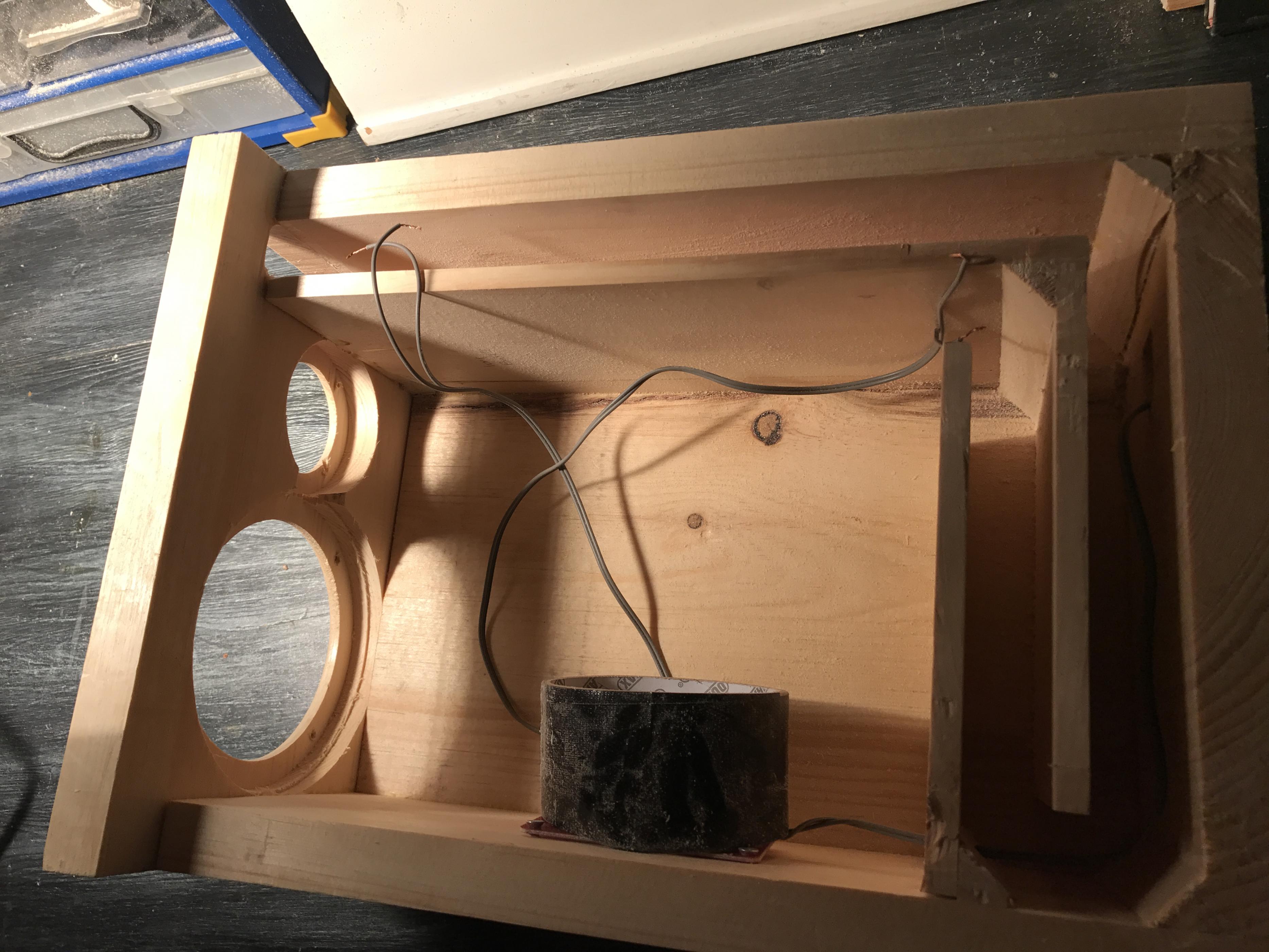

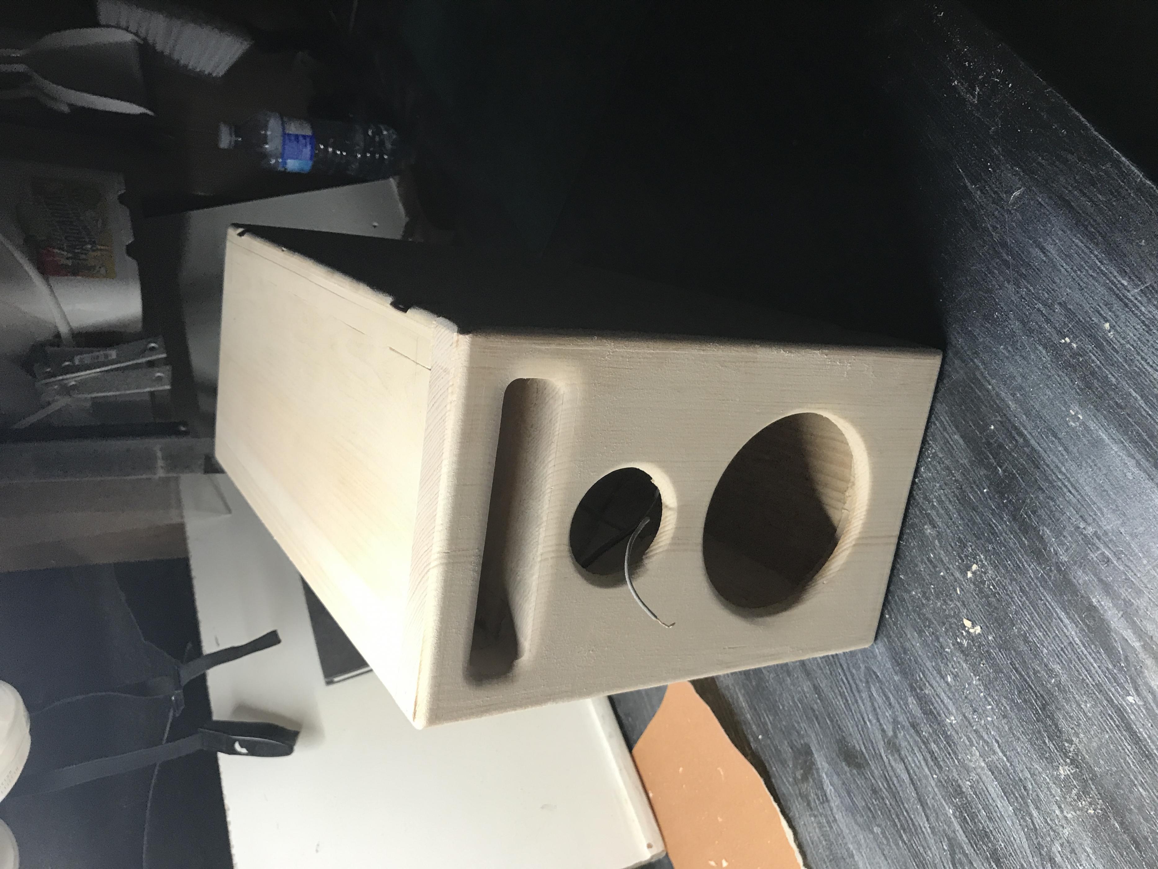

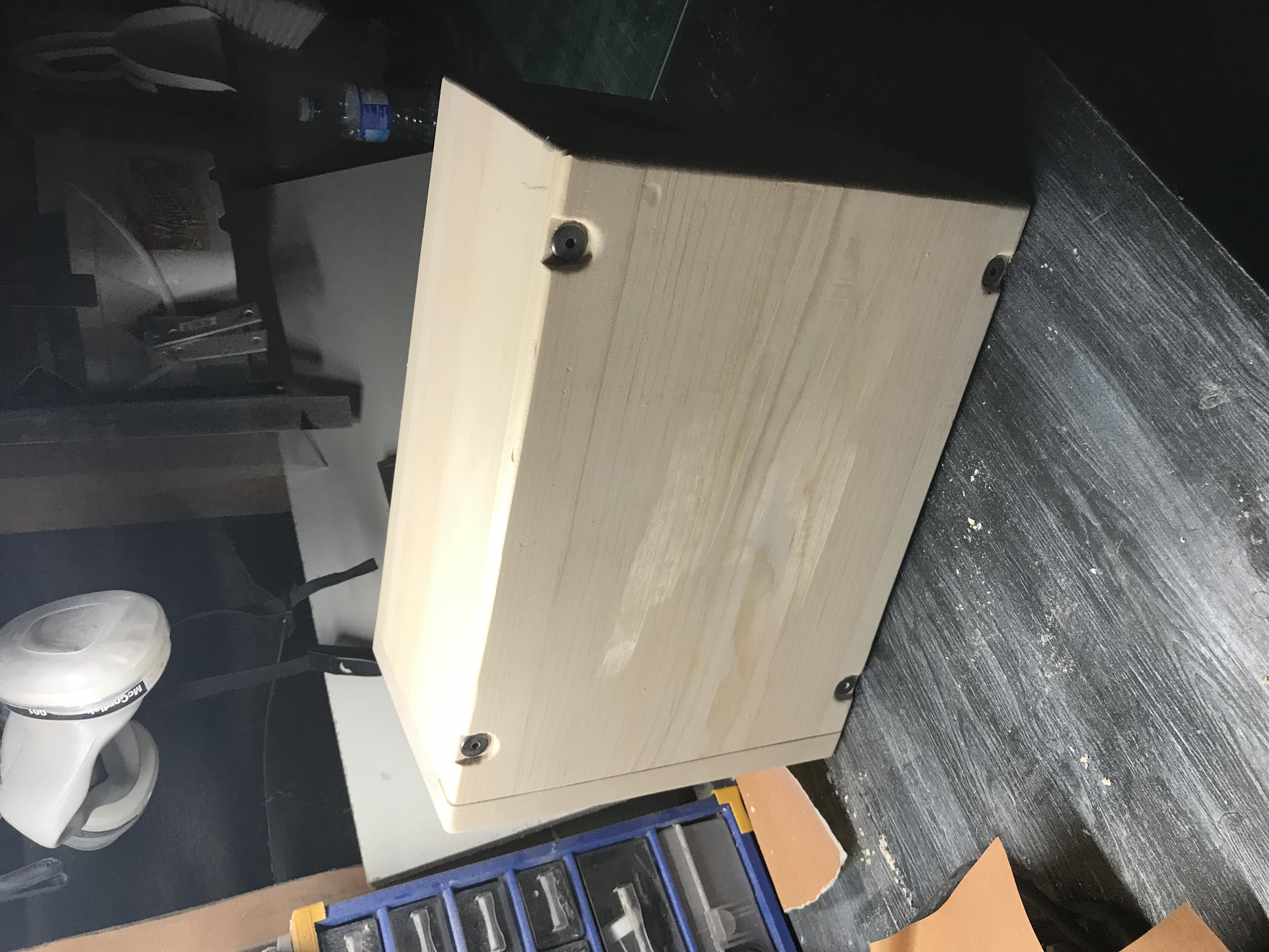

I used threaded inserts and I was surprised at how tight I could get the seal. And to be sure I'll caulk it with silicone before my final assembly. Then if I ever need to service the components it's as easy as removing the bolts and cutting the silicone. I puttered around the hardware shop and there are a plethora of different bolts and options so this could easily be adjusted depending on the look you are going for. Thanks again for the help.
I attached a few pics for reference. Still a far from finished, but getting closer.
If not too late, I'd caution against using silicone -once compressed by the clamping pressure of the machine screws and threaded inserts, it can be more of an absolute bitch than you might think if you ever need to remove that panel.
In the millwork trade, silicones are used to adhere plywood or MDF cores to Stainless steel and "Corian" countertops.
Thin closed cell foam weatherstrip or glazing tape can more than suffice.
