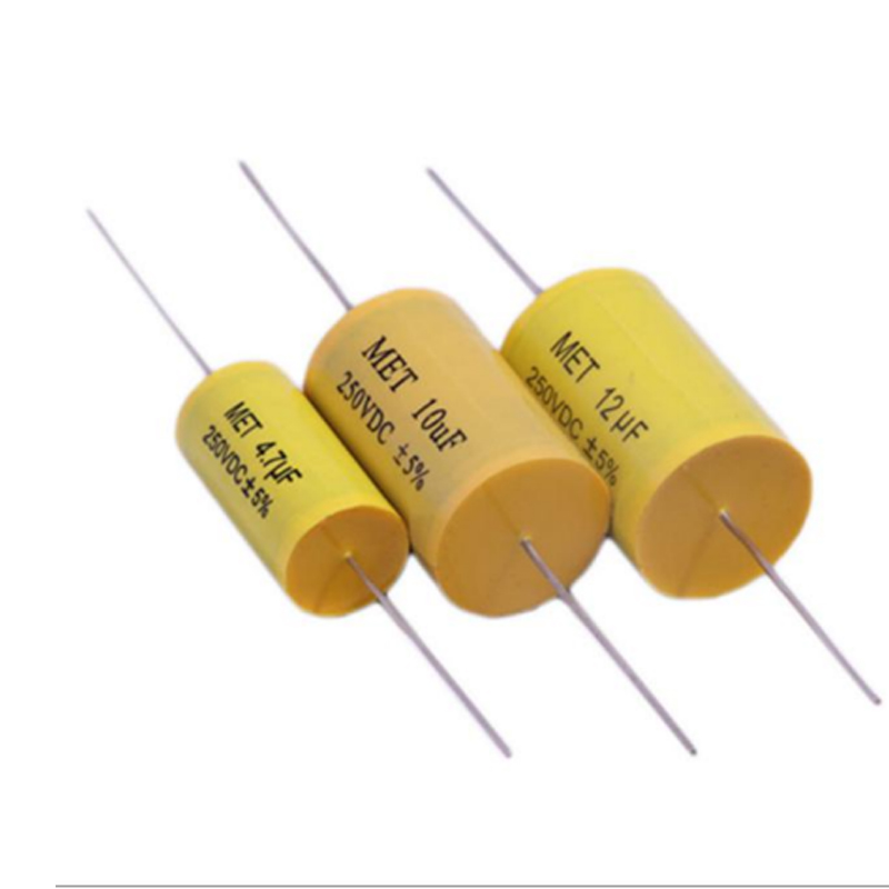

If continuing to use these drivers, I would strongly advise replacing the 3.3uF capacitor with a modern equivalent, as its value has no doubt drifted from spec by now. I would replace it with a polypropylene film capacitor of the type shown in the attachment.
