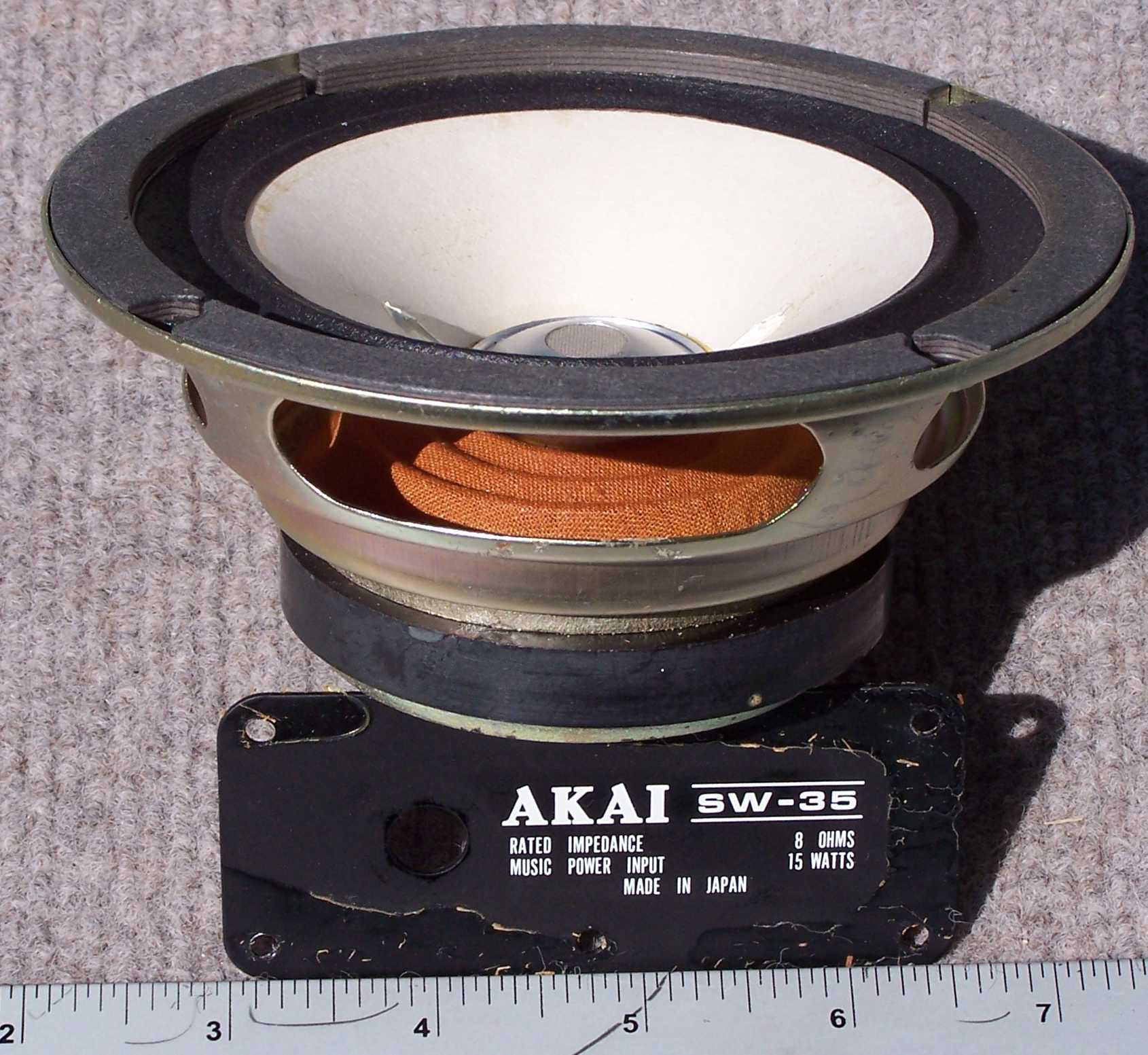

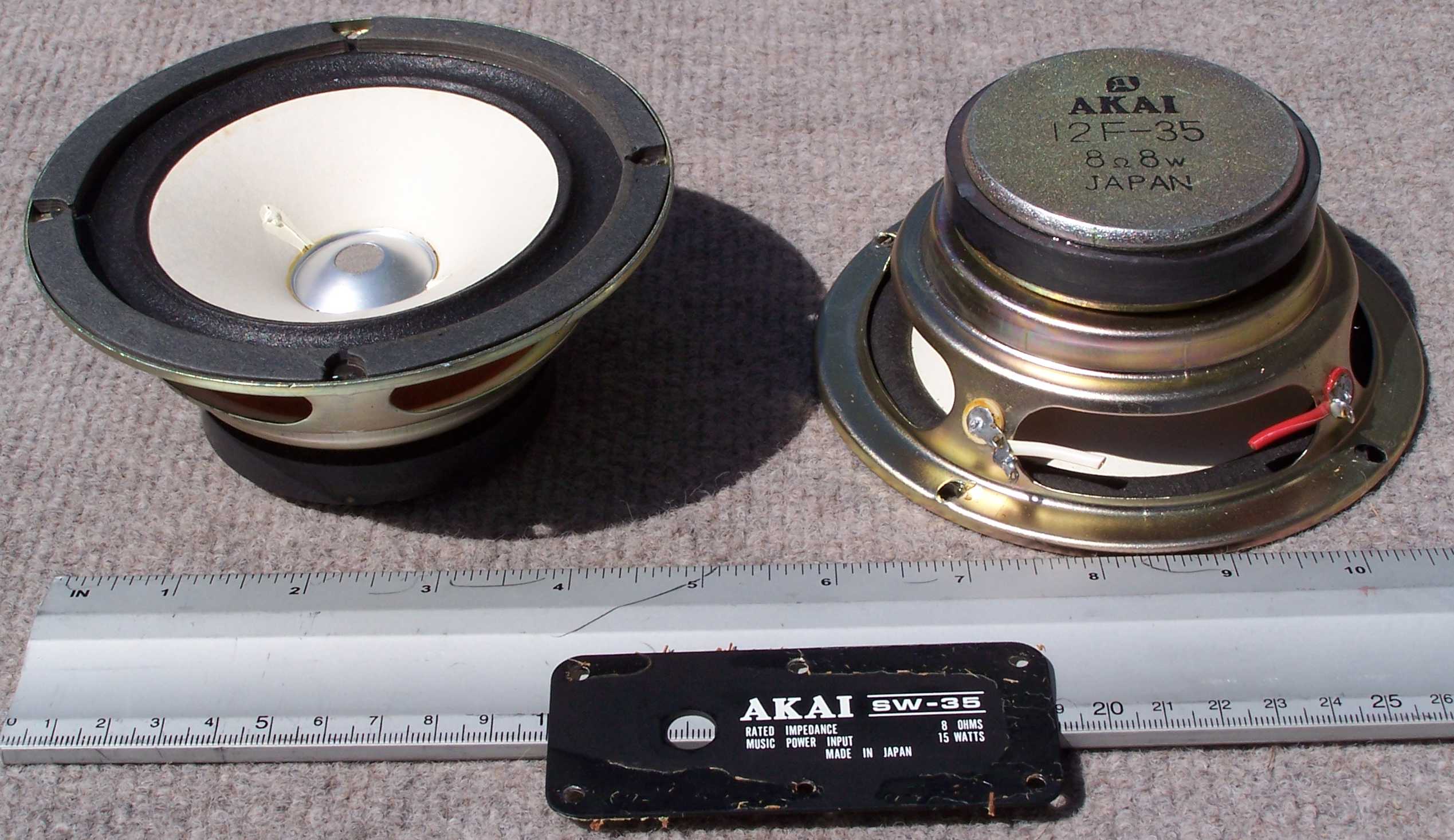

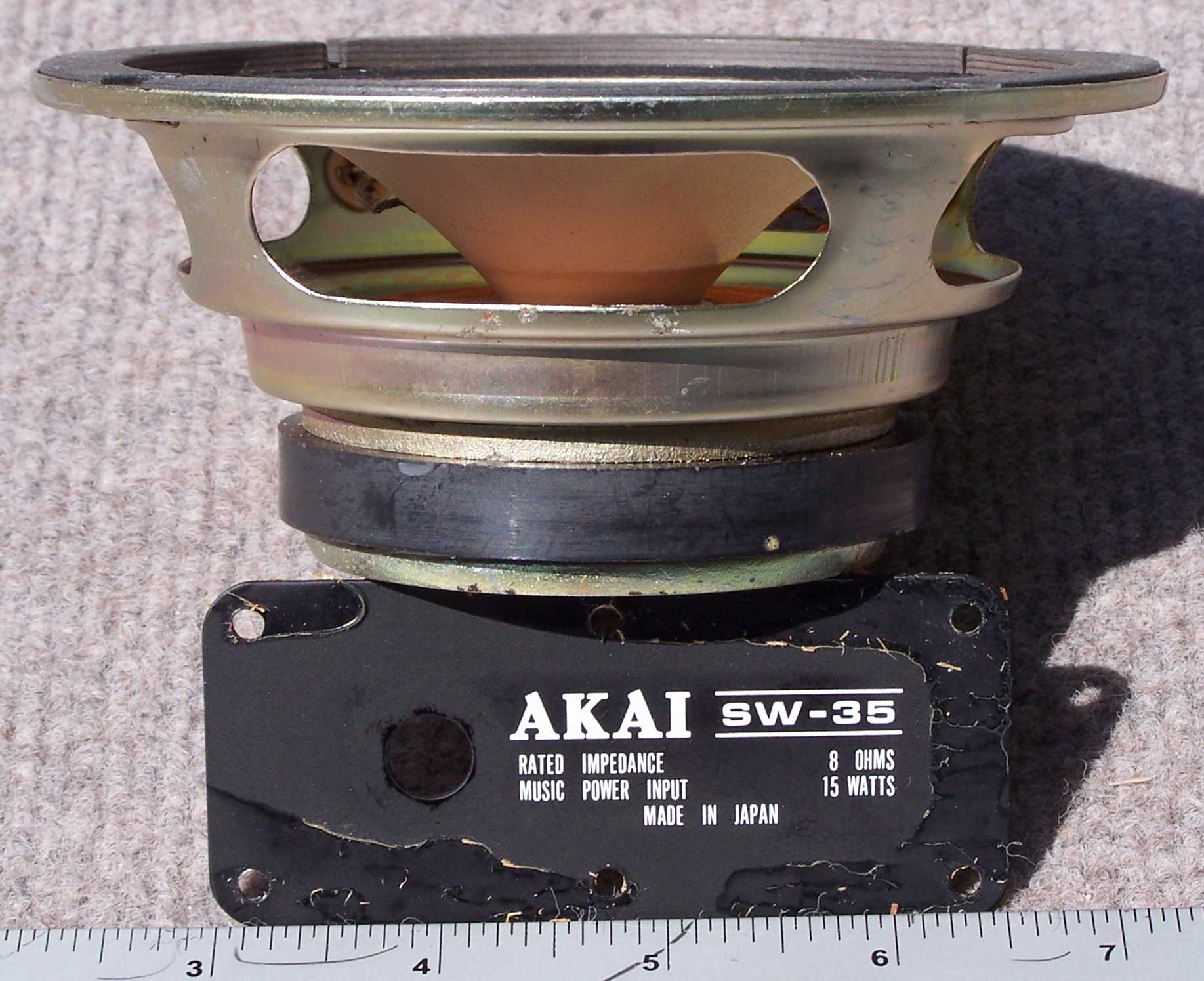

I recently "scored" a pair of AKAI JetStream speakers (without being able to test them first). Cabinets are of the "tunnel reflex" or "labyrinth" style, but their construction necessitated serious damage to open them. No loss - I was after the drivers anyway. The resulting prize:
They are 5 inches diameter outside of basket. They look nice to me - reminiscent of some full-range drivers made by Fostex, perhaps? Unfortunately, despite outwardly pristine condition, these both have destroyed voice coils.
My questions:
1) Are these decent drivers (when functional); perhaps someone would venture a comparison to a better-known driver?
2) If answer to (1) is "yes" or "maybe", then what is the practicality of repairing these? I imagine a full recone kit would be required, and maybe that would be impossible to obtain and/or not worth the cost?
Just checking before I go to the trouble of sending them to the e-waste stream. (No, that doesn't mean pitching them into the river out back 🙄)

not sure of the quality, but they certainly have promise"
What I could find out about the drivers point to them being a clone of FE103 or a Foster 10F3 alnico.
so if they seem OK, I think worth the time.

Thanks for the info, Stew!
That cabinet sketch does look like the ones I got. The input connection was via 1/4" phone jack mounted on that little nameplate glued into the back of the cabinet, so not readily field tested without the needed plug. To access the drivers, I had to pry off some glued-on plastic trim strips on the front, remove some screws underneath, and then pry off the glued-on aluminum sheet covering the entire front panel. This exposed the mounting screws for the wooden front panel; removing that baffle finally allowed access to the driver mounting nuts.
So, does anyone know if there's a recone kit available somewhere for these? Otherwise, I guess we can only note that said speaker systems have nice drivers (in case one should ever come across a working pair), and toss these out?

Fostex FF125K fullrangers @$80/pr if you want something similar. At that price it would be hard to justify reconing your drivers, even if you could find a kit.
For a few dollars more (sounds like a movie title🙂 ), planet10-hifi has the Mark Audio CHR70eN drivers for $125/pr. Please see the application thread here at diyaudio. Well worth the $$$ (well I personally think worth more). Dave also has other drivers available and depending on the enclosure type and amplifier type may have a different recommendation.
