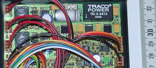

Yesterday I was also doing some efficiency measurements.
On 2.65 ohms load, and discounting the modulator's and driver power consumption, thus only taking into account the output stage losses, (mosfets and filter) at 262W output efficiency is about 91.5%.
I think that most of these corrersponds to switching losses (total conduction losses are Iout(rms)^2 * Rds(on), right?)
I will try to increase the gate drive voltage from 12V to 15V, that should speeed up transitions, and perhaps decrease frequency a bit, from 285KHz to 230KHz or so.
I attach a photo of the gate drives, now that the gate resistors are 6 ohms instead of 10. I have noticed almost no difference, so I don't know how to speed up the switching more. It seems that the rise/fall times are too long. The mosfet has 110nC max. gate charge, 3200pF máx total input capacitance.
Peter's mosfets are larger and he seems to be getting higher efficiency. What can I do to improve switching times apart from using lower gate charge mosfets?
Thanks!
Thanks!

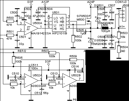

Yesterday I accidently shorted the output terminals of the amplifier ( A really dumb thing to do.) anyway it killed the output fets and driver IC. So i have decided its time for over current, and also supply pumping / over voltage protection.
After looking at a few reference designs this is what i am thinking, can anyone point out any problems with the design so far..
The ir2110 has a SD pin, once pulled high the driver IC turns off.
I have a RC network feeding the SD pin of the 2110 in order to reduce spurious shutdowns, is this a good idea? do i need a larger or smaller time constant??
I have attached a pdf file of the anticipated changes. Note: lots of information has been left off this schematic.
Any suggestions / help is much appreciated
Regards
Peter
Regards
Peter

About the protection circuitry, I see you are basing on what IR reference design does.
I assume that D1, D2 and D3 form a overvoltage protection also. When the PNP is activated due to overcurrent, it passes current to D4 so it biases and activates SD pin.
I think it is easier to sense the current in the negative rail, so you have all the grounds referenced to the negative rail, and you don't need zeners at all: for example, use a NPN instead of the MJE350, with a collector resistor to the driver's supply (Vss+12v), and emitter to Vss. The output of that transistor (collector) should go low when overcurrent is detected. Then you can invert that with another transistor and attack SD pin.
In any case, I would include a time constant (as you have done, although somewhat longer), so when overcurrent is triggered, SD pin is high for about 1 second or so.
Please keep us updated!

Yep D1,D2 D3 are for over voltage protection. I think it is actually easier to current sense in this application from the + rail. Given that I would need the string of Zener diodes for the over voltage protection its just easier to tap a pnp in where i have

About the protection, your approach can be good, too. If you implement it, tell us how it goes. I would short the output and start increasing the input voltage until it engages. It should act quick enough and then remain in shutdown mode for a while. This is how I like it, at least.

I used a two channel synchronised(!) triangle version, not for audio, but for a fast heater control.
Minor changes from the schematic:
- 100nF before R506
- C510 1nF
- C512 150pF
- 100k parallel to C512
Major disadvantages:
- hard to get the triangle stable, moves around the average value. Could minimise it, but not remove completely. Maybe better with a freerunning generator.
- poor linearity and correlation between input and output voltage
- MAX 942 cannot work with high differential voltages due to its triple antiparallel input protection diodes, resulting in low possible triangle amplitudes
- restricted modulation factor (~15%...~85%)
I will switch to a self oscillating design, similar to one, Bruno suggested to me sometimes. This will incorporate a overall feedback.
In the photo the comparator is under the "wire crossing", the generator is rightt of it. Power stages are in the upper left, using all SMD and remaining cool under all circumstances (at least one good thing)
