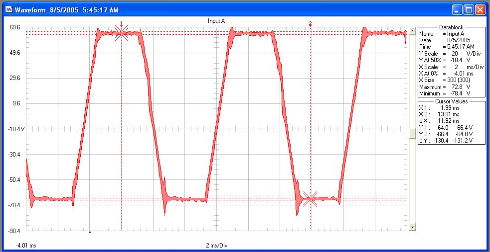

Here is an image of the amplifier clipping.

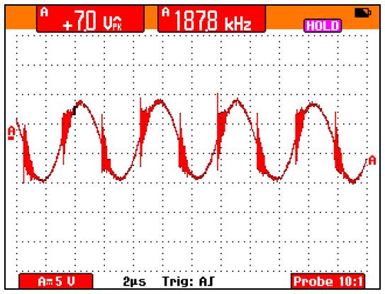

Lastly, here is the filter ripple.
I did the above testing without a load and after about 3 minutes I started smelling something getting warm... I killed power and felt around and the output inductor was smokin' HOT. I couldn't put my finger on it for more than 2 seconds before the heat was unbearable. Why is the inductor getting so hot?
I am using a 47uH torroidal inductor
Part Number = 2309-H [digikey.com]
inductance = 47uH @ 1Khz
Idc = 10.7Amps
resistance = 16milli ohms
I am convinced I am probably just using the wrong type of core material .
Can someone tell me where I can order the right core? Preferably without having to wind my own... [Although I will if necessary]
OD ~ 1.15 inches
ID ~ 0.5 inches
Does anyone have any requests on seeing a scope image of something?
Might have to play with your deadtime somewhat, either to minimize or increase it, not sure which way you need to go with it. Experiment.
Could explain those spikes you're seeing, most obvious in the filter ripple.
You've done great thus far but you just crossed the "start" line, all the tweaking is ahead, hope you're looking forward to it, expect to burn a few more parts 🙂
Self oscillating amps have some natural frequency modulation as well, and is slower at high modulation index, I"ll let Phase Accurate explain that better.
I'm wondering what you're taking those waveforms with, do you use a PC 'scope?
Anyway, once you start working out the bugs with the dead time I see no harm in at least "trying" to increase frequency.
Sounds like this is for car audio?
I dont' know this amp at all either, it may behave differently when you have a load on it.
Nice effort,
Chris
Once my amp was working OK with a micrometals core, I tried to replace it with a very similar inductor, also from JWMiller and also from Digikey, but it was 2305-H (22 uH instead of 47 uH), with the same results as you.
My sw. freq. is around 250KHz and the core got unbearably hot even with no signal. (my old core didn't heat up at all) That's due to the core characteristics, that is not suitable for high frequency.
There's simply nothing you can do with that coil in your amplifier.

With carrier-based class-d amps you can sometimes get such spikes when the loop is designed in a suboptimal way. Self oscillating designs are less susceptible to that, but who knows.
But I would also change the core first and check this problem afterwards.
Regards
Charles
My carrier-based amplifier also does that spikes. They are really ringings from the coil parasitic capacitance, mosfet capacitance + PCB inductance... I think they are produced by damped resonances triggered by the switchings.
Now try with a FM receiver near the amplifier and tell us if you get interference. That "spikes" as you call them are almost for sure causing RFI problems.

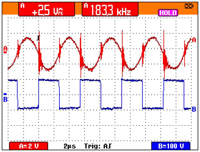

Attached is an image of the filter ripple with the new torroidal core. [The spikes are still present] Pierre's reasoning behind this seems to make sense.

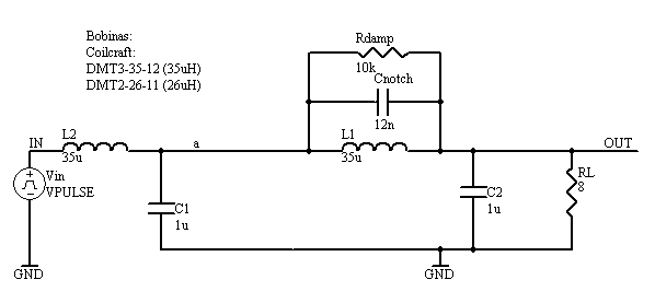

The circuit you have shown is a two stage LC filter , the second one having a "notch", not very useful in a self-osc. design where your switching frequency is variable. And, definitely, not the solution for any of your problems. I recommend to stick to the 2nd order LC by the moment, with the zobel at the end.

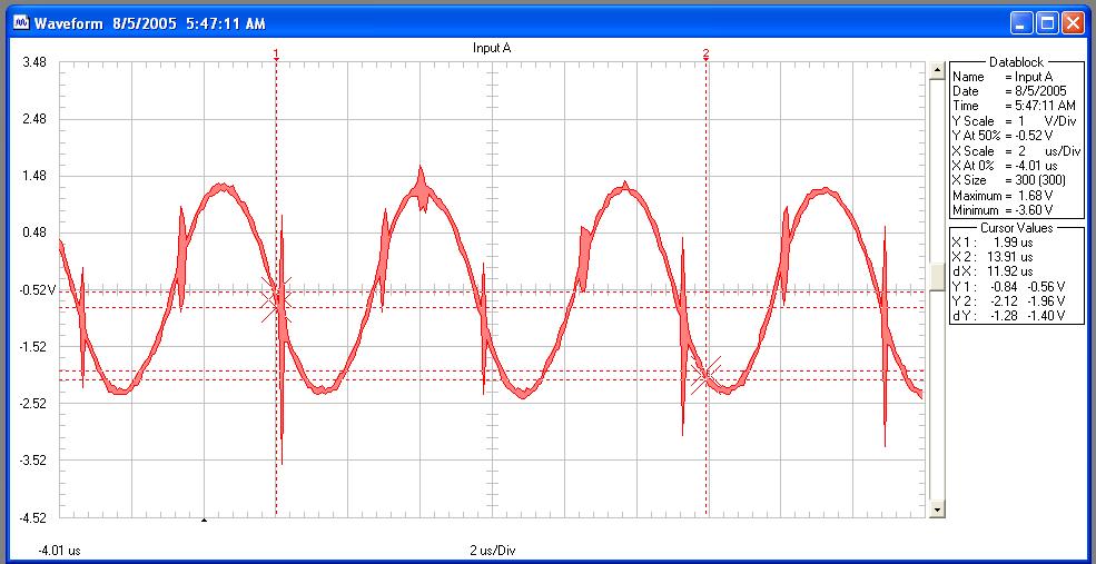

I think the output stage is a little untamed as well.
It would be interesting if you could recreate that behavior in spice. Perhaps it’ll be possible to also superimpose the half bridge output with your filter ripple and see what coincides with the spikes in it.
You seem to have at least ten volts overshoot and ringing on the square wave. If it coincides with those, you can measure the ripple frequency and use it to design a snubber to clamp it and dampen the ringing.
Also, don’t forget your choice of mosfet is a controlling factor here, and a major one at that. I believe the next step, as long as you’re sure you have a suitable coil, should be to experiment with different mosfets, before you add anything further. It's worth going through several different types at this stage if you have to in order to optimize it. At these power levels and depending on the quality of PCB it’s also likely that snubbers would improve things anyway.
After all that you’ll be ready to push the oscillation frequency up and see if it all holds, as right now you’re still switching on the low side and if you went higher I think those spikes /RFI/EMI THD etc are bound to be much worse, and you may find it even can’t take it.

Per Chris's request: Here are some images of the output ripple superimposed with the switching output.
