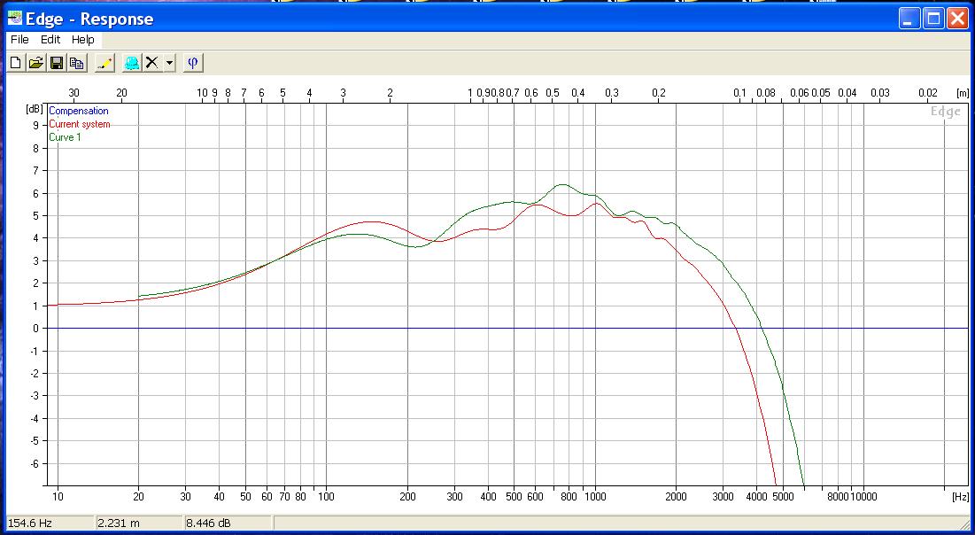

I've been studying baffle edge diffraction and baffle step compensation... from what I've learned, I figure that 3cm or so radius edges of my main speakers probably isn't doing a whole lot. Do you guys worry about baffle edge diffraction, looking at the majority of commercial designs, it seems most manufacturers don't pay a lot of attention to it. Anyway, at the moment I'm planning on taking it into account as best as I can whilst trying to maintain a design that is aesthetically pleasing enough for my wife.
Baffle diffraction puts dips and peaks in the frequency response, the drivers have dips and peaks in their responses, the crossover puts dips and peaks in the response,... The better designs will juggle with all these to even out the frequency response but it may not always be apparent from looking at the finished speaker. If you look at the better commercial speaker designs these days there have clearly been efforts to reduce the diffraction from the woofers which is less of an option for DIYers.

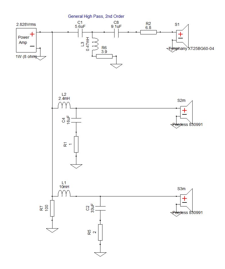

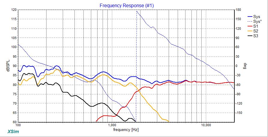

xsim-crossover-critique
xsim-critique-part-2
Are there any tools for baffle diffraction that you would recommend that can simulated the effect of odd shaped baffles (possibly with curves on them)?
The accurate handling of curves would require a 3D simulation (e.g. BEM). Some of the simple "2D"(ish) baffle diffraction simulators can make approximations for chamfers or radiused edges. If you place the speakers on a shelf with other surfaces close to the baffle these will also have a significant influence. Is there clean air above the tweeter or a shelf with stuff on it?

So, here is the thing, before I can build the centre speaker, I need to build (or get one built) a new AV stand. At the moment, I have a three shelf AV stand; the TV sits on the top and takes up the whole top (it's an old 40" Sony Bravia LCD screen with a thick boarder on it); the middle shelf which is probably only 15cm in height has the centre speaker on it and behind that on the same shelf is the external crossover for my main speakers along with an 8 port Netgear switch; the bottom shelf has a my server that sits in a full size HTPC case (Zalman HD160 Plus). Then next to that I have a 4 shelf Stands Unique hifi stand that has my hifi equipment and AV receiver on it. The thing is, there are a lot of cables that are visible between the stands and down the back of the Stands Unique hifi stand, and well... my wife doesn't like to see the cables. Plus I plan on changing the TV to a 55" TV and the AV stand won't take a TV that size. So my plan is to design a 3 component wide, 3 shelf AV stand with a TV support built on the back of it that will support my planned TV. As far as dimensions go, I think the stand will be about 1.75m wide (~5' 9") and 65cm deep (2' 2"). The reason why it will be so deep is because I have a McIntosh MA6300 that powers my main speakers that its specs say is 22" (~56cm) deep and I need to leave cable room since I plan on putting a solid back on the stand (but leave the sides open with pillar supports near the front corners to support between the shelves at the front). You know what, my description is hard to visualise. I'll draw a diagram and upload it later. 🙂
XSim btw is an excellent xo program but it doesn't have any drivers in its data base yet and probably never will. You have to input your driver FR and impedance files into it (left click on the driver and chose "Tune") the same way that you do for the other popular programs, PCD and WinPCD. I do particularly recommend PCD as it's got a couple of extra features in it that can be important to a CC.
Thank you so much for the links, I didn't know about Jeff Babgy let alone his Excel spreadsheets, which are amazing (I downloaded them last night and had a quick play - which told me that I'm getting massive boundary effects from my main speakers at the moment because they are so close to both the back and side walls!). Also, thanks for letting me know there are no drivers in the driver database for Xsim. I managed to find some FRD and ZMA files for the ScanSpeak D2905/950000, but haven't found any for the 18W/8545 (or more to the point the 18W/4545). I didn't look to hard to be fair though, but if I can't find any then I guess I'll need to plot them myself.
For more info into the simulation process try The Speaker Building Bible, starting at the xo section. I'm currently trying to help someone else with this process; you may find some of that helpful as well if for nothing more than some of the links:

I've attached a rough sim of a CC on top of or inside your planned AV stand when the stands front face acts as an extension of the baffle which won't be completely true but close enough for my purposes here. It does end up seeing almost the whole 6dB of baffle step loss, but it happens at much lower frequencies than usual. When you add these effects to your woofer, the approximate 2dB loss (ie. 2 dB down from 6dB) at about 200Hz and 250Hz is about the amount of loss that the driver will end up seeing when you add in the xo to correct for the gain that's above those levels. Let me know if that's not clear.
So if you use 2 x 18W/8545 (@ about 87dB sensitivity) in parallel, you'll end up with a speaker at about 91dB (6dB gain - 2dB loss). You actually have a few high quality 90dB or so mids to choose from that should be able to work here, like:

JWeave,
Yes, 3 way is better, I usually find it rather madening to try to find a quality tweeter and midrange that will fit vertically in the typically low profile of a center channel speaker. Much easier in a standalone that isn't being squeezed under an HD television.
But hey, if you have the space, do it! 🙂
Here's an example I'm working on for my blog. It uses much cheaper parts, but the phase alignment issues are the same. I've attached the XSim data so you can play with it to see what I'm talking about regarding how the phase issues go away, and how the extra driver takes care of the BSC for you. 🙂 This is a work in progress so the part values have not been normalized nor checked for power ratings, etc. I'm only sharing this to help illustrate the issues being discussed.
attachment.php
Regardless of which driver you set as your 0 point, the FR doesn't change very much.
Best,
Erik

Here's the FR, with individual driver plots. Notes:
  • The target curve I'm using is my own. Don't mind if you don't like it. 🙂
  • The woofer measurements are in far field in a bookshelf. Deliberately!
attachment.php
Again, you don't have to like my choices, the point here is about phase problems with a WTW setup.
Best,
Erik
