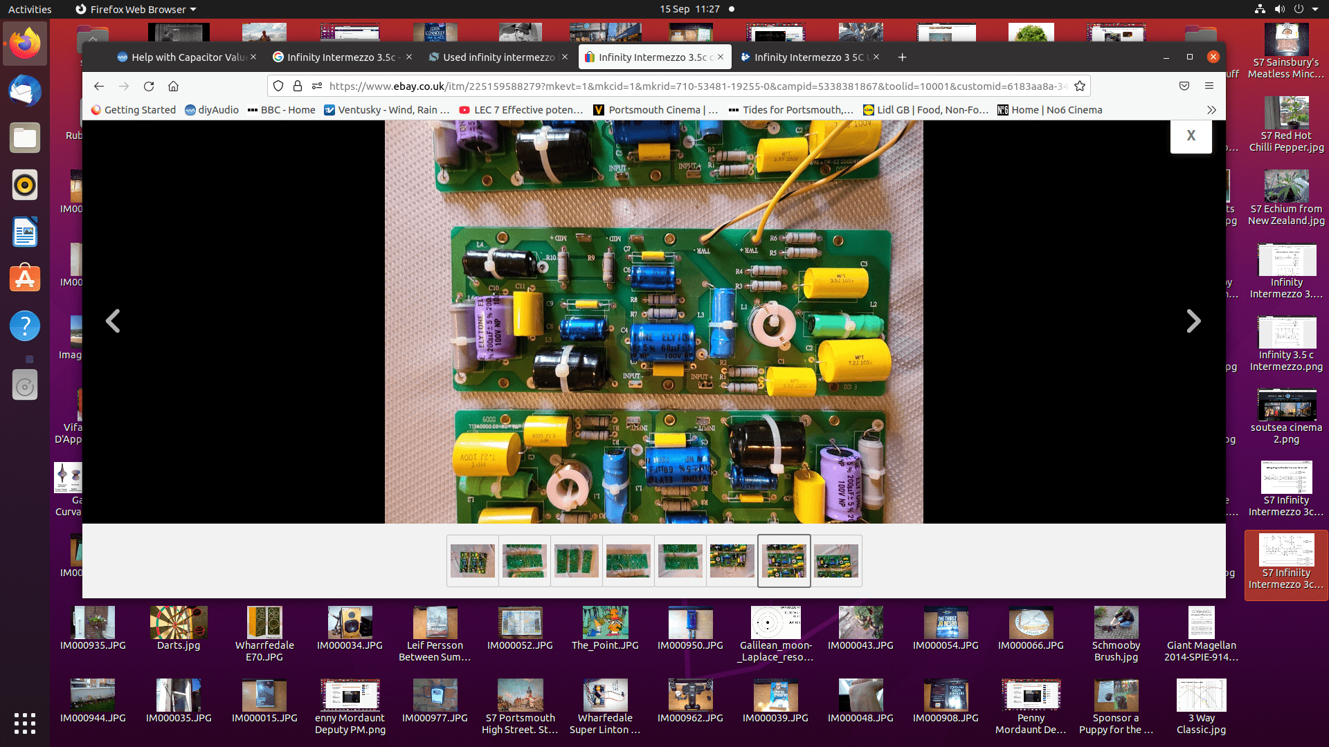

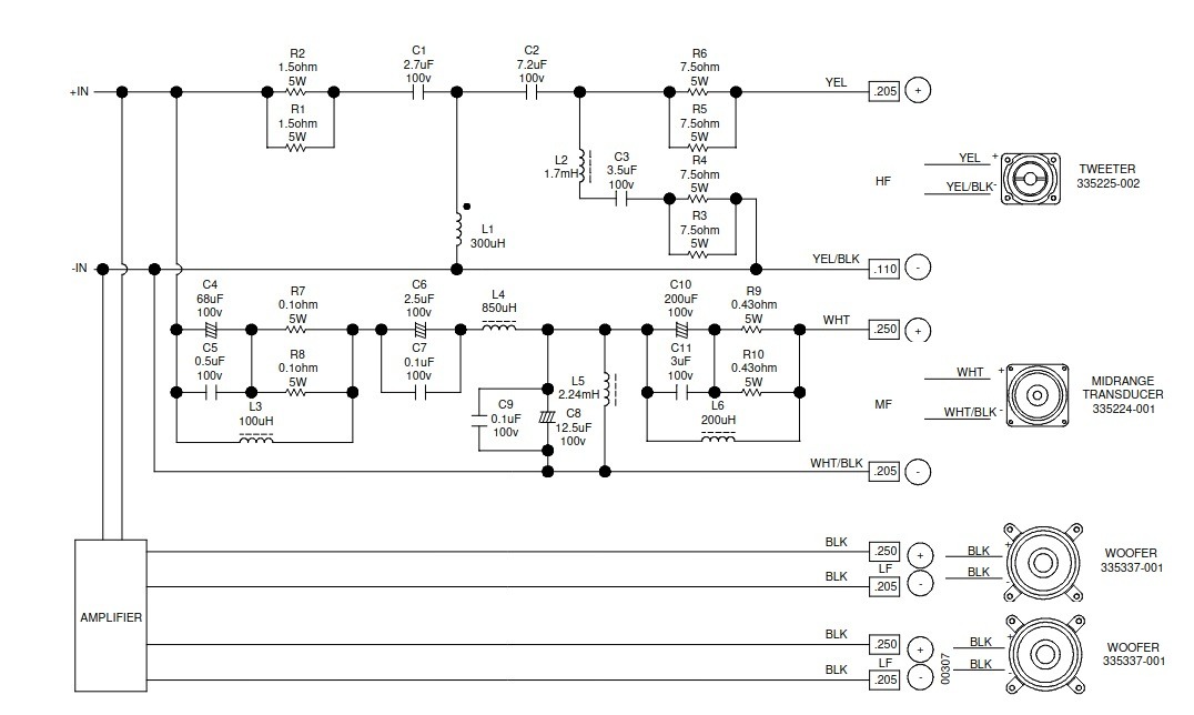

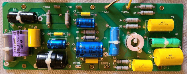

I have been having issues with an Infinity Intermezzo 3.5c Centre Speaker. The mid is very very low, almost no sound.
I have traced it back to one of the capacitors.
The service manual shows C6 as 2.5uF 100V, however on the board itself it says 25uF 100V.
Since it's by a factor of 10, I'm hoping someone can look at the XO and can confirm if it should be 2.5uF or 25uF.
The original cap is blown and the jacket on the outside is damaged so I can't read what the actual value is on the old cap.
Any help would be appreciated.

Absolutely no expert here (!) but, I would imagine it's 2.5uF simply for the reason it's paralleled with a C7 which is 0.1uF therefore making a 2.6uF cap

I know nothing about this speakers' details, but I can follow a crossover. C6 is part of a midrange filter.
2.6uF is an unlikely value for such an application. C6 and C7 paralleled form a series bandpass filter in combination with L4. As do C8 and C9 paralleled with L5.
I would lift the C7 capacitor to see what the circuit board marking is. C6 at 25uF and C7 at 2.5uF would be a reasonable way to make something near a preferred value of 27uF.
I am surprised the 25uF 100V cap has blown, which suggests severe overdriving, or heat problems from other components due to poor ventilation. A 25uF capacitor in film is quite a large component, and size is often a good indicator of value. It is also easy to recognise MKP film capacitors in their plastic cases from non-polar electrolytics in metal cans which are much smaller for a given value. An NPE is much more likely to pop too, having a significant resistance which causes heating.

I think the 25uf cap (C6) is an electrolytic cap, the capacitor symbol has hatching between the plates, which usually indicates its an electrolytic capacitor.
It probably blew up after the midrange went open circuit, which would cause the cct to resonate, thereby causing that component to experience voltage it wasn't designed for.
I would also check capacitor C8 to see if it has suffered damage as well.

C7 is definitely 0.1uF same as C9.I would lift the C7 capacitor to see what the circuit board marking is. C6 at 25uF and C7 at 2.5uF would be a reasonable way to make something near a preferred value of 27uF.
C8 was damaged. I'll be replacing that as well, but I know the value of that - 12.5uF.I would also check capacitor C8 to see if it has suffered damage as well.
So is the general consensus is that C6 should be 25uF, so the markings on the board is correct and the service manual is incorrect?
Yes, 25uF NPE 100V. I think afa wins some sort of coconut for psychic ability! It is a typo in the service manual.
But as afa said, it probably all went haywire when the midrange blew up or went open circuit. Of course, there may be other faults.
