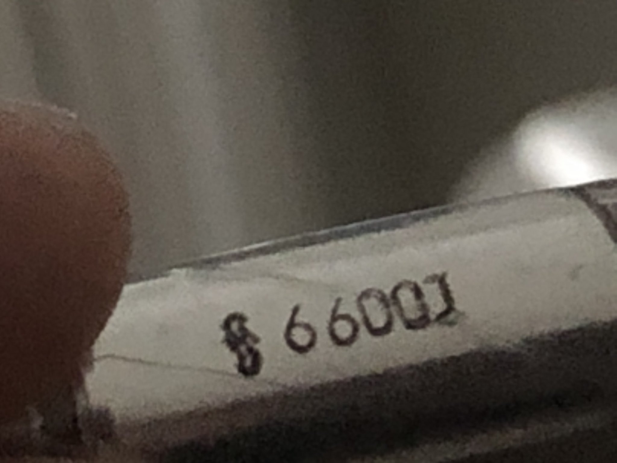

Hi, working on a vintage phono stage, but cant find any info on this capacitor? Anyone who can help translate its code to modern equivalent. Thanks

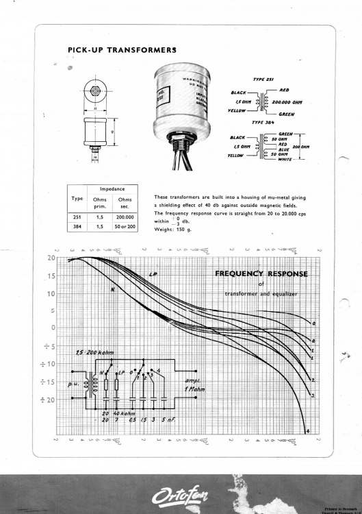

I have another questions. I have Schou transformer 0.32m 251. It is primary 1,5 to secondary 200k. These transformers are used with small circuit because the high impedance. There is 40k resistor after the transformer and a high filter attenuator. What output impedance will it leave me with? Picture shows the circuit.
