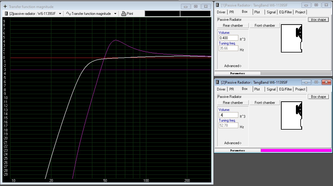

I did a Model with the Tang Band Driver
and 2 passive radiators mentioned.
Going by my previous models of shooting for
.4 cubic feet ( 11.3 liters ) and tuned to 35 Hz
The pink line shows you what the radiators
would do straight out of the box.
Tuning would be incredible high around 50 Hz.
White line shows the alignment to shoot for
35 Hz

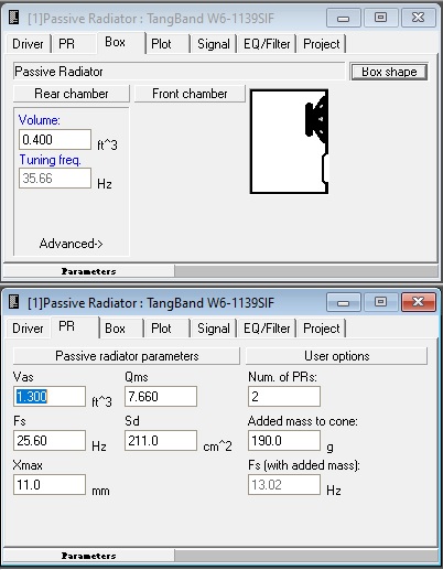

In order to lower tuning of passive radiators
you have to add mass to the radiator.
out of the box they are about 26 Hz
And need to be around 13 to 15 Hz
to yield a box tuning of 35 Hz with 2
radiators.
To achieve 35 Hz tuning
I added 190 grams to each radiator
to achieve the response shown for the white line.
11.3 liter 35 Hz tuning
2 radiators with 190 grams added.
Keep in mind the driver and radiators remove
volume from the enclosure. So your enclosure
needs to be larger than 11.3 liters
I haven't downloaded the driver or radiators
datasheets. So I dont know the volume they displace.
you would need to check and add that.
plus the plate amp and bracing will displace volume.
so to achieve 11.3 liters
the actual enclosure might have to be around
13 to 14 liters.
Just a guess, be better to accurately calculate
Driver, Radiator, Plate amp and Bracing Displacement

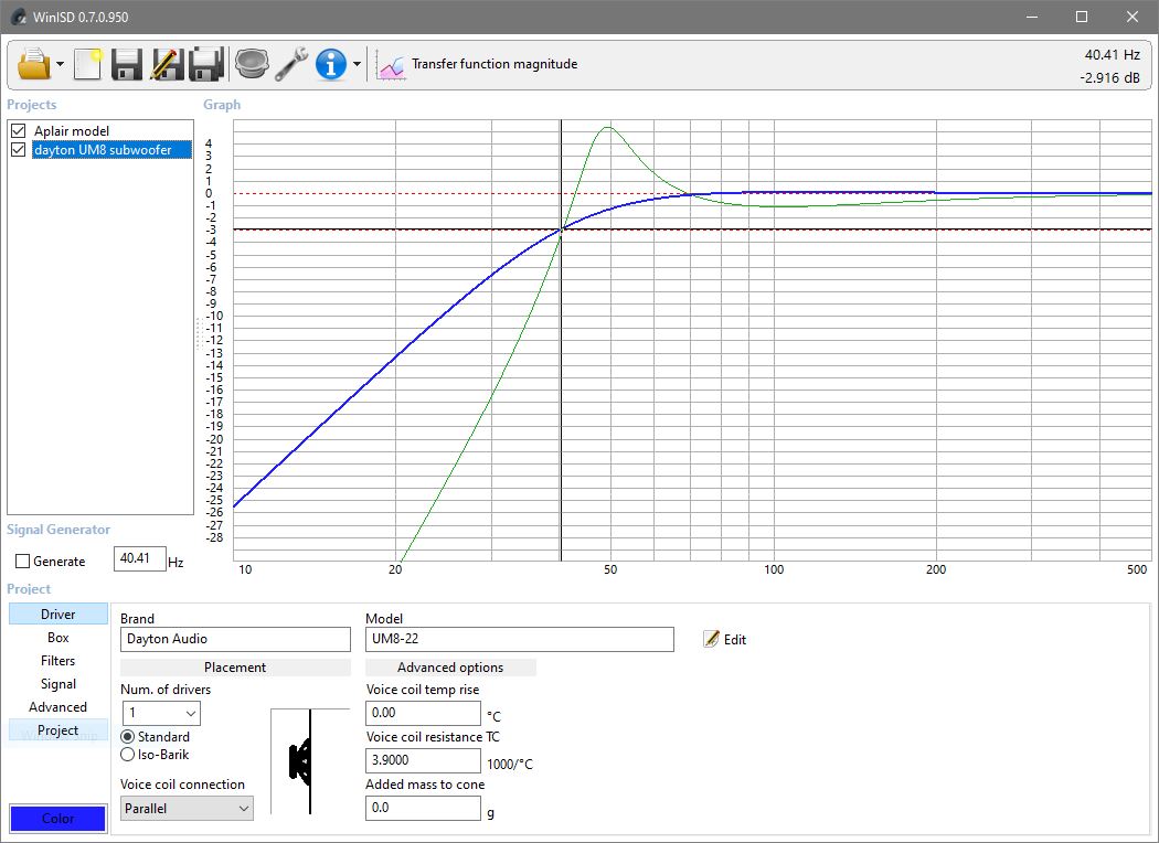

Hmm, thanks to modern EQ/DSP, [4] of these = $100 + tax/shipping in a 1.0 ft^3 ~0.55 Qtc sealed and EQ'd for best acoustic fit in room yields plenty of high SQ small room [mid, sub] bass down as low as the room goes on 75 W: https://www.newark.com/mcm-audio-select/55-2421/8-high-excursion-woofer-120w-rms/dp/88C7835

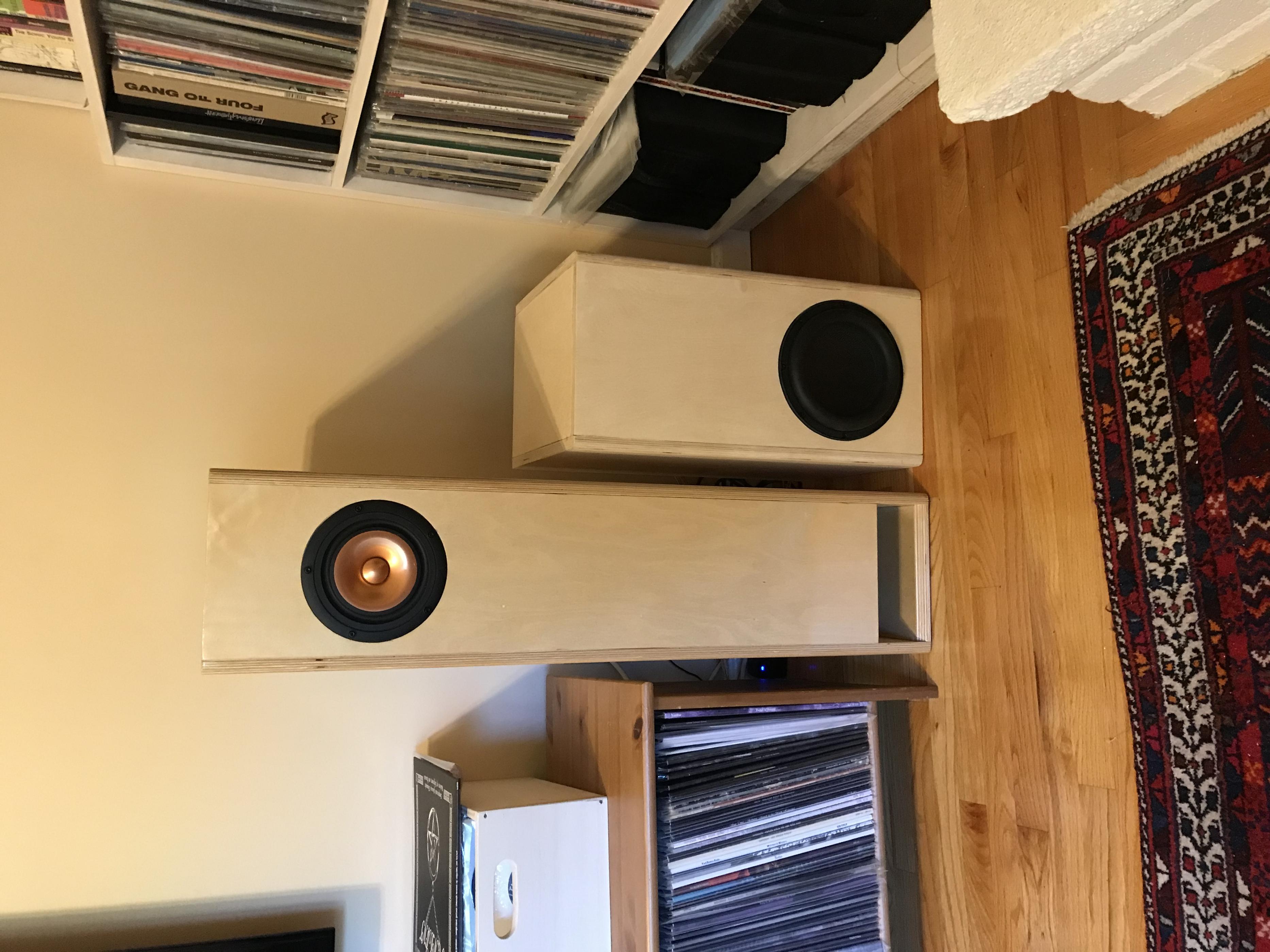

Hi all -- Thanks for the advice earlier. I'm almost finished my subwoofer build. The box is built and the driver and amp are installed and I'm testing it. It sounds amazing. The only thing left is to shellac the case. I have a few questions about low-level input/output vs. high-level input/output.
I'm using a Bellari preamp as a phono stage, an ACA amp running stereo as my main amp. The subamp I got is a Dayton Audio 100W plate amp. The subamp has low-level input/output and high-level input/output. The high-level output has an internal 6 dB/octave 125Hz high pass filter.
I've tried both low-level and high-level options. The low-level is louder (needs less gain) and sounds good, although I noticed some issues with synchronization and my main speakers. The high-level needs to have the gain set higher but seems to sync better. Lots of people online seem to recommend low-level input since it's line-level input, although I think my system sounds better with high-level.
As a noob, I'm trying to understand better how the high-pass filter is effecting the sound. Am I right that the high pass filter on the high-level input means that any sounds below 125Hz are being filtered out of my main speakers? Which means that they're working less hard and that there would less issues syncing sounds below 125Hz w/ the subamp? If that's the case, then why wouldn't I set the frequency knob (the crossover) on the subamp around 125Hz instead of the recommended 60-100Hz? Around 80Hz seems to sound best to my ears. Why do people like the low-level/line-level inputs better? I'll obviously go with what sounds best to me, but I'm trying to learn all these nuances to better understand how speaker building and hi-fi systems really work.
Also -- I was an apostate and didn't brace the box since I used birch ply. Seems fine. No rattles or weird box noise. And I'm debating stuffing. Although I used it on my pensils (my main speakers, which I also didn't brace and are fine) as recommended, it seems that a subwoofer box built to the optimum size doesn't need it?
FYI, I'm only using this to listen to records -- to home theater etc. Just a pure 2.1 system. See attached pics.
