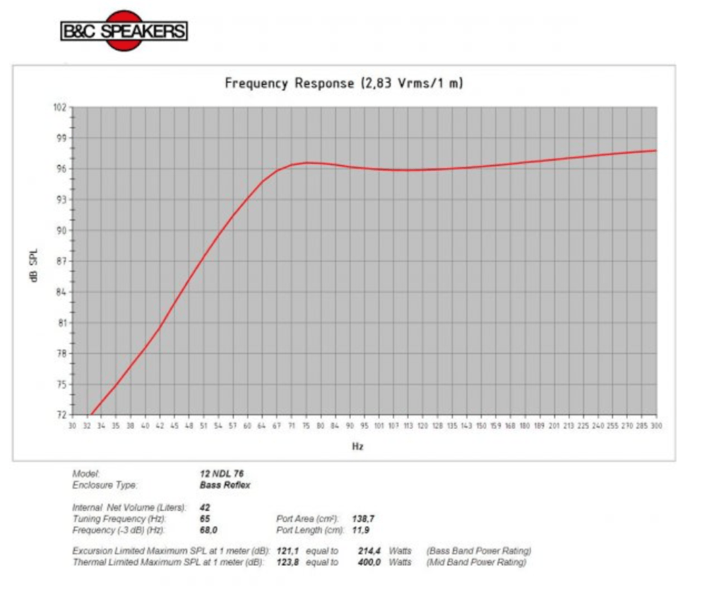

Qt = .2, Vas 73 L Fs 50 Hz Watts 400 sensitivity 100 db flat response 400 hz to 2 khz, rolls off 18 db @ 100 hz & 40 db @ 50 hz. Recommended enclosure 42 L recommended tuning 65 hz.

In the suggested 42L 65Hz Fb box, it's 3dB down point is 68Hz, plenty low considering you are using subs.

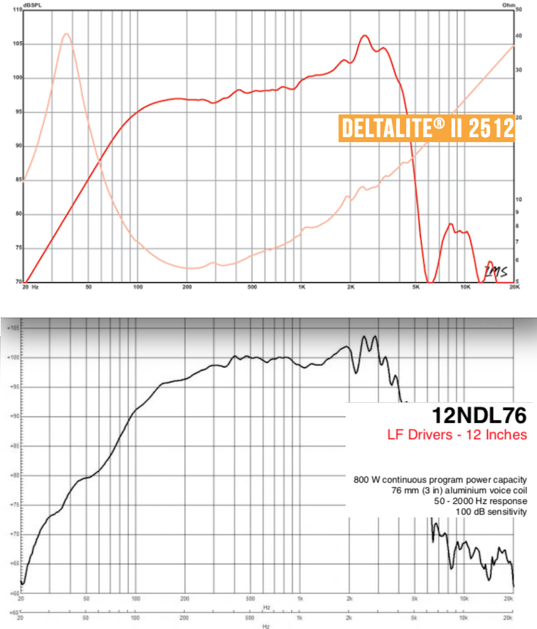

Indianajo evidently is reading the B&C charts wrong (they can be hard to read..). Due to having nearly double the Bl (magnetic strength) the 12NDL76 is near the same sensitivity (slightly less below 250Hz slightly more up to 900Hz) as the DL-2512, and the higher power rating will result in less thermal compression- you get what you pay for. The charts below compare the infinite baffle in wall response of the two drivers.
