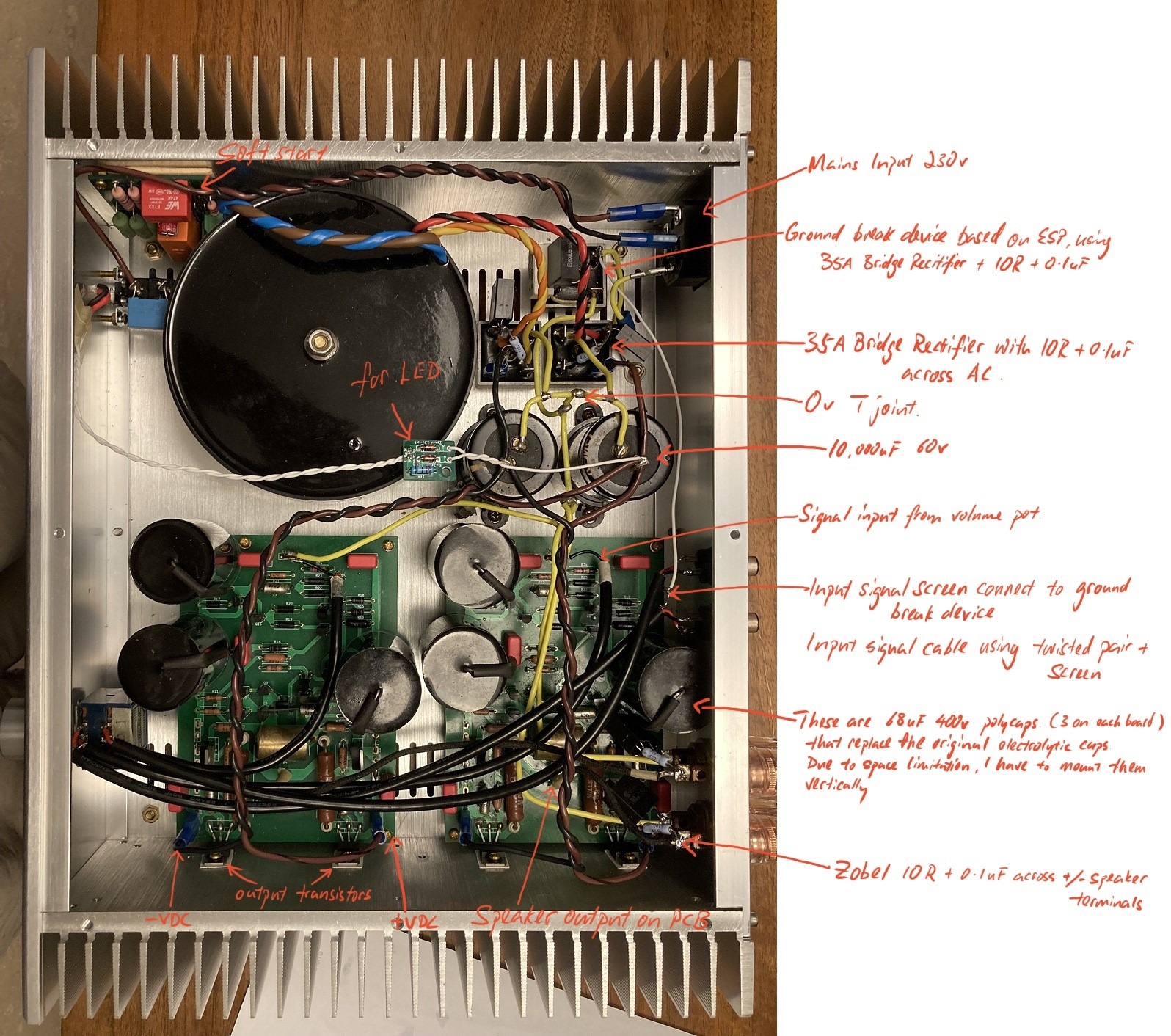

Hi Ctrlx,
Been on a loooong work assignment.
See picture with some notes. No schematic as the boards were given to me from a friend.
Let me know your thoughts.
Thanks.

Thanks Ctrlx,
Yes, I was thinking that it could be the big film caps mounted vertically could be picking up some noise. I have just ordered some electrolytics to replace them and see.
Not sure what you mean by cross channel loop, can you elaborate a bit more?
I don't think it is the input connections as I disconnected the input cable from the board, I still get the noise through my speakers.
Will trouble shoot a bit more and update later.
Just a quick update, as Ctrlx suspected, the large film caps mounted vertically were picking up the noises.
Have changed them to electrolytics now and hums are gone. However DC offset increased a little from ~30mvdc to ~50mvdc.
It was the film caps on the board nearest to the transformer that were giving problems, I changed those out first and noise were immediately gone even when the other board was still having the large film caps. But after spending some time listening for a few hours, I noticed that the channel from the board still with the film caps sounded a little brighter, my son thought so too without knowing what changes I made. So I changed out the remaining ones and all good now.
Thank you Mark and Crtlx👍
