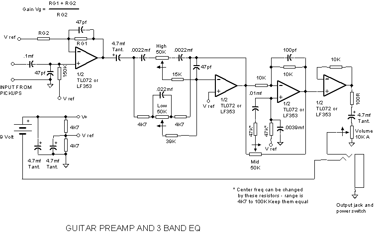

Ok, a few months ago someone gave me a broken wurlitzer sideman. It is great as a tube amp for my guitar, but it lacks any sort of Tone control for it.
I'm searching for a simple tone control maybe with a gain of some sort that I can build as a seperate unit. The only thing that I found that was simple had switches instead of pots for controling the bands.
I'm terrible at reading schematics when it comes to parts placement and wiring...Soon simple with pictures is a must for me.
Any ideas would be great!

I'm going to attach a schematic for a two band EQ, which I have built several of. It will work fine with one 9V battery. Perhaps you know someone who could help you "perfboard" one together?

I've done several of these. It really depends on the guitar, how much cavity space there is, etc. Sometimes you have to router more space under the pick guard, that can be a pain. Making it easy to change batteries is important, especially if you have to change one in a hurry. I've found that using a dual op-amp preamp under normal usage, a battery will last about a year.
