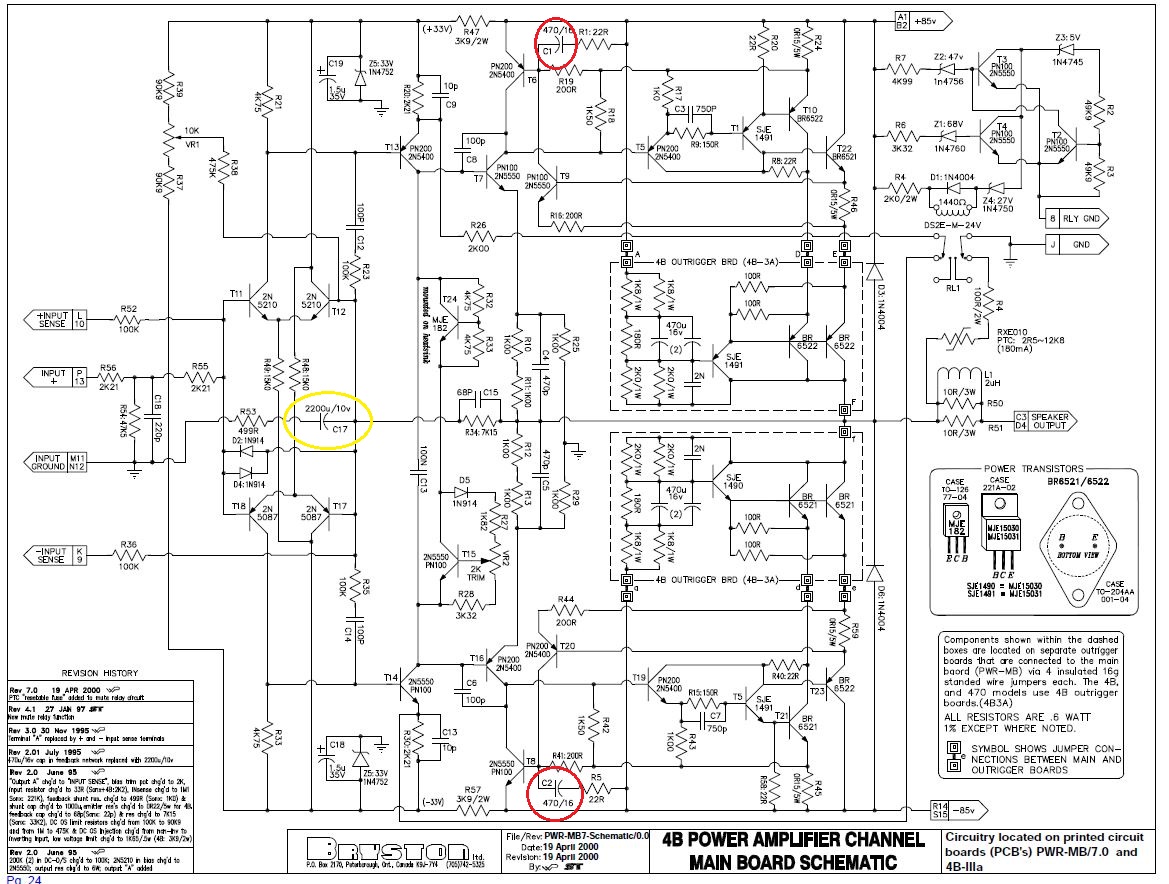

Just to make sure I understand correctly, are you referring to the 2200uF caps at the negative feedback to the power amp? Can you talk a little bit about why these caps are the likely problem and not some other electrolytics on the power supply board or the power amp board? Would be helpful to understand this and to get some intuition about where to look next time.If they appear fine then you will need to check to see if all of them are actually filtering by looking at the ripple voltage on the capacitors. If the big capacitors seem all right then a small capacitor involved in the compensation loop may have changed its value. I think that you likely have a parametric shift in some components that all installed in both channels and some small difference between the channels triggers one or the other to start oscillating.
I checked the large caps with an LCR meter in circuit, and they seem ok. All the smaller caps on both the main board and the power amp boards are out of spec, but this may be because I'm measuring in circuit.
I am referring to power supply capacitors. I doubt that a faulty 2200uf input capacitor would cause an oscillation but I could be surprised. If a power supply capacitor becomes open or loses value then the ac ripple will increase which will make the loop less stable because the loop has to compensate for this changing voltage. It would be best if you would scope your power supply rails to see if they look good. If you don't have a scope then an AC measurement could be useful. I would say that no more than a few volts of ac voltage should be on your power rails. If you are able to locate the main loop compensation capacitor then you could replace it or tack another one across it. You could also suspect a faulty capacitor in a current limit protection circuit if it has one. If you have a schematic then you should post it. It could eliminate a lot of guessing. There may be more than one compensating capacitor in the loop that could trigger an oscillation. Look for bad power supply voltages first and then for changed loop stabilizing components.
Thank you. I posted the schematic at the bottom of my original message. There is no protection circuit in these amps, just some fuses.

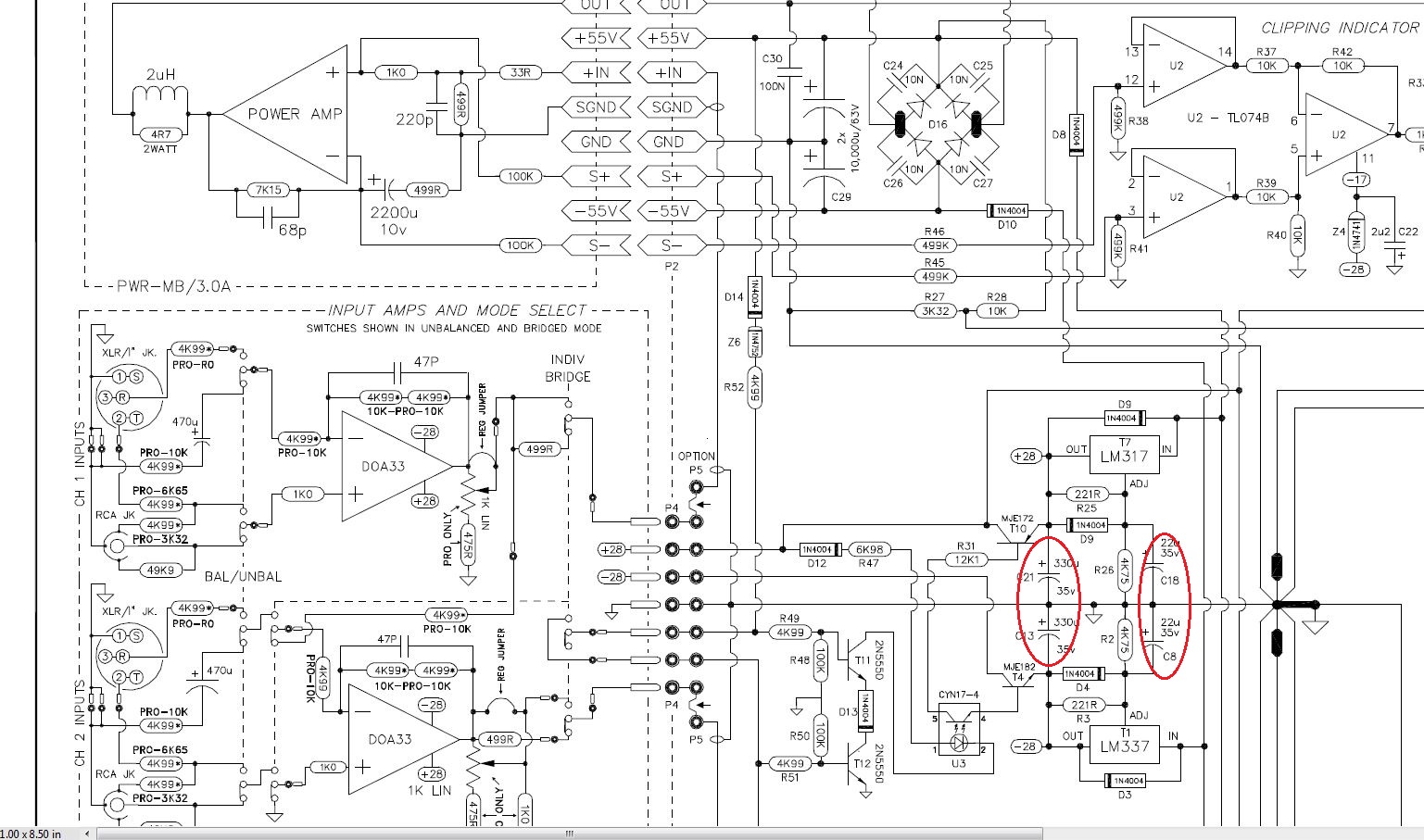

I desoldered some caps to check their value out of circuit. The ESR on most of the small ones is very high (5-15 Ohm), even though the capacitance on all but a few is still within spec. The input capacitor's ESR is under 0.5 Ohm and it is also within spec. I'm going to replace the putatively faulty caps next.
Here is an update on this repair. I replaced the capacitors circled in red on the main board and on the power boards for both channels. Has not solved the instability issue. After a few minutes, and sometimes sooner, the bias on the channels reliably soars into the stratosphere.
I checked the AC ripple, and it is minimal on both channels (around 50 mV, instantaneously rising to 1V when the fridge cycles on). I checked the caps circled in yellow on both power boards and they are within spec, both with respect to ESR and capacitance. I did not replace them. That's about it for electrolytic caps in this amp (with the exception of the big filter caps).

That amplifier is busy. I am not sure what some of it is doing but I have 2 ideas. I can see the 68pf compensation capacitor and I see a bias adjusting pot. You can turn your bias adjustment all the way down to see if lesser bias helps. Pots are mechanical and they could change value. Maybe the pot wiper has developed some contact resistance and now the bias is too high which would cause high heating. You will have to re-adjust it later if bias is not the problem unless you don't mind some crossover distortion. Or, maybe the circuit is too near instability and some aging component has changed value and is causing an unstable loop. If you put another capacitor like 1000pf across the 68pf then you can test to see if that forces the circuit to be stable. Since the circuit works for a short while then it is likely that temperature is a variable and that could point to a bias problem. Test those sensitivities next.
Following up to confirm that it was a faulty bias potentiometer. The lead connected to the wiper was developing infinite resistance relative to one of the other two leads. Anyone have an explanation for the same failure happening independently on both channels? Per the specs, the pots are rated for 1/2W.
