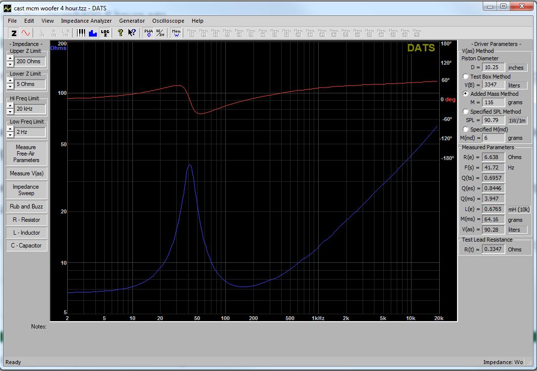

I just broke the woofer in for 4 hours at 20 Hz and have included the DATs screenshot.
Here are I think all the relevant parameters as measured by me,
F(s) = 41.72 Hz
Q(ts) = 0.6957
V(as) = 90.28 liters
SPL = 90.79 dB SPL 1W/1m
R(e) = 6.638 Ohms
Q(es) = 0.8446
Piston diameter = 260.4mm
SPL = 91.6 dB SPL 2.83 Vrms
C(ms) = 0.227 mm/N
L(e) = 0.6765 mH at 10kHz
Q(ms) = 3.947
BL = 11.5
n(0) = 0.7402%
M(ms) = 64.16 grams
Xmax = 7 mm
SD = 552 cm^2

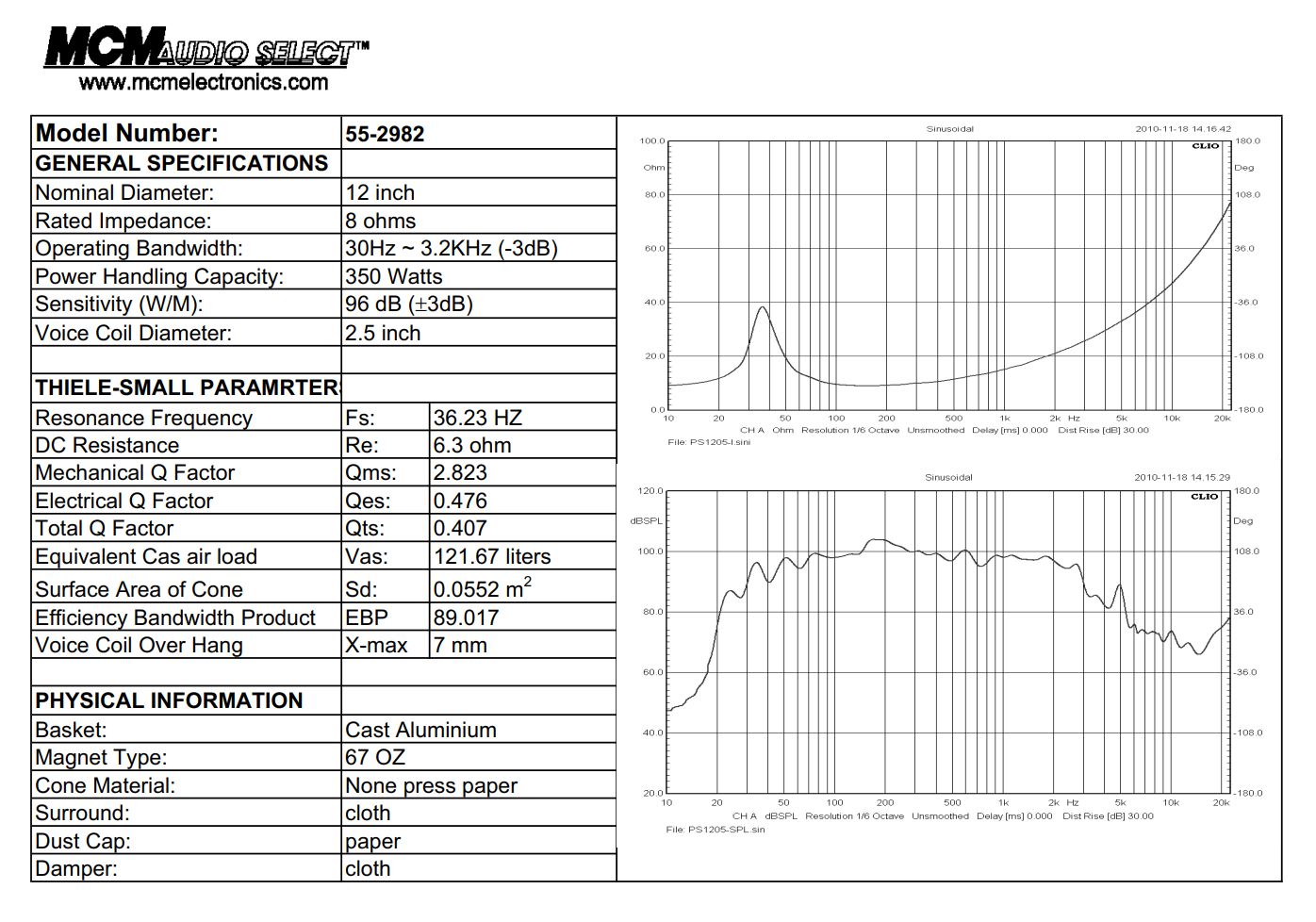

Sadly, the majority of woofers MCM sells do not make spec.
Hence why I posted the spec's I measured...
The best way I know to "model" the output of dipole subs is to build the sub, measure the nearfield frequency response in the plane of the front and rear openings, and then use those as part of a model of the far field response. I do this all the time, but you would need my ACD spreadsheets to do it. For frequencies below a couple hundred Hertz, this is a very accurate way to determine the far field response for a dipole sub.
