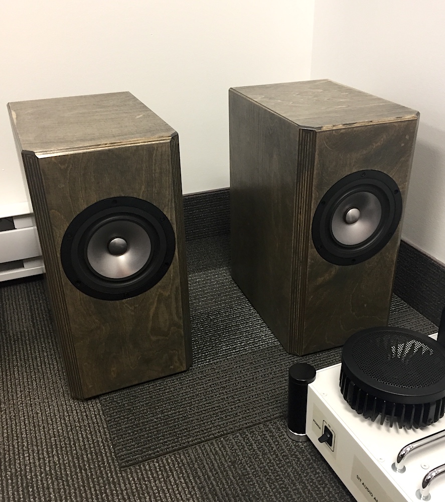

I have built the 17lite box myself and found that it works really well indeed. I too was worried about the size of the box so I made it narrower whilst keeping to the 17l design total volume. It's an oft used visible trick. Nevertheless, if I was that bothered about the size I wouldn't hesitate to cut the box volume down to 13 lites and still with an expectation of acceptable results. I have the metal cone driver but I may eventually try the paper version, which only requires a change to the vent length (i.e. easy for me because of how I designed the vent). I placed the vent on the rear of the box, also for aesthetic reasons (a position approved by Scott in one of his posts somewhere). The joints are mitred and later the external edges bevelled as I like the appearance. Finished in ‘grey’ Danish Oil which actually has a green tinge so I call these speakers “Nori”.

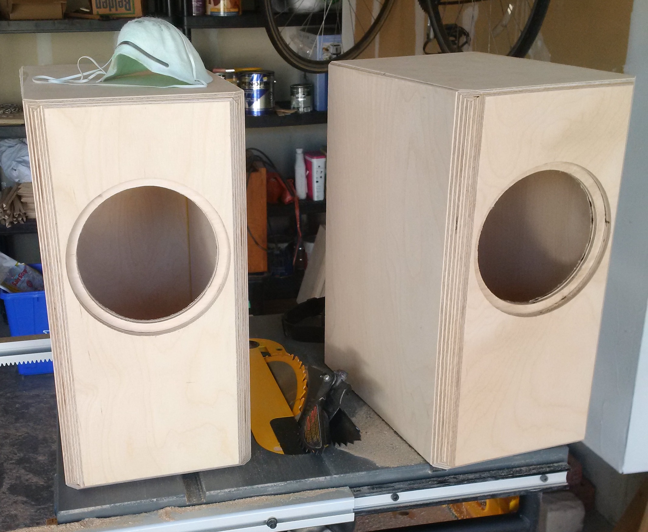

Hi Guys, the speakers are built, have about 40 hours on them and sound very nice. They have good detail, harmonic richness, tonality, imaging and dynamic range. The bass seems a bit light, but since I'm limiting them to 80 db max at this point it is hard to judge that aspect. My issue is, as good as they are, I don't know if they could sound even better. At this point the tops are simply taped (and weighted) in place so some changes can easily be made.
Specifically, the actual build has 15 net liters, construction is of 3/4 inch baltic birch, all interior surfaces lined with 3/8 inch jute automotive headliner and the port is 2 inches in diameter by 4.5 inches long, for a tuning frequency of 51Hz.
So, what, if any, noticably audible changes might I hear if I changed the port length to 6.25 inches to get to Scott's suggested 45Hz tuning frequency? Also, would adding another 3/8 inch layer of jute to some or all of the interior surfaces be worthwhile?
I strongly suspect that any audible changes from doing either of these would be minimal and, again, I am very pleased with them as they are now, but before I glue the tops on I am hoping to get input from folks who have actual experience with similar designs.

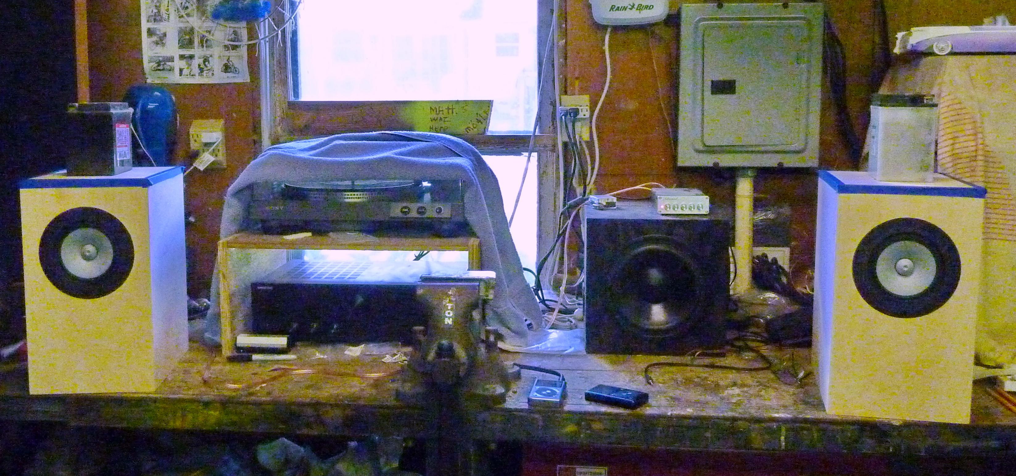

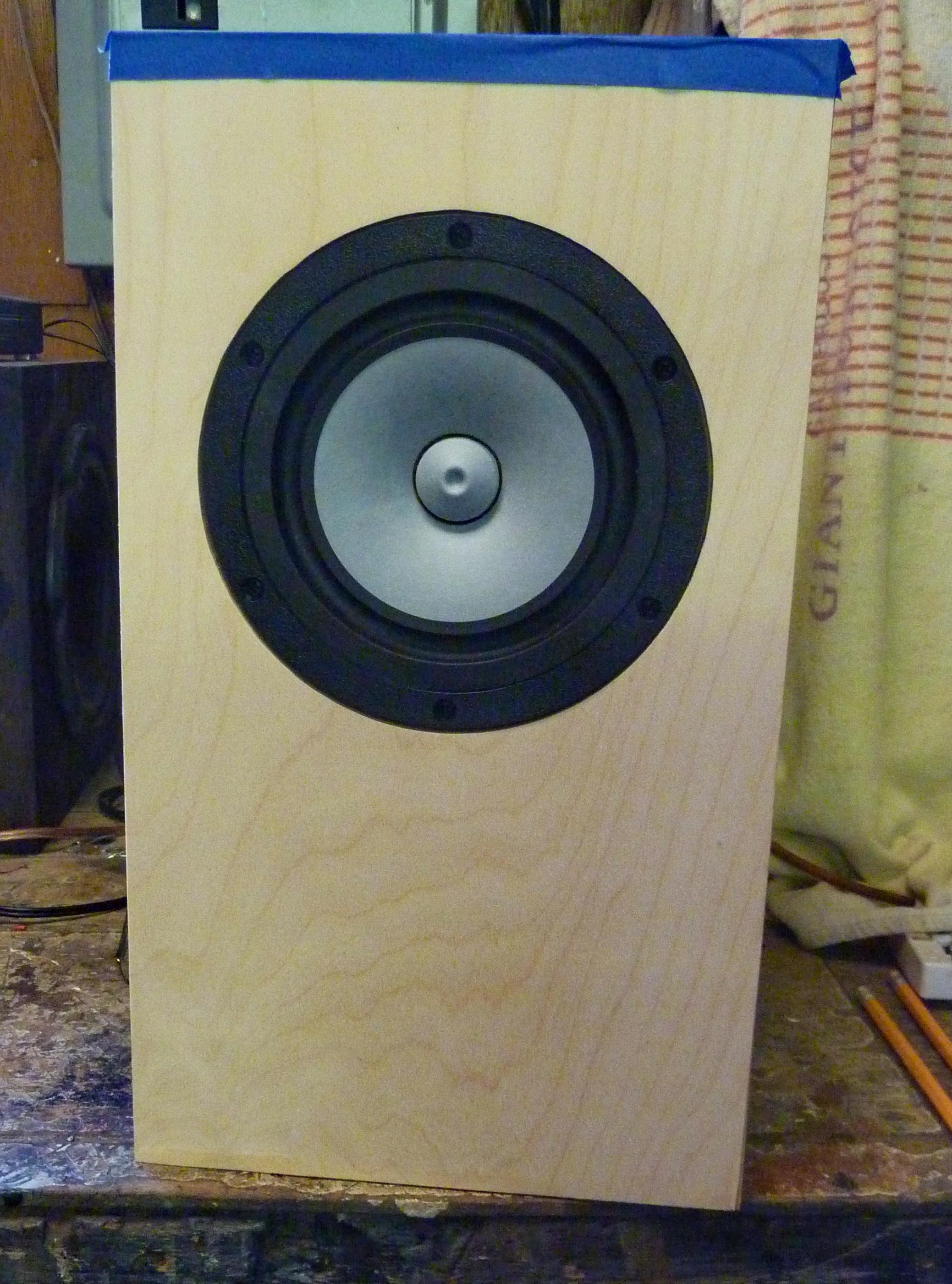

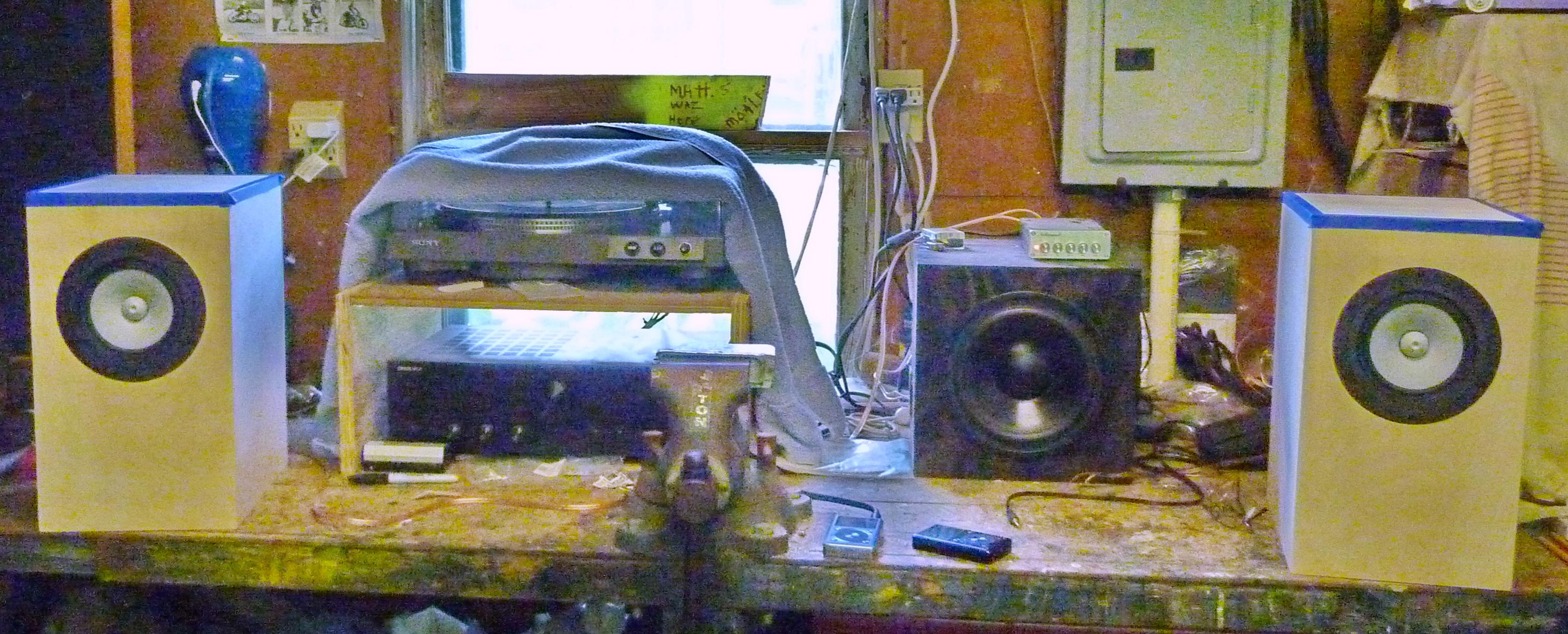

Here is proof. The shot with the motorcycle batteries on top is how I've been listening. I took them off for the shot which captures the magnificient feng shui of my workshop more fully. They are all mitered and the joints came out reasonably clean, so I will probably just finish them in clear shellac after I glue the tops on. I'm still hoping to get input regarding fine tuning before the final gluing and finishing though.
FWIW, Hornresp, a known accurate program, calculates a 52.4 Hz Fb for 15 L/2" dia. x 4.5" L vent, making it ever so slightly under-damped whereas 45 Hz = 6.3" L/16 cm with a slightly over-damped response, ~1 Hz lower F10, i.e. unless room interaction significantly modifies this ~50-200 Hz BW, doubtful anyone would notice the difference and with the higher tuning you can always critically damp* the vent in room, which is a better overall choice since you get the optimum in room transient response with a shorter vent, i.e. a variation of Dave's resistive vents without the extra woodworking.
