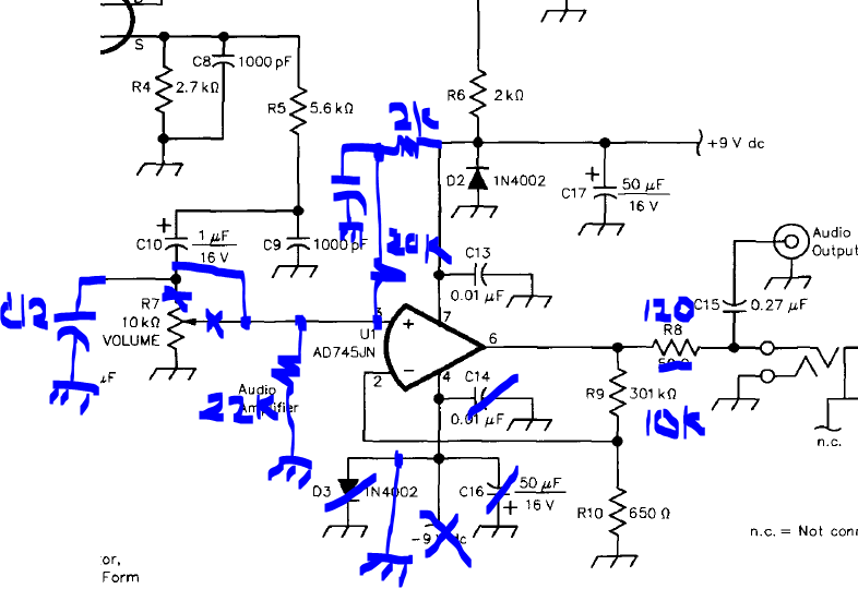

Well I do not have a schematic on hand but here is one of the radios I studied. It is an older design but basically it explains the principles involved.
http://www.arrl.org/files/file/Technology/tis/info/pdf/9811qex026.pdf

see attached fixed AF buffer
bias is set at 4.5 V with about 11K input replacing 10K pot. The input bias supply is isolated and filtered by the 2K RC network. The output gain is lowered here because the pwr amp makes up the additional gain. Volume control is moved to input of the pwr amp. You might need to change the fixed gain once you get up and running and see where the volume control likes to be. .
Probably the next big improvement could be made by using a steeper audio CLC filter instead of the R5*C.
here is a good read on audio filters to replace between your front end and the fixed AF amp. His design is not a simple one like yours ( note the all important LO Local Oscillator is glossed over) http://www.arrl.org/files/file/Technology/tis/info/pdf/9208019.pdf
edit> I forgot the series DC block capacitor in series with R10 on the attached marked up AF buffer above.
