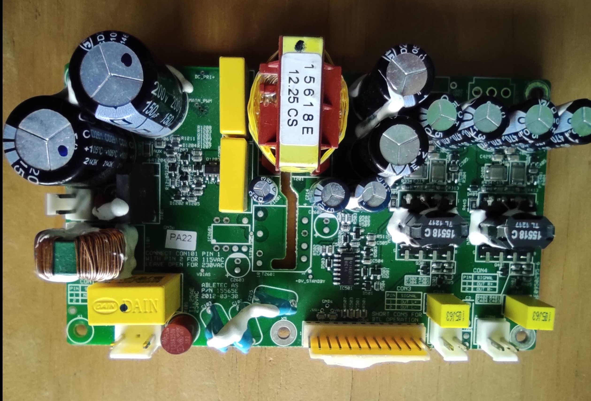

I have a couple of Abletec Anaview ALC 0100-2300 class D amps. These are 50wpc@4ohm and can work in BTL for 100w@8ohm.
I am feeding this amps with an ADAU 1401 DSP with an output sensitivity of 0,9Vrms.
My woofer and tweeter are both 8ohm, so when working in stereo mode I get around 25wpc or something like that, which considering the poorish sensitivity of my components, they don't get too loud... but it's OK.
The thing is that I want to try the BTL mode and get 100w@8ohm.

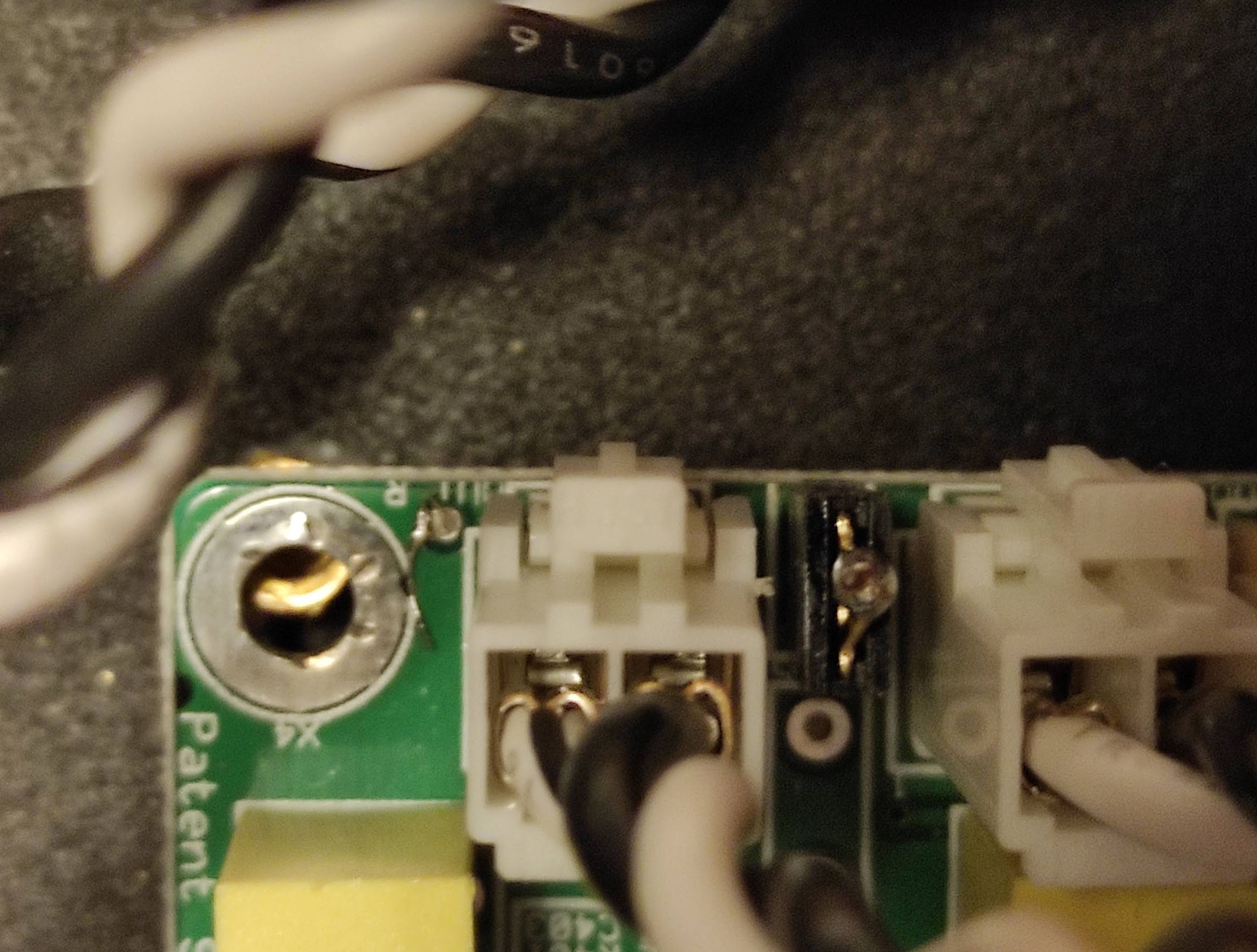

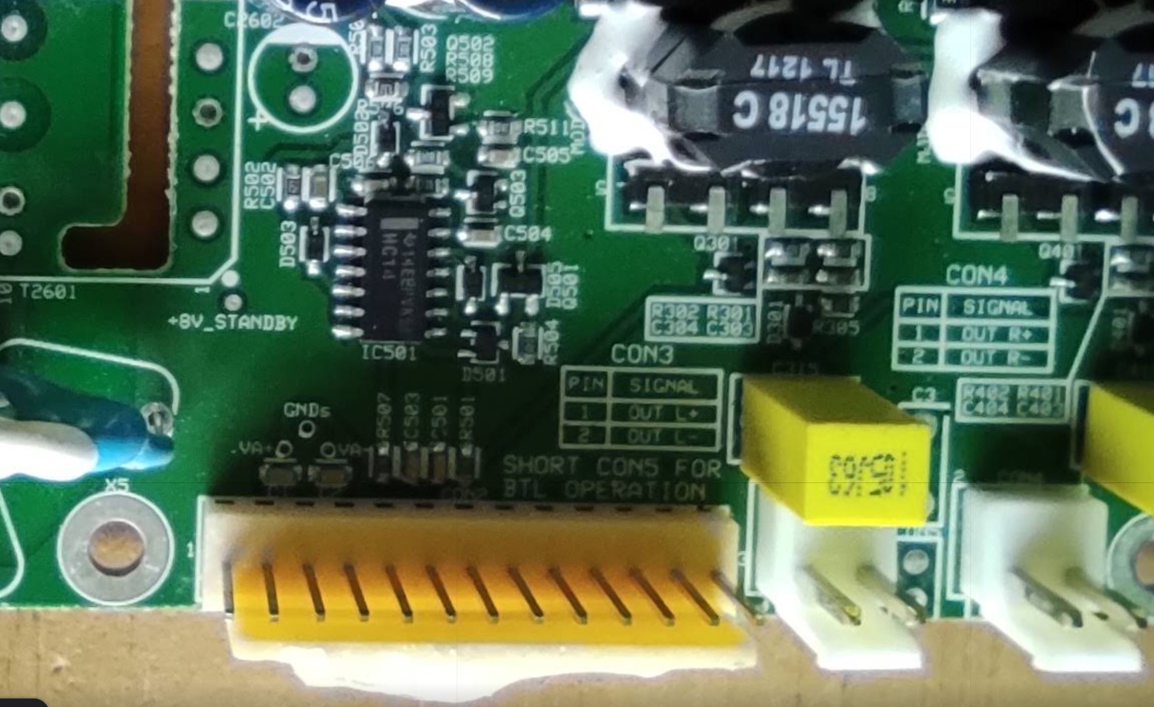

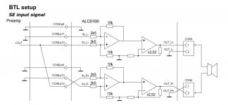

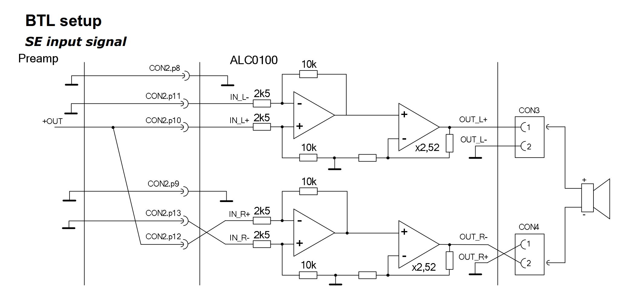

According to the amplifier's spec sheet, it can work in BTL mode with single ended or balanced input signal. I am using a single ended signal. I wired it just like the diagram (pin 12 and 10 are input + and 8, 9, 11, 13 are ground), and shorted the "CONN5" like the PCB says.
The amp sounds good in BTL mode but it's not louder than the stereo mode, which is weird as it is almost 4 times as powerful!!
I am making something wrong? I am understanding something wrong?

AS an Update I finally made it work... IDK if it is 100Watts but it's certainly more "powerful" than in stereo mode.
It looks like I was misreading the diagram, and the BTL speaker outputs where +L en -R, and I was using +L and +R(for-), the wird thing is tat it also worked that way, alas not as "powerful".
