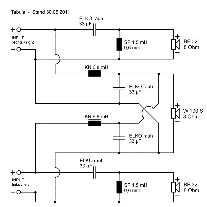

I've got one stereo amp, a pair of 2-way speakers with crossovers inside and a passive sub with a low pass filter at 120hz. i want to wire the sub in parallel with the speakers.
can i add a capacitor in series with each of the speakers to make a high pass filter so that they cross over with the sub nicely?

Why not get a cheap active crossover - like miniDSP. This is one of those cases where bi-amping is very justified.
Look here for this example of the Visaton Tabula.
Visaton - Lautsprecher und Zubehör, Loudspeakers and Accessories
12 db Crossover Table

thanks for the crossover diagram, inductor. it looks ideal. i assume it will sum each channel to the subwoofer while also providing a low pass filter?
will it be ok to add the high pass filters in front of the 2-way crossovers that i've already got?
also would you or anyone be willing to help me with the maths in order to determine the values of the components?
Adding a passive crossover to high-pass a woofer at a low frequency is not simple. It can make things worse, so is better when designed from measurements.
Fortunately it is not always the best thing to do in this situation. It can be better to leave the mains running full range when adding the subs. Subs also require careful placement into your room.
If your main speakers and each sub are rated at 8 ohms and your amp rated to handle 4 ohms (all of which are common) then you should be OK. Although it may be possible to go beyond such limits with care, at the least you risk blowing fuses which should indicate that this is not advisable.
