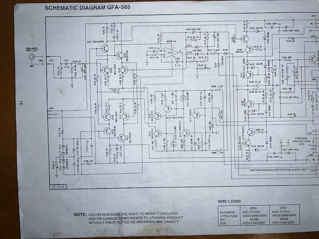

Check your voltages at the bases of the input transistors, the MPSA13's and MSPSA63's, these should be at less than 5mV, and the voltage here is directly reflected in the output. Also, there are two 1K resistors from the rails to the cascode transistors, and the current through each half of the input stage can be calculated from the drop across this resistor. Similarly, in the VAS stage, there are two 49R9 resistors that you can calculate current for each half of the VAS stage. They should be pretty close.
I have a ton of troubleshooting tips, DC operating points etc on my EBFA-565 Annotated Schematic here. Circuit is the same as the GFA-585 with different part numbers.

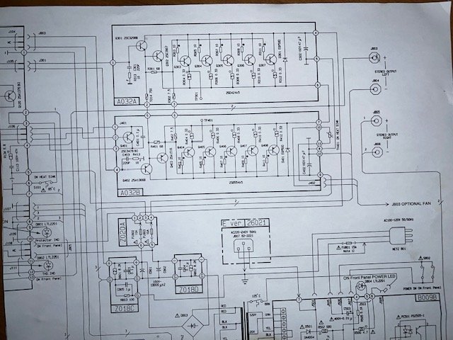

I also wanted to share my experience using AI (ChatGPT) to help me troubleshoot the amp. I am amazed at how far AI has come. First, in the prompt I listed the amp model and make along with a detailed summary of the symptoms. The response was surprisingly good, with some suggestions on places to look and a recommended plan of attack. Then I took a picture of the schematic and uploaded it. ChatGPT could not only read the schematic but could also interpret the functions of the various circuits! Wow! Then I took a picture of the circuit description from the service manual and uploaded it. ChapGPT further refined its suggestions and troubleshooting plan based on this information! While not perfect, the recommendations provided were about 80-90% correct, but more importantly, it provided explanations every step of the way. Truly amazing!
