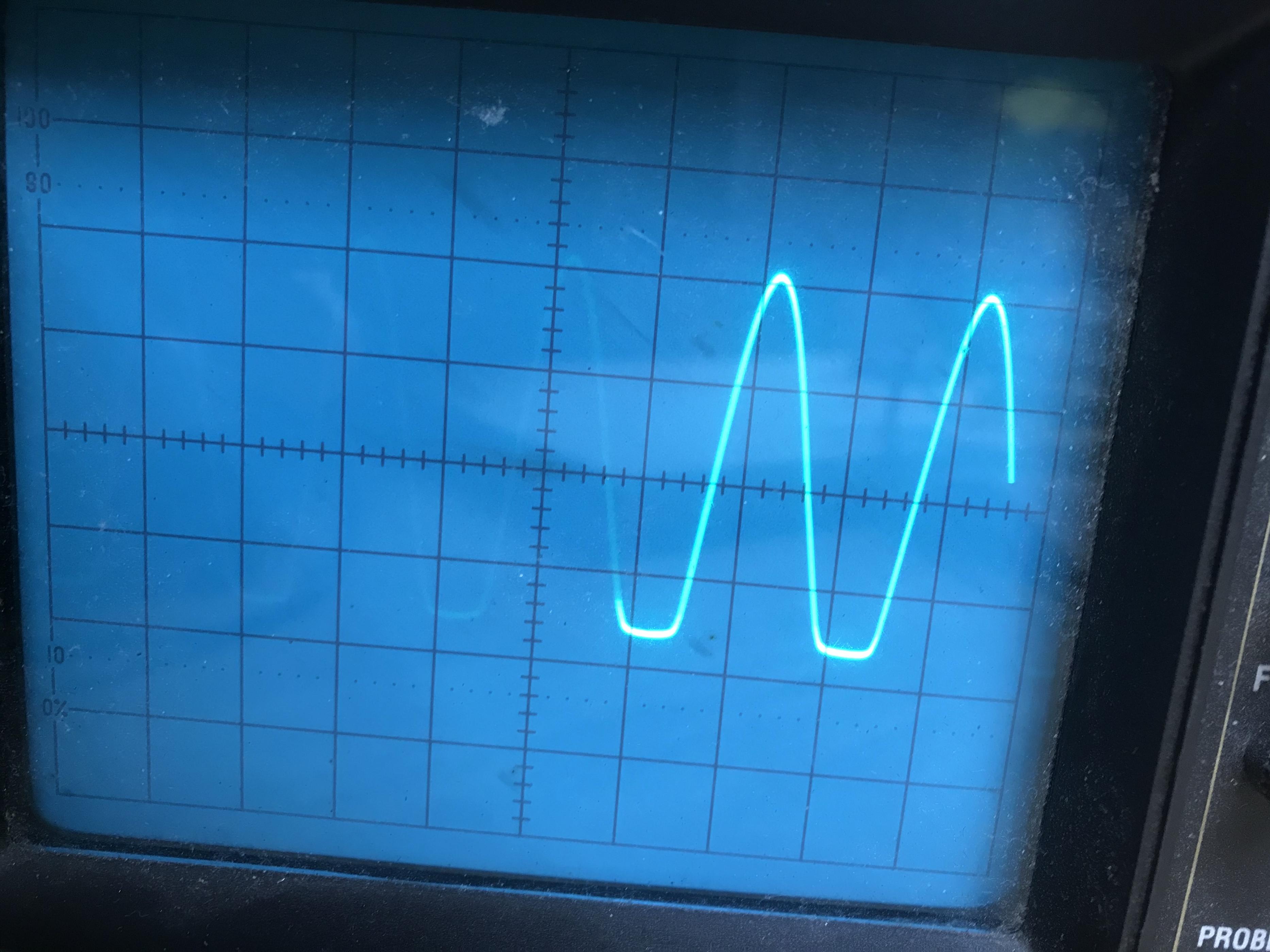

Long story short, after re-capping the receiver, I noticed some distortion in the right channel, and I lost control to adjust the idle current. The left channel amplifier functions perfectly fine. I checked all the voltages compared to the service manual and without a load, everything looked OK, which had me stumped for a few days. Initially, I thought I lost the amplifier bias completely and it was causing crossover distortion. After finally checking things out with the amplifier under load, the problems began to show themselves. Looking at a sin wave under a scope, without a load the amplifier works fine, however, under load, it became clear that the negative half of the wave was clipping.

I've attached the voltages I've measured, a picture of the clipping I can see using my scope, and I'll include the link to the other forum thread if you'd like to read the story from the beginning.

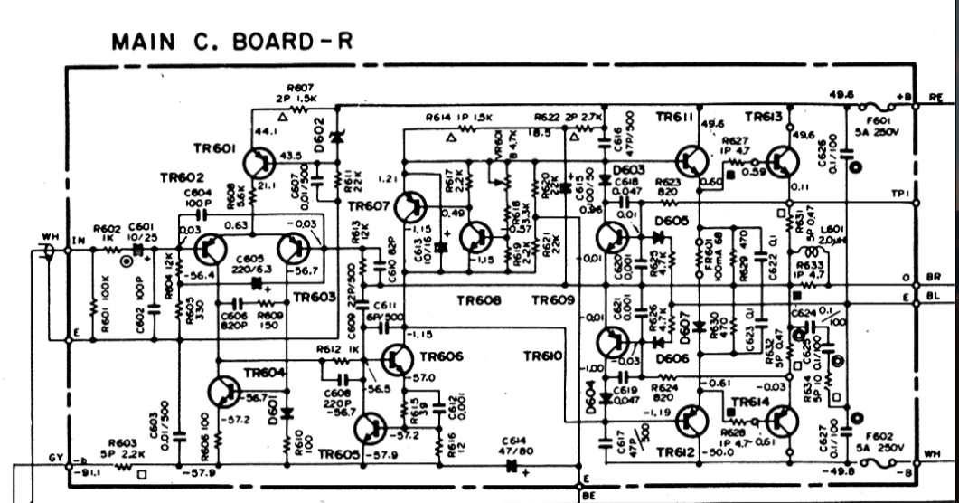

Since there seem to be indications of the input stage being badly out of balance, I would verify that its current source is operating correctly (check R607, 608, 611, voltage drop over D602), as well as check current mirror components (R606, 610, D601, TR604).
If you cannot find any shorted or open transistors in the output stage, I would check R628 and R632 in particular, as well as all solder joints involved.

You said in your post in AK that "when you turn up the volume ---the negative voltage rail drops " .
If you don't have overheating problems due to current overload --as measured --ON the -90 volt rail then its a power supply problem .
If the drop was internal of the voltage rail then that is different but the actual rail is not holding its voltage.

You mention -90V, but in the schematic I see +-50 for the output stage, and another -58 for the front end? Are both these negative voltages OK? (assuming correct polarity on your scope pic)
I've gone over the table now - voltages at TR613/614 seem extremely dodgy to me, to the point where I suspect one or both may be open (perhaps some bad joints?). I mean, TR614 is 9.2 V E-B, that's not normal, and TR613 seems to be basically turned off. Please verify the pn junctions via diode test on both while powered off, as well as all their connections. R632 as well.
Also, bias seems to be turned up too high... you have over 2.6 V between the emitters of TR607 and TR608, and it should be about 2.36 V. I'd rather have this set too low than too high for now. The pot has hopefully been cleaned to avoid any glitches; this type of bias adjustment is not failsafe.
