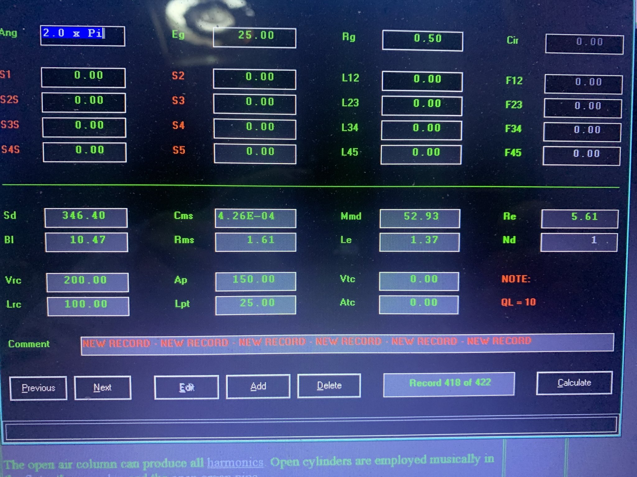

What’s the advantage of this shape vs this?
Sound-wise it's all about the 'quality' of the damping, though 'critically' damping the vent makes it near enough a 'six of one, half dozen of another' scenario, leaving only the (usually) allowing a larger/greater acoustically eff. vent and more optimal driver/floor location options.

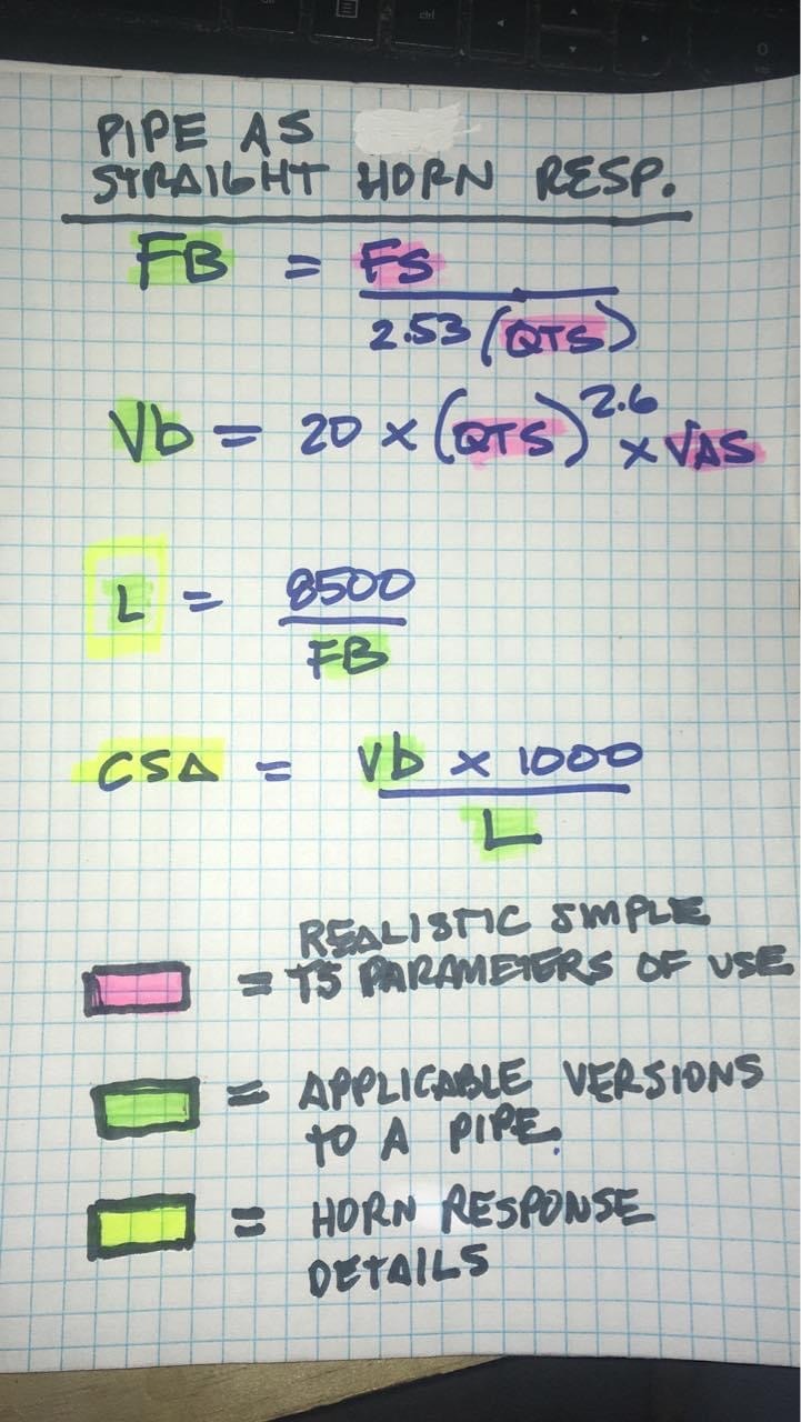

What ‘good’ is offsetting the port in a TL? It seems it just puts the vent at a lesser vmax /exciteation for the resonances…. But it also creates another resonator/stub that messes everything up further?
thanks for always entertaining my silly questions so I don’t waste as much wood 😝

Well, the pioneers learned that 'driver in vent' was the ideal for their need for maximizing acoustic efficiency and later even put them close to the driver in high aspect ratio cabs to get some BSC and me n' others have moved it at various offsets to better blend in room relative to the listening position (LP), which in my case almost always meant tuning each speaker individually in room, so best not to design in a 'vacuum' for max in room performance. 😉
