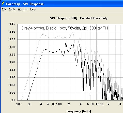

btw, you need to look for high fs drivers, with large xmax for a TH, which limits the driver choices considerably. For instance, a 51hz fs delta 12pro-a models well, but still exceeds xmax at 100watts, where it's only giving 119db flat from 40 on up in a 220liter TH cabinet.
If you want to go TH, the 3015lf is your best bet. Here's what they'll do in a single and 4 box combo at 56volts. (without exceeding xmax above 35hz)

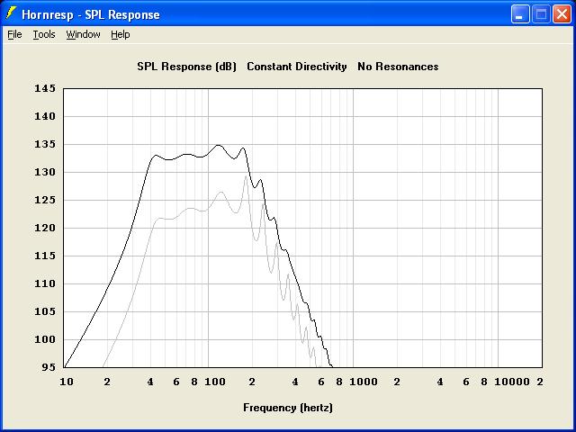

Compare that to my 'little' 55-2421 cabinet, 1 and 4 boxes, and you'll see why I kinda like the mcm's in FLH, and the 3015lf in TH.

So how big of a box would it be for a TH with 3015lf?

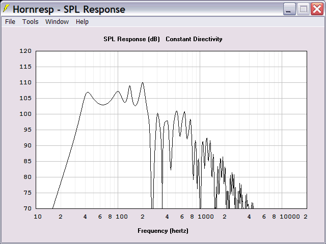

Hmm, just 'running the numbers' I got these dual alignments, but between being fairly large and with a limited Xmax probably not worth the wood/effort for a prosound app though:
~18 Hz/753 L:
~28 Hz/552 L:

The dual version I came up with when he asked hits 115 DB MAX at 23 Hz.
Not to bad for a HT sound system as you would be getting 6-10 DB more but in a PA environment you aren't. So it is pretty useless.

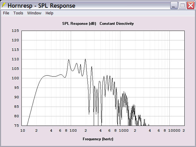

"sorry, bp102 doesn't model well AT ALL as a TH.......If anyone else knows of a good bp102 cabinet, let me know."
Well, I responded to the above and believe I succeeded where he claimed to have failed if the published specs are reasonably accurate, though I did concede it's probably not suitable for a prosound app. Just because it's not doesn't mean it's de facto useless for ANY TH app since the 18 Hz one stuffed into a typical room will in theory meet DD/DTS/THX reference of 115 dB/20 Hz/viewing position with as little as 10 W.
That said, in looking up its Xmax/Xlim, I found two radically different sets of specs from Eminence, so without measured specs, just ignore them.

I should learn to be more accurate in my statements GM: Yes, your TH sims are quite valid. I guess I should have said that I can't get reasonably flat response from 40-100hz, at around 100db@1w/1m (single driver) in a 'reasonably' sized pa cabinet. (The OP was looking for small, small, small...) and be able to use the rated input power of the driver before hitting xmax.
That's kinda my works/doesn't work rule of thumb when I try sims for pa use, which explains also why I've never successfully found a good PA TH option for a 55-2421. (I've spent HOURS on that one....)
Thanks for the sims though, it would have never occurred to me, to try a bp102 in a HT TH. I may have to do some more looking at that driver, I took them out of my T39's before roasting dogs...
