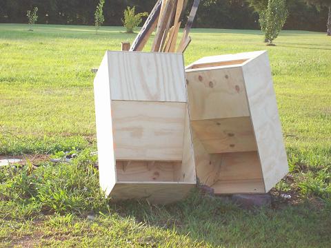

I would like to make a tapped horn like the ones pictured below, but with a 8" MCM 55-2421. Could someone help me adjust the size in inches for this design?

Looks more like a TH-Mini, not the TH115.
Look at Speakerplans.com for more info.
It is this design in the pic below. I hope someone can help me adjust this design and resize it for the 8" MCM driver. I did do a search but the link posted for a design for the MCM driver didn't work. I don't understand Hornresp.

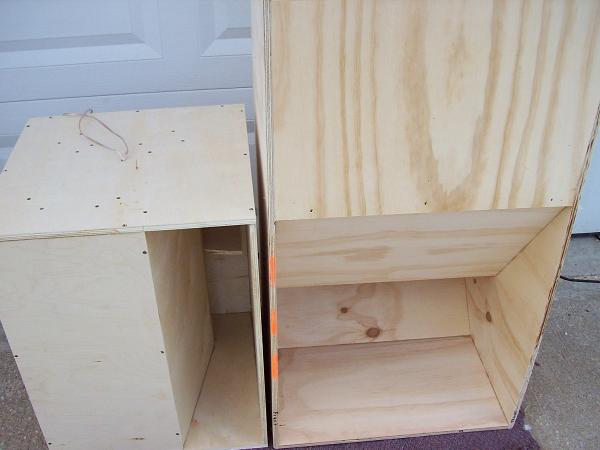

Well here's a couple pics that you might find interesting. One of them, is the T39s, ready for hot dog duty... (roasting) I just don't like -13db@ 40hz, vs 100hz.... Just like bgavin, I like flat to 40. I just don't want to have to eq my subs down to 95db efficiency across the board, to get it. (BFM faithful will tell you, that gives you more 'headroom' when you eq down the upper freq... Well, I've never had a need for more 100hz headroom on a sub...) I have ZERO bass eq on my little (21x23x33) mcm FLH subs, and with just 2 of them, they are flat to 40.

If you want a BFM design, build 24" wide dual T18's. ounce for ounce, cubic inch per cubic inch, it's the best sub BFM has. I actually don't think Bill has a good appreciation of how good that sub really is, especially with an inductor added. The second picture gives you a good reference on how much bigger T39's are, vs the dual T18.
